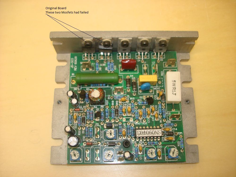

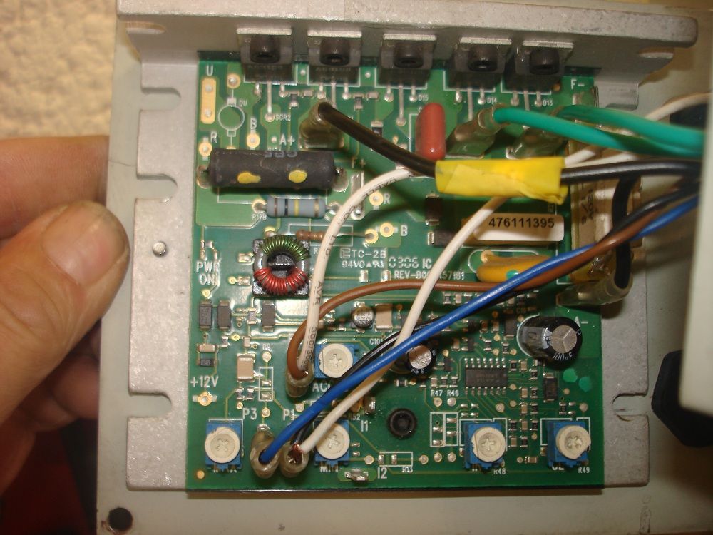

Griff06/09/2012 10:05:02
5 forum posts
2 photos
Hi,
I have checked the Current Limit pot and ii is set at the fully clockwise position as was the original.
The current going to the motor which is labelled 850w 220v is as follows;
Lowest speed setting - 11v dc
Highest speed setting - 111v dc
The pictures below are of the currently installed board and the original - the arrows indicate the two failed Mosfets on the original board
Les Jones 106/09/2012 17:28:45
2292 forum posts
159 photos
Hi Richard,
I think the white ceramic resistor (Marked 5WR1J) on the right hand side of the original board is the current sense resistor. (Value 0.1 ohm) The new board looks to be different design to the original so the current sense resistor could need to be a different value to give the same current limit value. The value of voltage across this resistor which causes the controller to start shutting down could be different. If you monitor the motor current I would expect it to get to about 4 amps at the point when the controller limits the current.
Les.

Griff13/09/2012 20:43:28
5 forum posts
2 photos
Hi again,
The high power resistors are reading the same on both boards and I am only getting around 2.5amps current draw.
What I can't understand is why the RCD only trips when the machine is under load. It seems to me like the problems are related but I am at a loss as to why.
