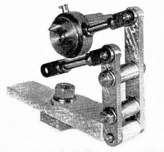

Hi I have posted a picture in the album of a gear cutter relieving tool I started to make about 40 years ago, just found it and would like to finish it but can't remember which model engineer I got it from. or author Do any members remember the article could have been from about 1950 upward. also thanks to the members that answer my photo query.

Using the **ME_Indexes** application with criteria “reliev” I find the following articles plus some more having nothing to do with gear cutters.

Year: 1913 Date: 22-May Volume: 28 Issue: 630
Page: 495 Title: Relieving Small Gear Cutters Author: W.G.G.
Year: 1942 Date: 27-Aug Volume: 87 Issue: 2155
Page: 208 Title: Relieving the Teeth of Gear Cutters Author: T.P.S.
Year: 1943 Date: 17-Jun Volume: 88 Issue: 2197
Page: 563 Title: Relieving Milling Cutters Author: R.B.F.
Year: 1954 Date: 29-Apr Volume: 110 Issue: 2762
Page: 480 Title: Relieving Milling Cutters (Reader's letters) Author: F.G. Bettles
Year: 1970 Date: 21-Aug Volume: 136 Issue: 3399
Page: 815 Title: Simple form relieved Milling Cutters Author: D.J. Unwin
Edited By dcosta on 20/07/2012 01:14:30
dcosta20/07/2012 01:16:44
496 forum posts
207 photos
Hello Bernie.
Hope this helps.
Best regards
Dias Costa
Note: forced to divide in more than one post
Year: 1972 Date: 6-Oct Volume: 138 Issue: 3450
Page: 977 Title: Relieving Milling Cutter Teeth Author: A.Mackintosh
Year: 1981 Date: 7-Aug Volume: 147 Issue: 3662
Page: 952 Title: Form-Relieved Gear Cutters Author: I.W. Payne
Year: 1987 Date: 6-Feb Volume: 158 Issue: 3794
Page: 138 Title: The Eureka. A continuous form relieving tool for gear cutters Author: Prof. D.H.Chaddock and Ivan Law
Year: 1987 Date: 6-Mar Volume: 158 Issue: 3796
Page: 280 Title: The Eureka. A continuous form relieving tool for gear cutters Author: Prof. D.H.Chaddock and Ivan Law
Year: 1987 Date: 3-Jul Volume: 159 Issue: 3804
Page: 11 Title: The Eureka. A continuous form relieving tool for gear cutters Author: Prof. D.H.Chaddock and Ivan Law

Hi Bernard,
Is it the 'Euereka'? if so I have a set of drawings which I would be prepared to share, just send a private message,
Best regards
Terry
P.S. Just noticed your picture and it's not the Eureka, so ignore this post. Sorry,

Hi Bernard,
If I'm not mistaken this looks a lot like the attachment described by 'Duplex' in an article in ME Vol 100, Issue 2508, part of his series on "Gear Cutting in the Lathe".

Hello Vijay,
Thanks for your efforts finding the releiving tool article, I am thrilled to think I can now finish it after all these years. I gave my Model Engineer Mags to the local club for their libary some dating back to the 1800 so I have to wait for my friend to come home on Monday to get the arrticles, he has all the back numbers. I am still active in making things Iam 87 this year finished a cnc router last year so I could make up some woodenclocks, now I have the hankering to build a metal one hence the renewed intered in the releiving tool, sorry for delay in getting back to you . I am away a few days aweek this time of the year.. Thanks agian. I will drop you a line after I have read up the articles. All the best
