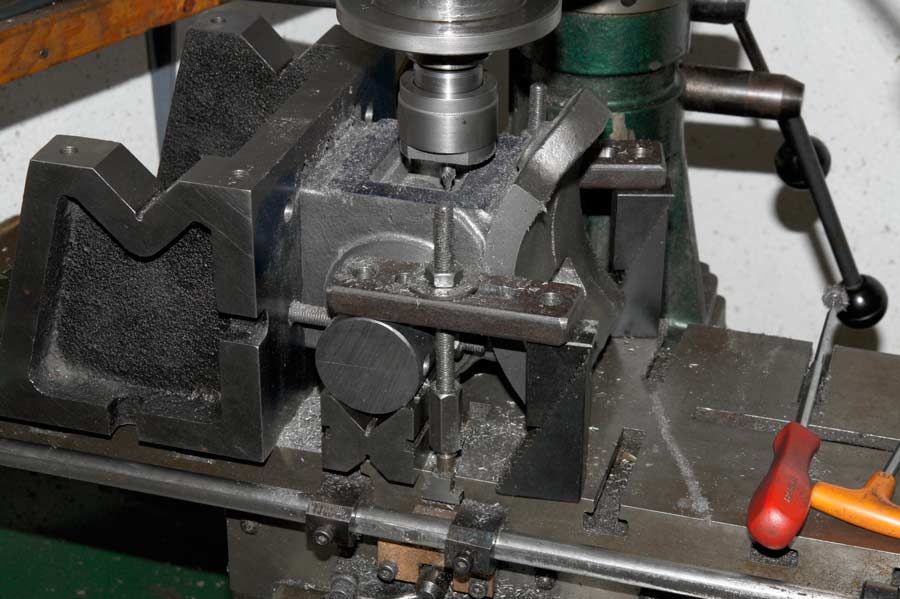

This is the same block being rotary milled for insulation - the table is from Ivan Law (MES) - home built, as is the DW mill of course..

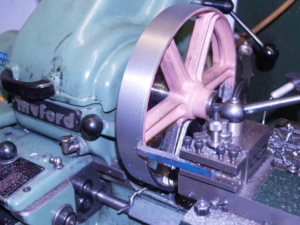

Turning the front wheels in the Myford, before I got the Chinaman. They just fit for diameter - but the overhang is such that you cannot turn it round to face the other side for the hub caps - though you could do it in a mill. Hadn't got an indexable TCT tipped tool with enough length either. (Stil don't)
