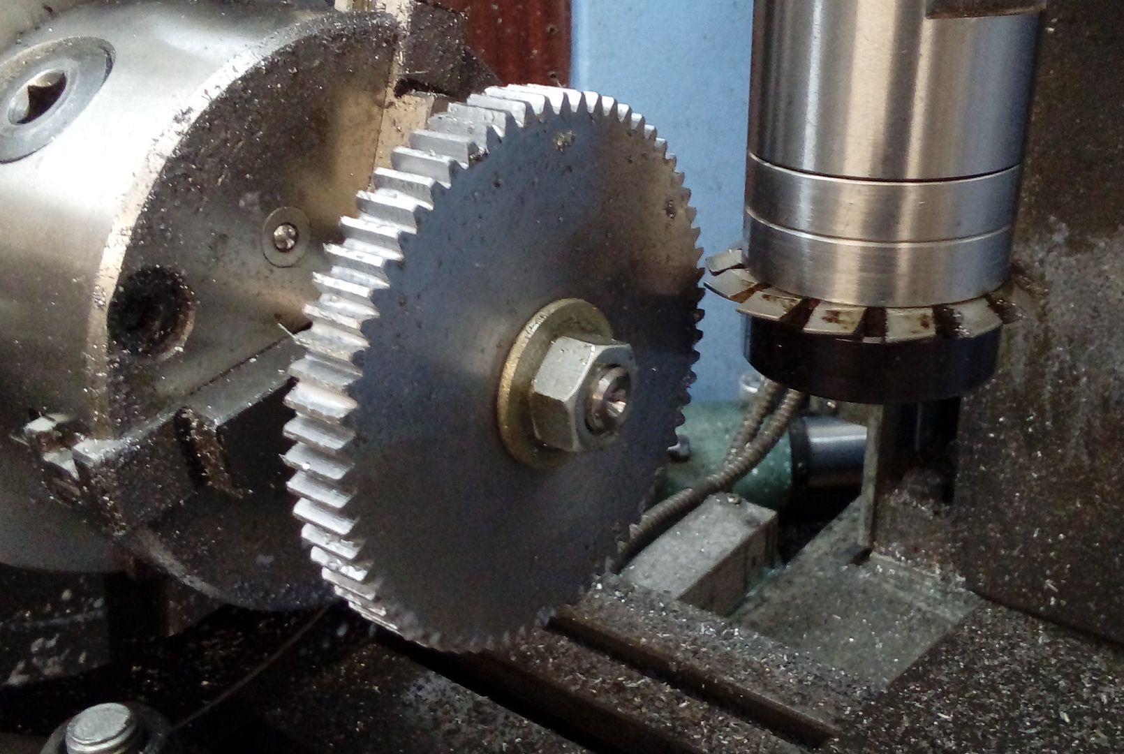

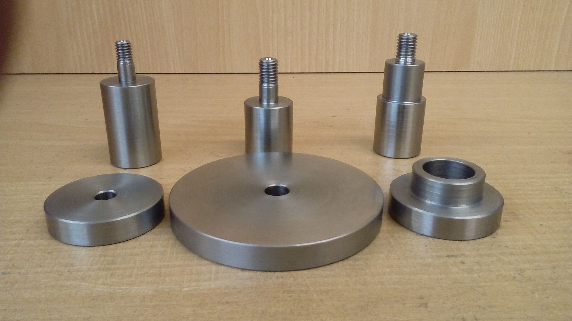

But if you need to turn the OD then I would have gone for a longer spigot turned to fit the hole cut onto a larger diameter piece of material. Thread the end of the spigot for a nut and drill the end of the spigot with a small ctr drill for tailstock support. The shoulder created by using larger stock provides enough friction to stop the job slipping so no need for loctite etc
This sort of thing
Edited By JasonB on 20/07/2023 19:00:51

In which case try what you have using light cuts with sharp HSS or **GT inserts or change to the arbor shape I showed.
If there is/was spare material on the length then I would have opted for soft jaws and done the OD, hole and one face all in one setting. Then reverse to face to length. You probably don't have soft jaws but they are worth having.
