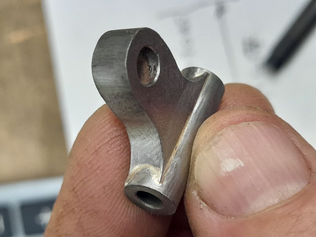

I am trying to make the Spring Link below, Can anyone tell me if this is suitable to be fabricated rather than filed from solid, I would like to turn the body for the pin from 5/16 and drill 5/32 for the pin hole and then mill a 1/8 slot into the round body and silver solder the tab into this after first forming the shape of the tab and drilling. I do have a very good jewellers oxy/Acetylene torch that fits my bottles and has a needle point flame. Is soldering strong enough for this component?

I suspect it would be easier to make it from solid. Properly silver-soldered it may well be strong enough but not a very easy fabrication. Either way I would form the radius afterwards, using filing-buttons.
It might be feasible to fabricate it as a "stick", sliced afterwards then drilled, reamed and radiused. The designer does specify reaming the holes, presumably for a good reason, but this should be done after any hot work.
If from solid, can you mill the sides of the body round, rather like the end of a connecting-rod? If so I would be inclined to form each one on the end of a length of bar held in the rotary-table chuck, drill reaming diameter to about 5/8" or so depth while the body is still on centre; mill the two tab flanks, then cut it off the stock, drill the second hole and ream both, finally file the tab to shape and face the cut end.
Do that final shaping last so you've still a reasonable amount of steel to hold and measure from, for the tab drilling and reaming.

Hi Roy, you could mill a keyway about 1/16" deep at the most, and 1/8" wide into a piece of round, and then silver solder a piece of flat into it. But it might be a bit fiddly to get the piece of flat in line with the centre of the piece of round and holding it there while silver soldering, but I think it could be done.

Many thanks for the replies, the ones that have alrady been made by a previous builder are too short between the hole in the tab and the hole in the shaft and were not pleasing to the eye, they were also too short from the base to the top of the tab, I made some buttons to re profile the round shaft and got them to size and only then realised the other errors, would this be better if I just turned the shaft and soldered the tabs in unprofiled as a square and over length? that said it may be easier to just cut pieces from bar and do all the drilling and reaming whilst it is still a rectangle, I think the problem is that the previous builder made the shapes first and then decided to drill and got that part wrong.

Whether you go for solid or soldered, they will be easier to handle as a strip of 6 plus sawing allowance plus a spare or two.
I would go for solid.  Set raw stock up in rotary table (spindle horizontal) two endmill passes to get the flat feature, then several passes with table rotated to form the round feature.

One way to consider for making those links, as a stick, is to mount the stock between chuck on a dividing-head or rotary-table and its tailstock, and mill along the length with a small end-mill. Cut the lug part first, as if it is a spline. It will leave little facets on the round part, but these can be blended by careful filing.

Just solder the bits together they will be fine. I didn't bother making slots I scalloped the edge of the flat bit where it joins by just running an end mill down the length of it. This made it a very nice fit to the bar and also located it in the centre of the bar.

They look excellent, I will give it a try.
