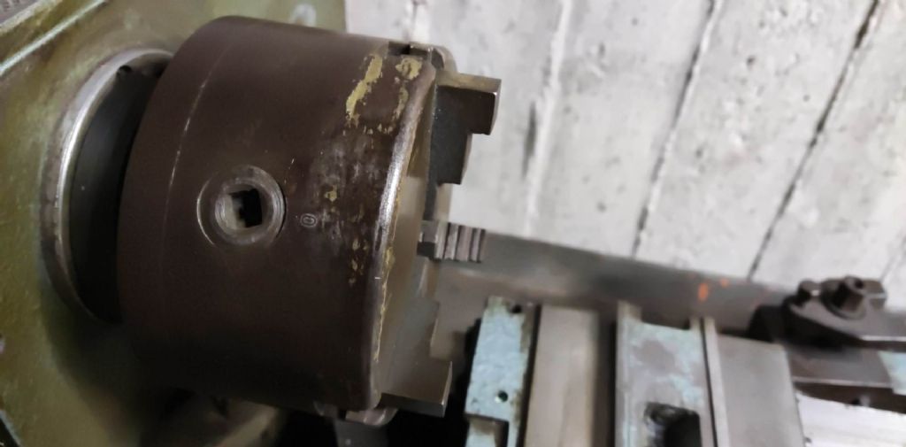

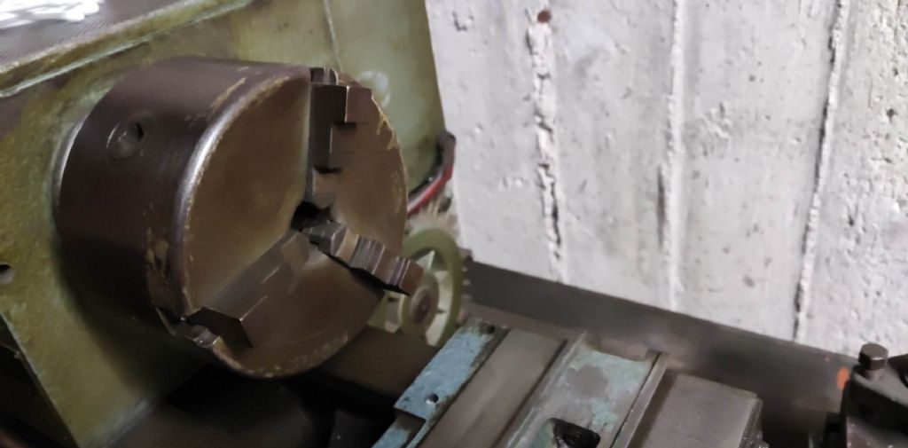

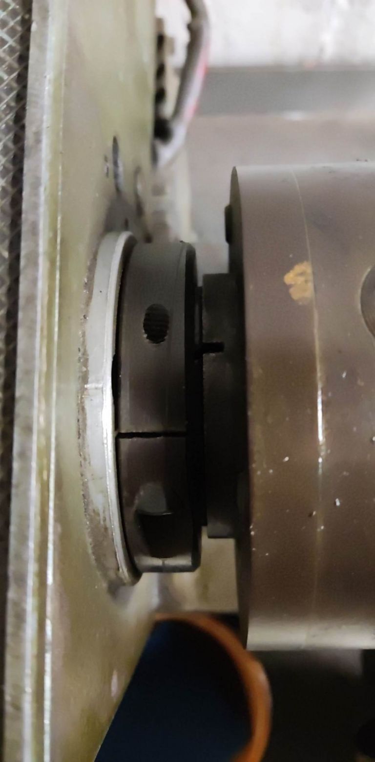

- Does anybody have some info on this lathe chuck ? Lathe's s/n is stamped on it - on the back, as well as that "0" that you can see on photos. No other marks.
