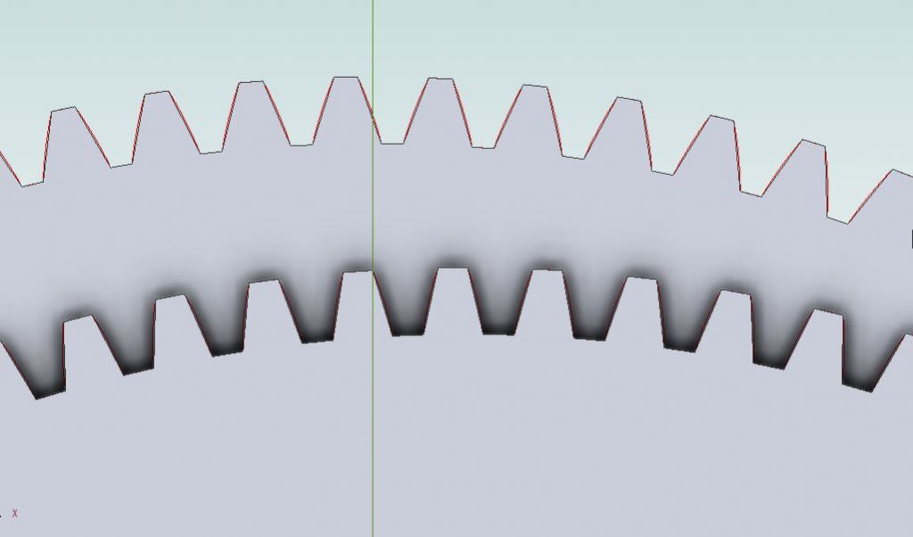

Joseph, what pressure angle are you cutting? If 14.5pa then they will look narrower than 20pa which is what most modern gears are cut to these days and could be what you are making comparrisons with.
joseph tatler27/01/2023 16:48:45
21 forum posts
yes its 14.5 PA so that will be the issue maybe
JasonB27/01/2023 17:02:46
avatar
25215 forum posts
3105 photos
1 articles
This shows the difference, the upper one is 100T 20pa and the lower 14.5pa
joseph tatler27/01/2023 17:28:33
21 forum posts
thats helpful thanks
Andrew Johnston27/01/2023 18:45:00
avatar
7061 forum posts
719 photos
The width of the tooth at the pitch circle diameter is not dependent upon pressure angle. But larger pressure angles gives a tooth that is more triangular in shape.
