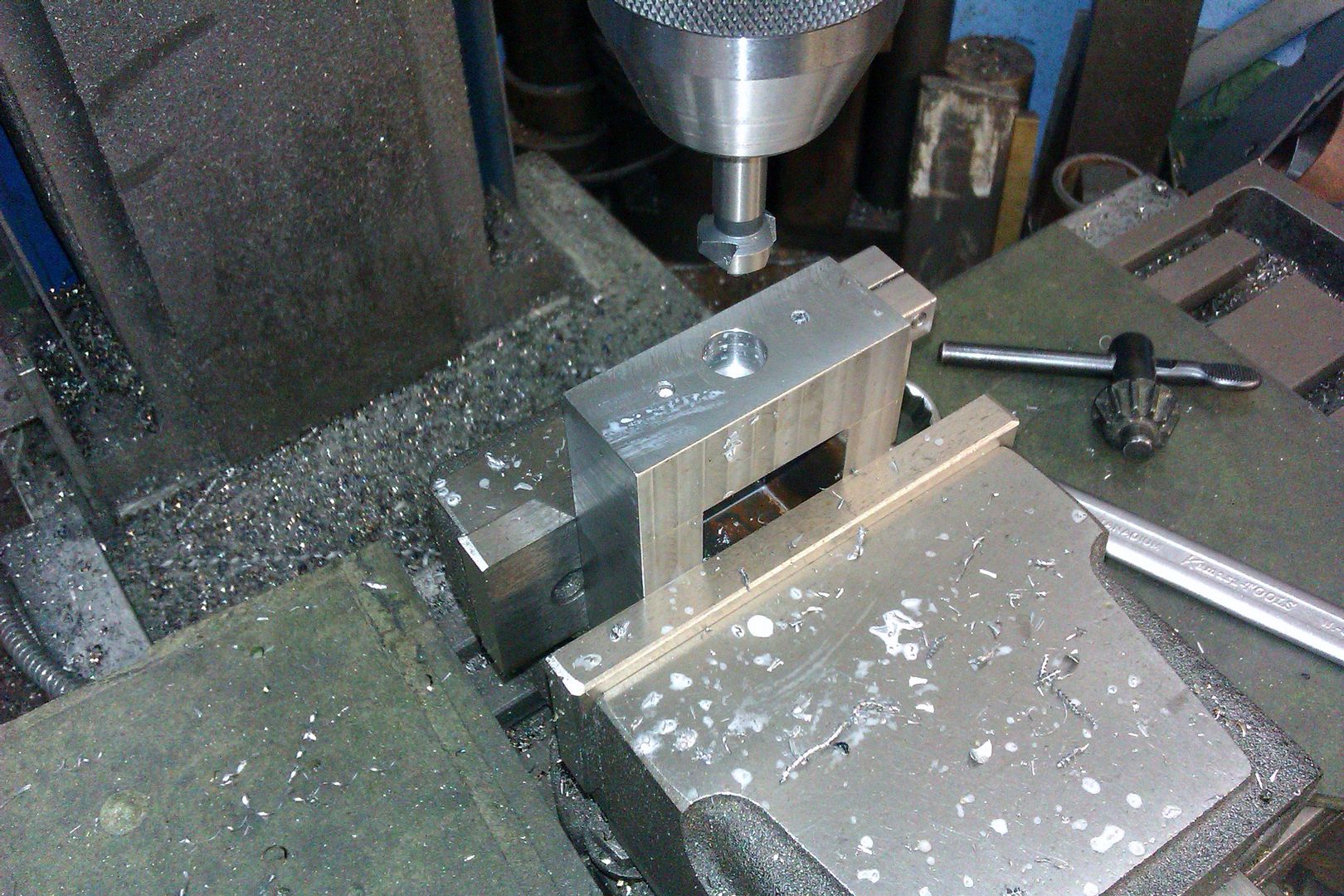

In the thread by Dr G on his making of the Stuart Twin Victoria the making of these small but significant parts has been discussed. Rather than spoil Doc's thread here are a few images to explain an alternative way of manufacture.
First off some simple maths to establish the half angle of the diamond is required. Once this is known the 'fixture' can be tackled. It's just a simple piece of mild steel plate (ali would do) with two parallel edges a bit wider that the mill vise depth.This has a hole drilled in close to the edge that will take the diameter of the gland boss. Another hole is drilled to coincide with the gland bolt hole at the angle previously worked out
The plate with two embryo glands. The deep chamfer is to cater for the radius on the boss
The plate is set level in the vise (image gives the appearance of an angle but it is parallel with the table) and the cutter set to the depth required.

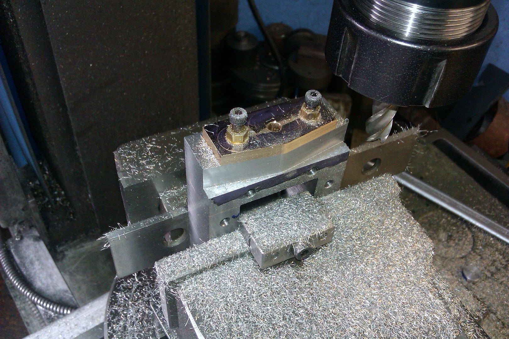

A small pin is turned to match the clearance hole and the boss clamped in place. The part is milled to the depth set........

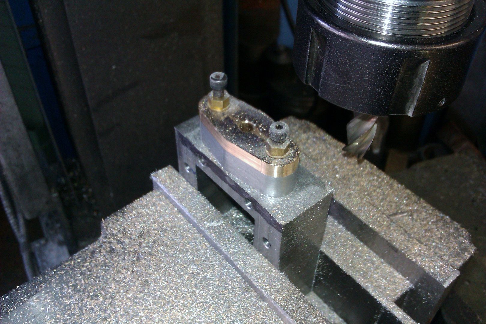

.........then rotated to mill the opposite side
The plate can then be reversed or the part inserted from the other side of the plate to do the same on the remaining edges
Initial milling complete

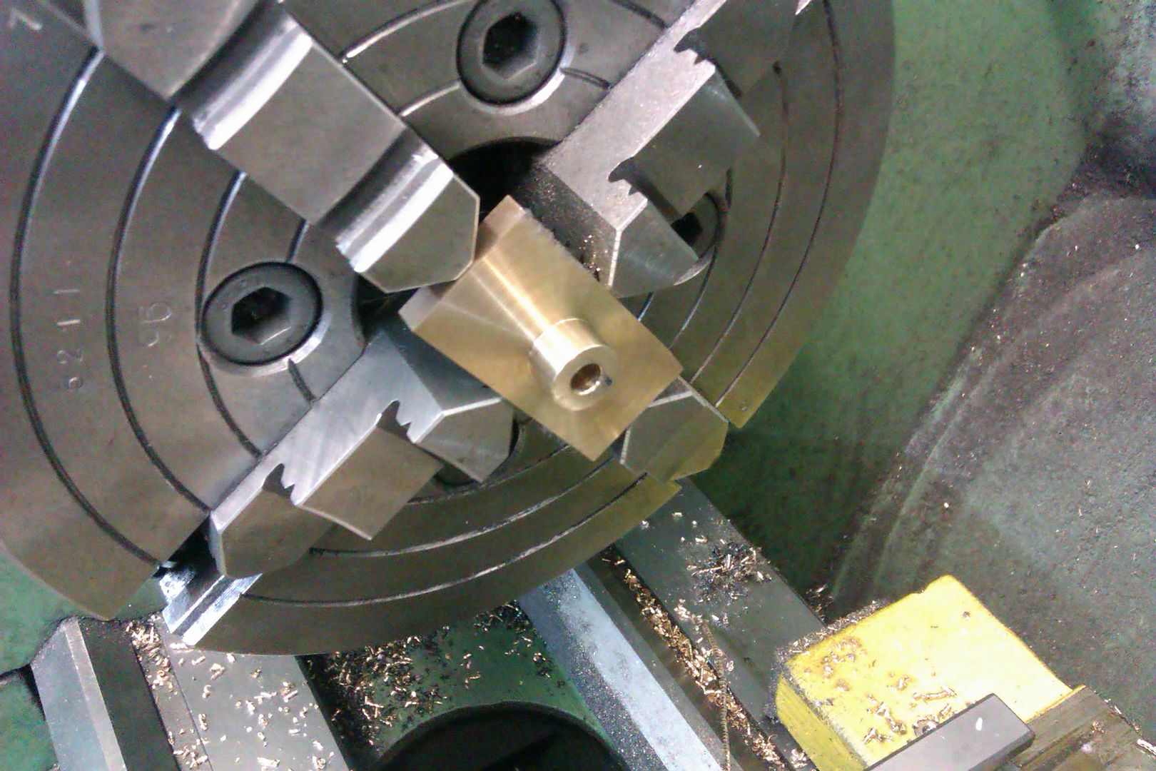

I appreciate this shows steam pipe glands but the principle is exactly the same for piston rod glands. The part would not have a centre hole in at this stage however. It would then be bolted to it's respective cylinder cover and be drilled and reamed together
This image shows a round gland being opened up with an FC3 cutter before being drilled and reamed in such an operation

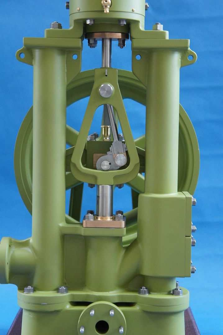

I have a different approach which was probably developed as I often also need to shape the matching boss that the gland fits into. It also works on poorly shaped castings that need the boss cleaning up.
First the "Casting" is drilled, tapped, reamed and counter bored so that the embryo gland can be screwed on and the two machined as one.
Then the boss on the gland is turned and the hole reamed, her eI'm using a piece of bar a sit's quite a large gland, smaller would just be turned on the end of round bar before parting/sawing off and cleaning cp the top with a skim cut.
After drilling the stud holes in the gland it can be screwd in place. Then set up the rotary table and a means of holding the assembly which will usually be the vice (clocked in on X) and get the rod hole true under the spindle, zero DRO or handwheels and note R/T angle if not zero.
Now the shape can start to be milled out. Turn the rotary table to the first flank angle and rough that out leaving 0.25mm and then repeat for the other three flank angles. You can then go back to do a final pass which is done as a flank angle then with out moving the cutter rotate the table so it forms the mid radius and then when you get to the opposite angle lock the table and carrying with the straight cut out to the end, repeat on the opposite end. All this can be done with full depth cuts ratherthan wear out just the end of the cutter
Here is a close up of the basic diamond with a smooth transition from flat to round and to flat again
To round the ends put your vice stop in place with a bit of packing (don't have any gauge blocks) between that and the part which is the size of the stud offset. Remove the packer and slide the part up against the stop. The spindle will now be directly above one of the stud holes so a simple job to offset by the required radius plus half cutter diameter and round off an end, repeat for the other either by flipping the work in the vice if the boss is central in Y or moving to the opposite side of the vice if offset such as you find on the Stuart Victoria valve gland
Bit of paint and jobs done, also used this method for the piston rod gland

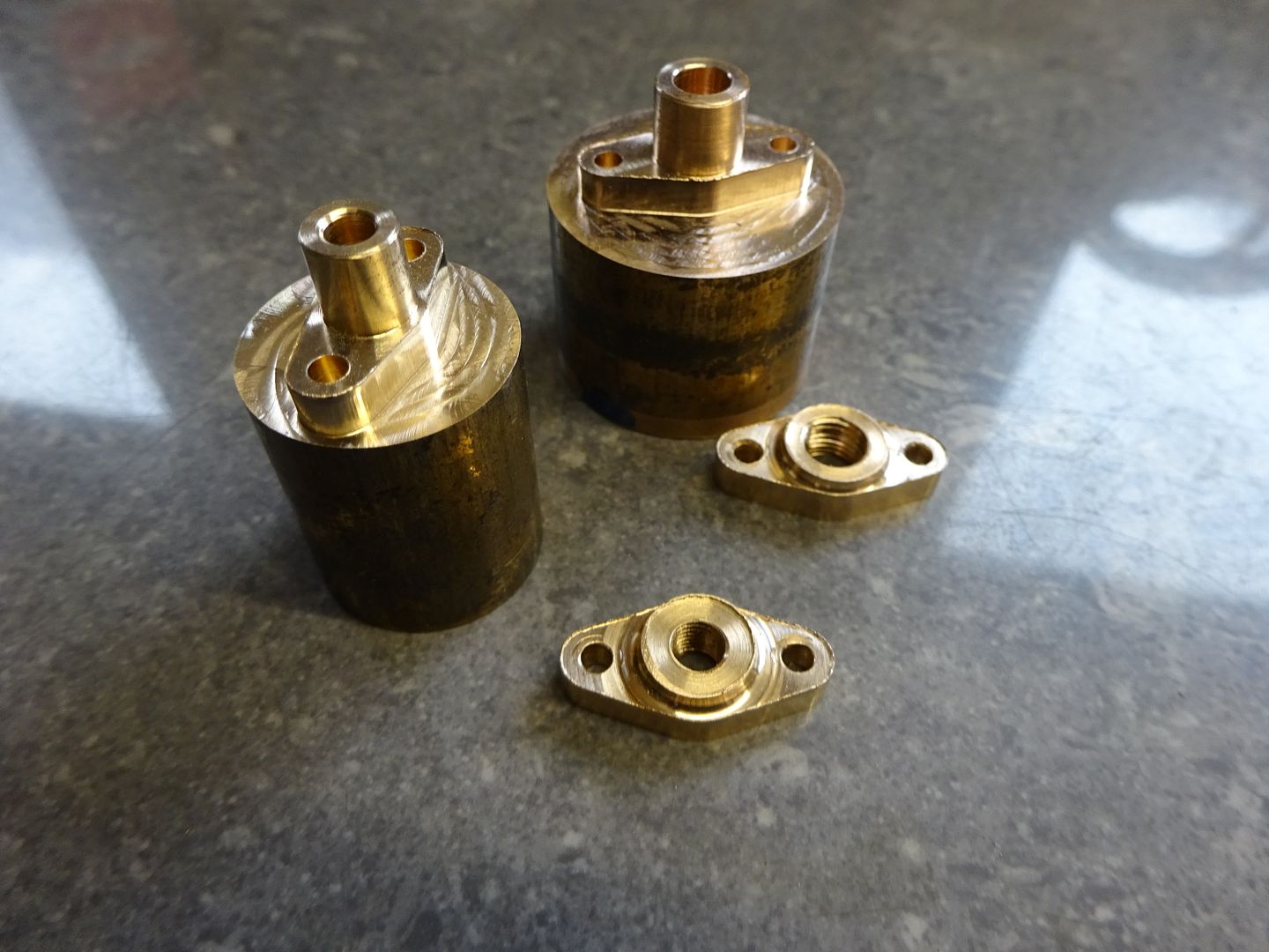

These days I am likely to take a different approach and use the best tool for the job though not everyone has a CNC in the shed..
My CAM program tells me that each gland on the left tool 1min 35 sec to profile the diamond, the spigot having been previously turned on the bar. A further 13 seconds to add the two stud holes. Each is shaped differently to suit the cast boss.
The two castings for the pipes also had their external shape done on the same tool, 21secs each.
The same tool can also do a batch of glands complete with draft angle that can be used as a pattern for casting
Edited By JasonB on 18/06/2022 07:37:07
