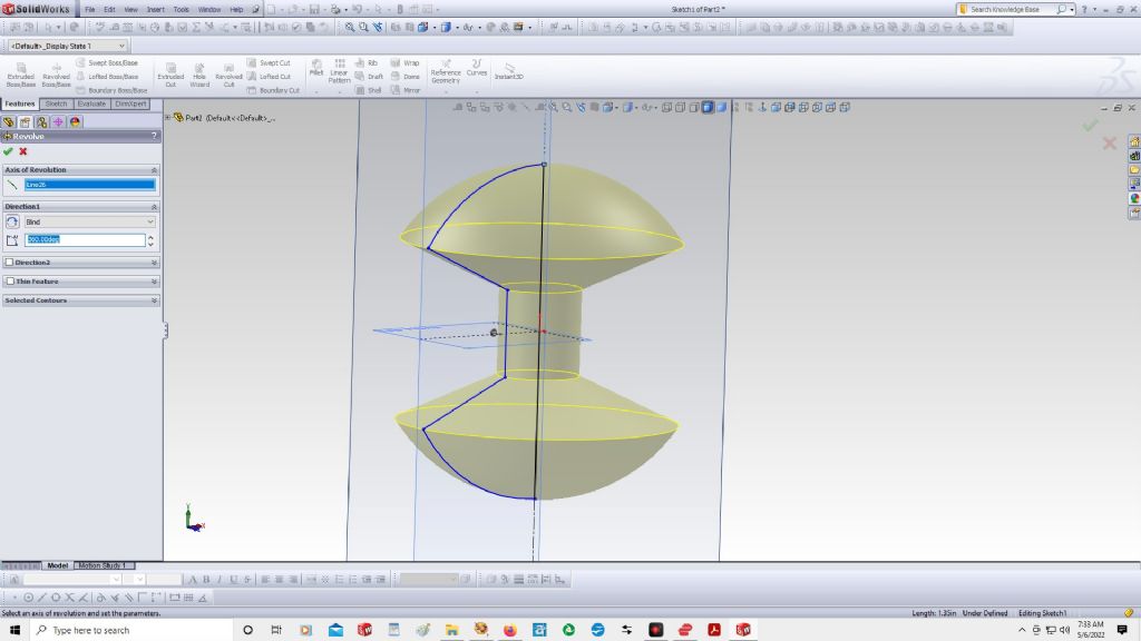

PatJ06/05/2022 13:26:46
avatar
613 forum posts
817 photos
In this example, whatever sectional shape I draw will be revolved around the vertical axis I drew.
I have created my first sketch plane, and it should be listed on the left side of the screen.
I can right click on that sketch plane name, and toggle back onto that plane, and edit it to create a different revolved solid, as follows:
Note that when I start to edit the sketch I created, the program presents the three planes to me in an isometric arrangement, and I have to pick a button to bring my sketch plane flat on the screen. I am not sure what the exact command in my or other programs is to do this.
Edited By PatJ on 06/05/2022 13:27:33

Lets modify the 1/2 circle sketch again to create yet another 3D shape.
Basically, whatever shape you make the sketch, that shape will be revolved around the axis you choose (in this case the vertical axis), to create a 3D object.
