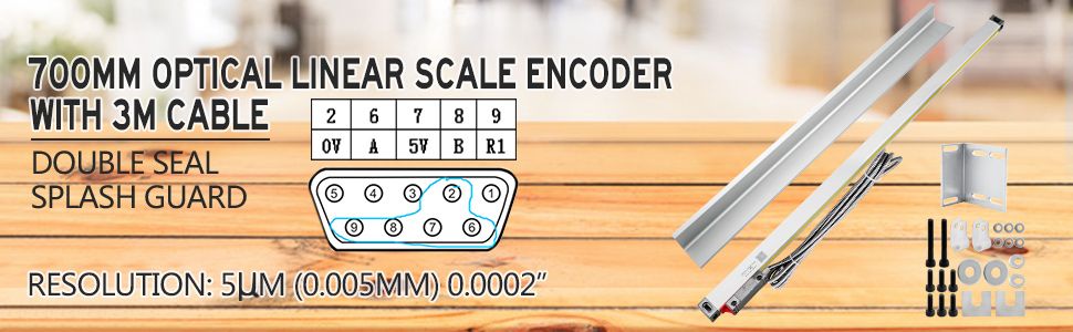

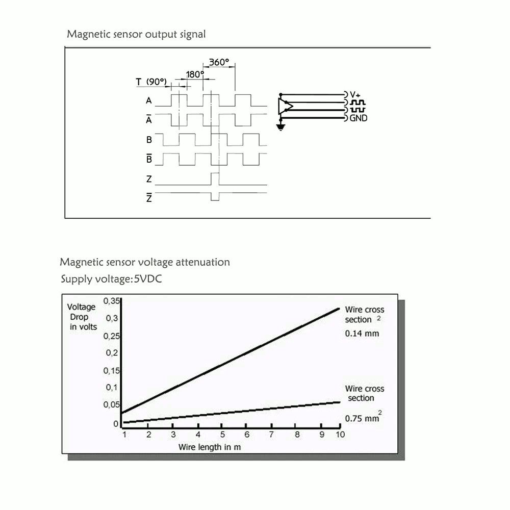

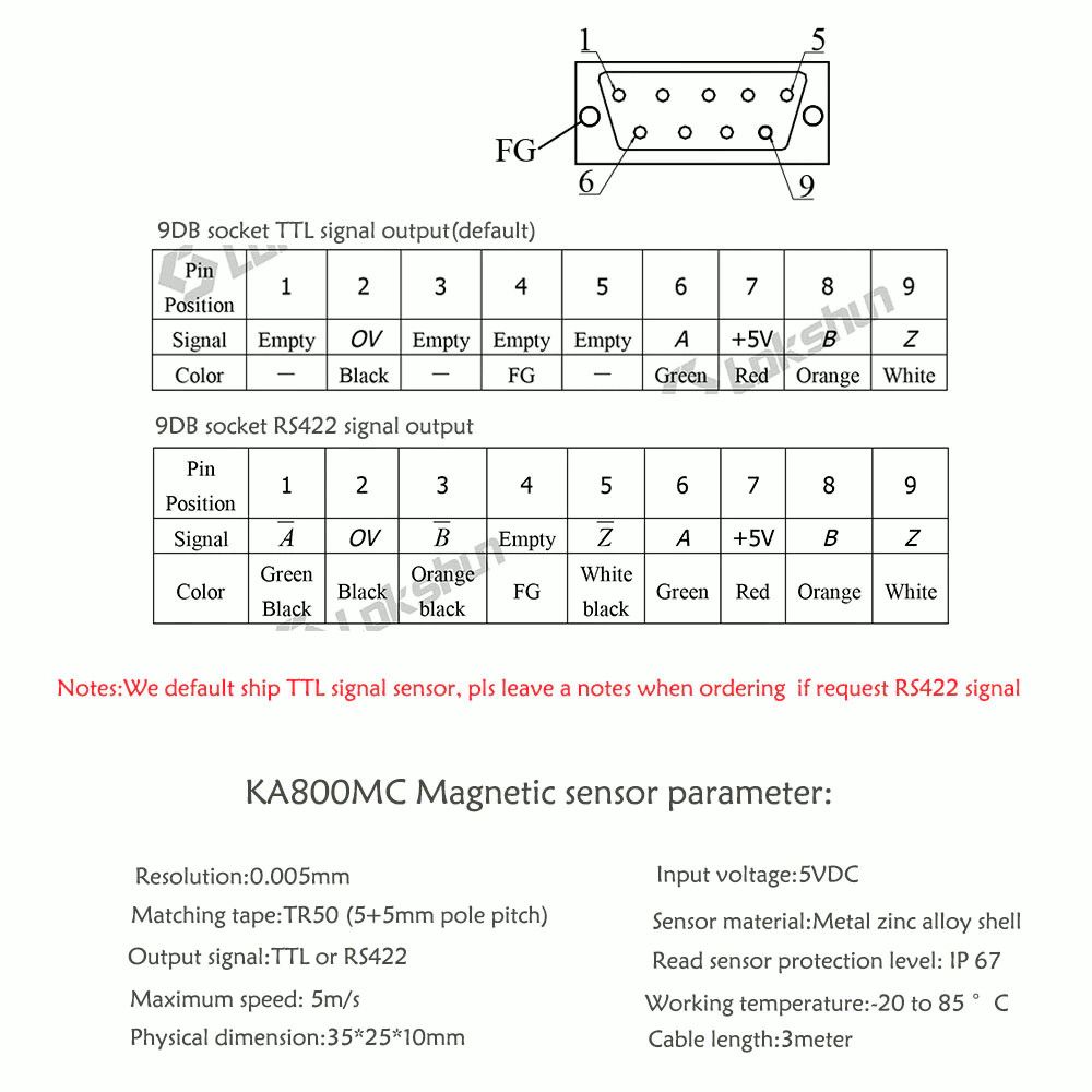

While waiting for someone better than me to answer, I'm doing research to better understand how the signals travel from the linear scale to the digital player. I think this can be useful to all users who want to reduce the encumbrance of the linear stairs mounted on the cross slide
From the Chinese sites I have drawn the connection diagrams of the optical and magnetic scales. So far it seems that the pins are compatible.
magnetic linear scalemagnetic linear scale
Vevor linear scale:

I have pics in my album setting up magnetic dro and is fitted to a Chinese dro. It all works fine.
