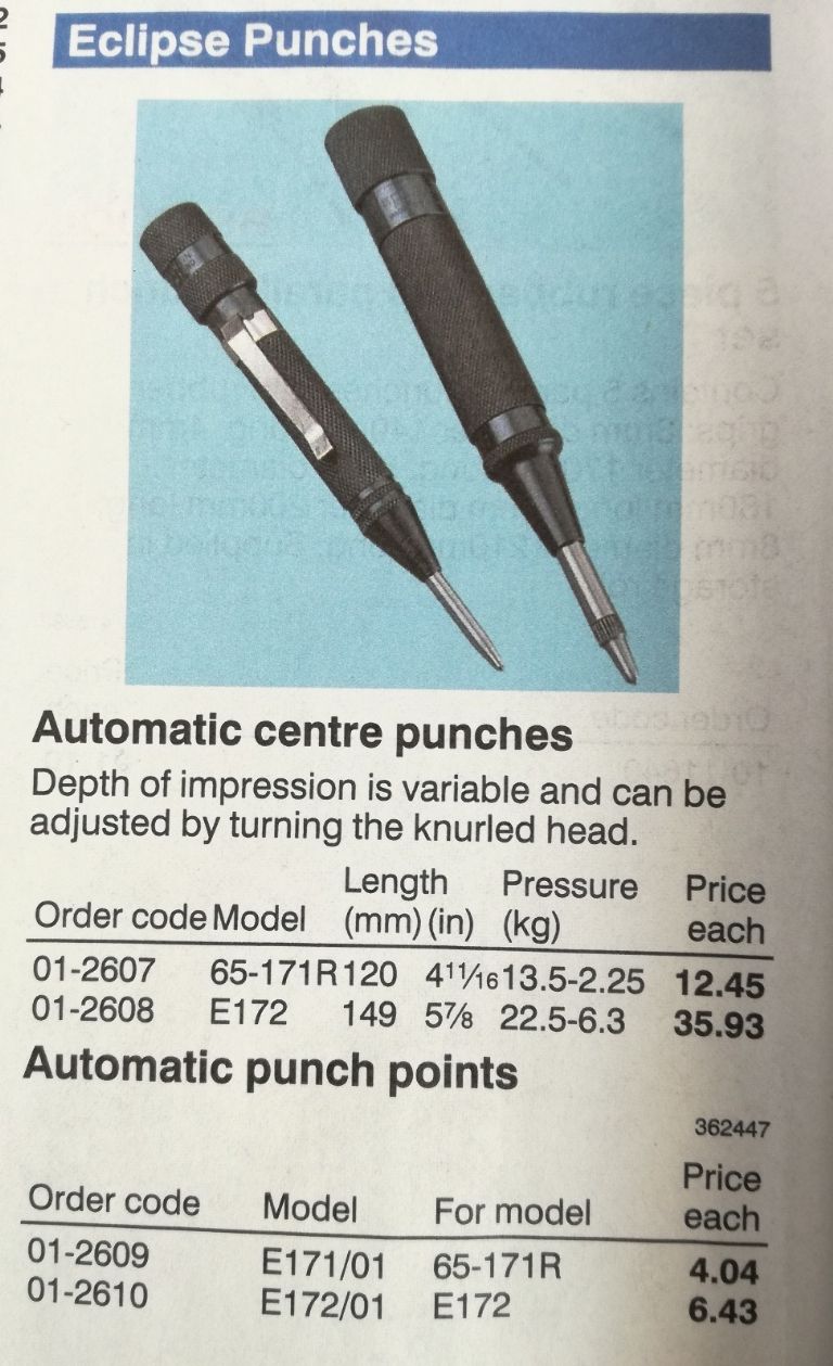

I found a thread on here that touched upon the subject but drifted off into merits of the 172 over the 171 etc I could not see the original question answered.
As I am now also in need of the same spare tip I thought I would ask again if any one has a specific source they can quote.
Please note I am very happy with my punch.
I am not interested in alternatives or a discussion of the x/y/z of any thing else.
Please only reply if you know an actual source !
Thank you
Clive

Nicholas Farr11/02/2022 11:00:38
avatar
3988 forum posts
1799 photos
Hi Clive, this from B&H's 2008/9 catalogue, may be of interest
Regards Nick.
Hopper11/02/2022 11:33:17
avatar
7881 forum posts
397 photos
Just make a new tip out of silver steel and harden and temper it. Or sharpen the old one by holding it in your battery drill and contra-rotating against the bench grinder wheel.
