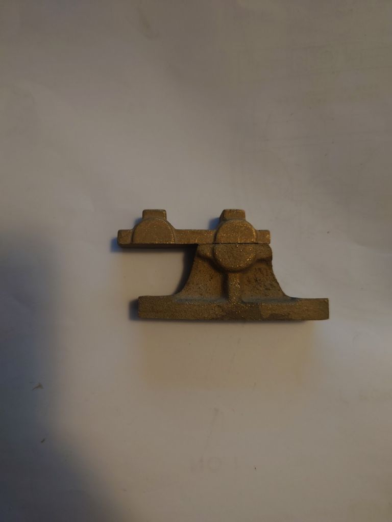

I am making the Kennions Tina steam engine and im struggling with the bearings. I have the build notes by Stan Bray and they go into a lot of detail boring the hole for the crankshaft but when it comes to the mounting holes there is very little info.
the drawings state to ream the bearings when they are bolted to the base casting but the write up shows they are bored to size then bolted on.so ,how do i drill the 2 mounting holes so the crank hole is in the center. as there is such little info in the jam packed full of detail write up i feel im missing something very simple. the bored hole is 3/8 and the holes are 1 1/4 either side of center.
i have a wm 14 with a 3 axis dro.

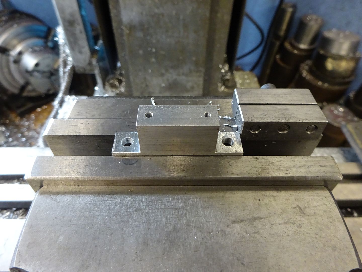

I would clean up the bottom face first.
Then hold in the vice on some packing and machine the top face, then locate ctr and do the two stud holes for the cap and the two mounting holes in the feet
The caps can then be held joint upwards in the vice so the joint face can me milled and clearance holes drilled.
You can now screw the two together for boring which I would do by setting the foot of the pedestal against the vice fixed jaw that way both holes will be the same height if you don't disturb the Y axis.

With regards to the holes in the feet if while you have the casting upside down to flatten the bottom you also take a light cleaning up cut off either end you then then have two points of reference and can locate their centre and set everything else out from that. If you look at that image I posted I'm using one end of the "foot" against a stop so that I only have to find the ctr once and then just swap the two pedestals over.
The same stop can be used for the second ops on my list and the boring of the bearing so everything is located equally either side of ctr.
I have not read Stan's build but at the time he was writing many would not have had a mill in the workshop let alone one with a DRO so some of his methods are a bit dated now.

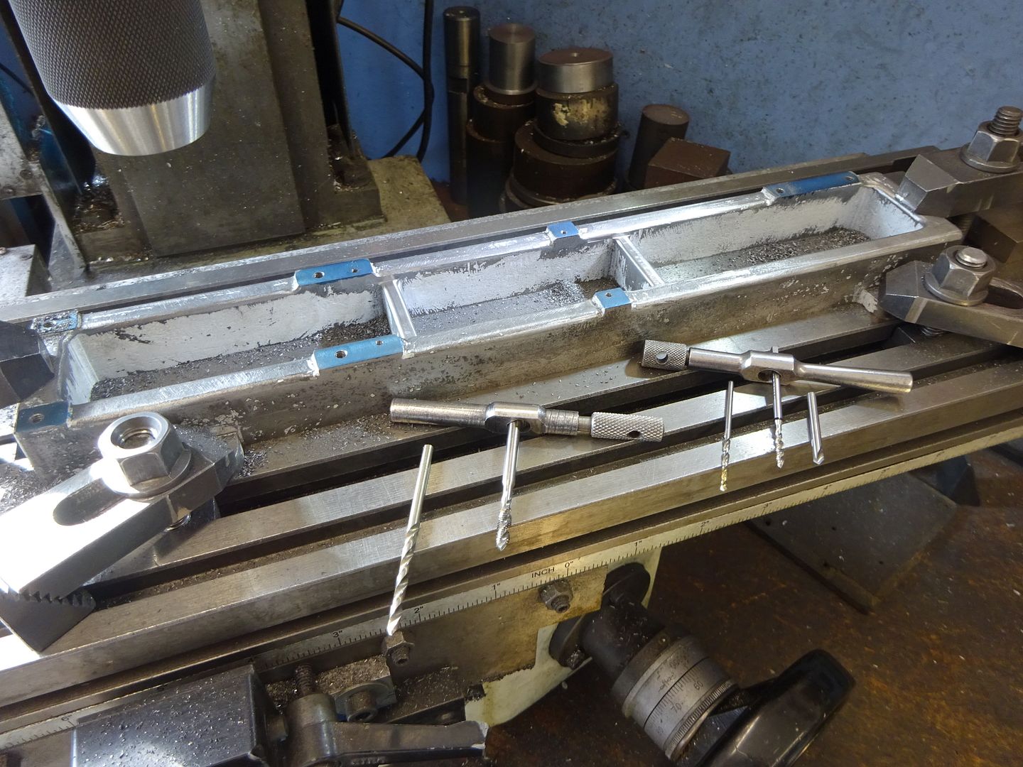

These days I would clamp the bed casting down to the mill table, clock it true and establish my datum. Then mill the various bosses flat before drilling the holes for cylinder, cross head guides and bearing mountings all in one setting using the DRO to position them. Its going to be more accurate than marking out, picking up punch marks and spotting through from other items. I would then expect each item to screw on with little chance of not lining up.

What Jason says, but bear in mind you should drill clearance holes in the castings to bolt down the bearing blocks, and this will give a little wriggle room to align the bearings.
