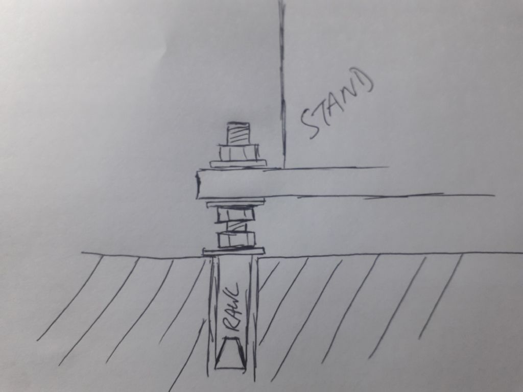

Good afternoon. I am after information as to the best way to fasten down my Myford ML7 Lathe /cabinet.Will it be better to bolt it to the concrete solid floor or to rest it on anti vibration material,I have got some 16mm thick anti vibration material strips. And then level the lathe bed. Thanks regards Steve

Hi Steve, BOTH!
In the past I have bolted the stand down using the Rawl bolts that expand, use the type with 10mm threaded bar this allows you to use an extra 2 nuts per bolt. First nuts allow you to level the stand because I haven't seen a perfectly level concrete floor! and eliminates any twist. The second nut to hold it down. I have had a 7 on this now for over 20 years and is fantastic, so solid and never moves. But at the moment I am setting up a work shop and I'm still moving things around so I have my Mill and a 7 on the yellow machine feet (from RDG Tools etc) these can also be adjusted to level the stand and up to now have found them excellent.
Matt
Matts BitsNBobs06/01/2022 19:56:41
avatar
29 forum posts
3 photos
Just like this Steve
Cheers Matt
