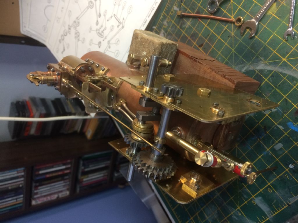

Hi,
This 40 yr old kit is coming along nicely...

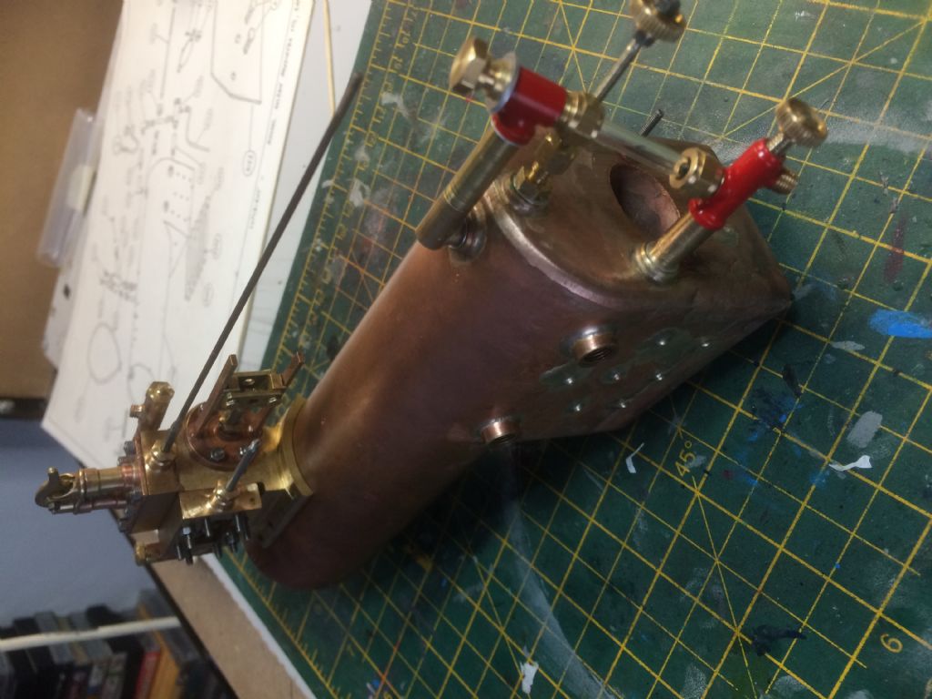

Terry Chapman24/12/2020 13:56:35
avatar
97 forum posts
14 photos
Posted by br on 16/12/2020 16:26:33:
Nice start Slash. Just keep the pics coming.
br
Thats me done for xmas!!

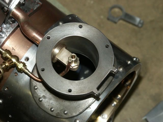

Hi,Says on the instruction sheet that the blower pipe diameter should be reduced to about the diameter of a pin to help get a good draught. Does that sound about right?
Thanks
JasonB01/02/2021 13:17:04
avatar
25215 forum posts
3105 photos
1 articles
Yes on such a small engine you need the velocity that the small opening produces to get a decent draw.
My 2" fowler only has a 1.2mm opening

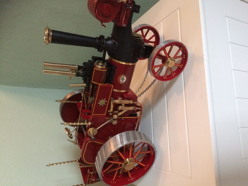

Terry Chapman04/04/2021 09:28:47
avatar
97 forum posts
14 photos
Posted by br on 24/12/2020 14:13:42:
Thanks for posting Terry
All looking good.
Happy Xmas to you
br
