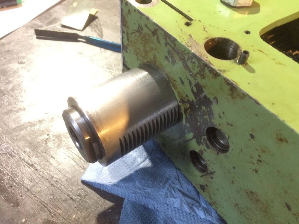

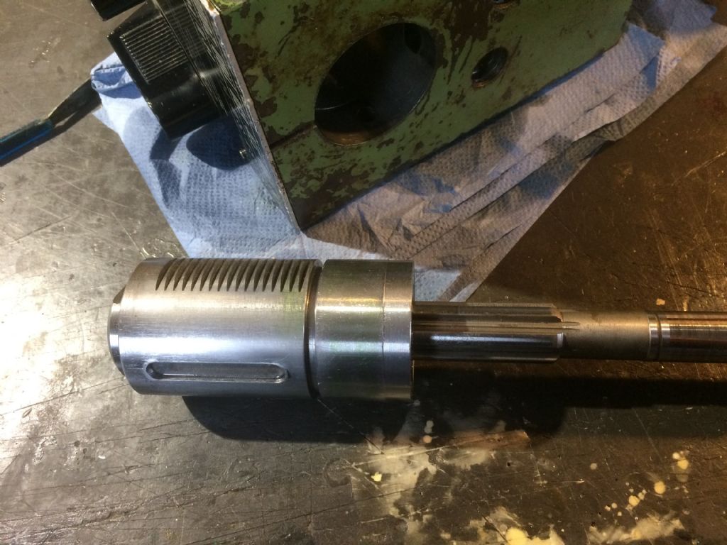

Henk Bonestroo 105/10/2020 12:20:10
4 forum posts
3 photos
Hi Chris (Long1),
My name is Henk and I live in the Netherlands and new on this forum. Since I encountered the same problem as Chris. I'll post some photos of the spindle and quill. Checked for roundness of the quill and it is within 0,01 mm except for the top of the keyway. There I measure a few hundreds more thickness. Could it be that if someone (I got it second hand) tried to force the quill beyond the 40 mm down movement with extreme force and caused a high point at the end of the keyway?
Dave Halford05/10/2020 16:22:07
2536 forum posts
24 photos
Definitely looks bruised and like it's been rubbing at both ends, perhaps someone hammered the quill down to set the taper.
Graham Meek06/10/2020 11:15:26
714 forum posts
414 photos
Hi Chris,
I have just been reading through your opening post for the first time today, As soon as I read you lowered the Quill in your attempt to extract the taper, I knew what had happened.
There is bound to be damage at the top of the Quill Guide slot as Henk shows above, but may be not as bad as that shown. You may have also damaged the locating bolt end where it fits into this slot. It may even be bent, and so may be rubbing on the bottom of the guide slot as there is not a lot of clearance here.
I suspect also that you will have damaged the Ball races in the Quill itself due to the hammering. Beware the circular nut in the centre of the quill is a LH thread, should you decide to take this apart. Unfortunately the ball races are not standard issue. They are specially made for Emco, in that they have to be assembled with the faces marked abutting. This takes out any end play in the races. Replacing these with standard races will probably lead to some play in the spindle vertically.

Dave Halford06/10/2020 21:00:12
2536 forum posts
24 photos
Shows you how tight the quill tolerance is.
Graham Meek07/10/2020 12:36:10
714 forum posts
414 photos
The actual EMCO Quill drawing states a tolerance of g5 on the 52 mm diameter. This in terms of a measurement is -0.01 / -0.023 mm, or minus 4 to 9 tenths of a Thou.
Emco in their infinite wisdom specify a chamfer of 0.4 x 45 degrees at each end of the slot to try and mitigate burrs at this point from affecting the sliding fit.
