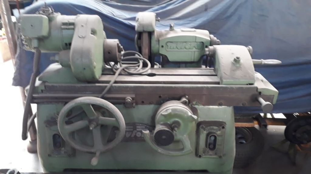

Hi all,
I have recently purchased a pre-owned Myford MG9 cylindrical grinder. I will post photographs and information on the restoration of this machine for reference for anyone that may need information for a similar project.
I haven't yet managed to locate any workshop manuals for this machine, but the disassembly and cleaning was fairly straight forward.

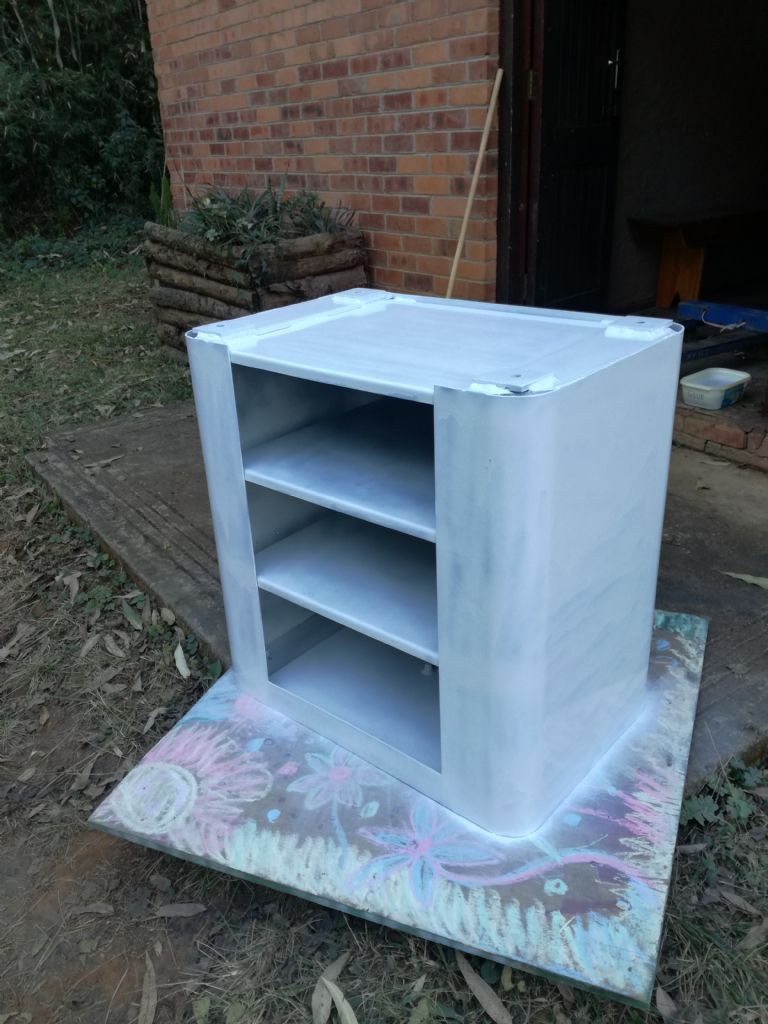

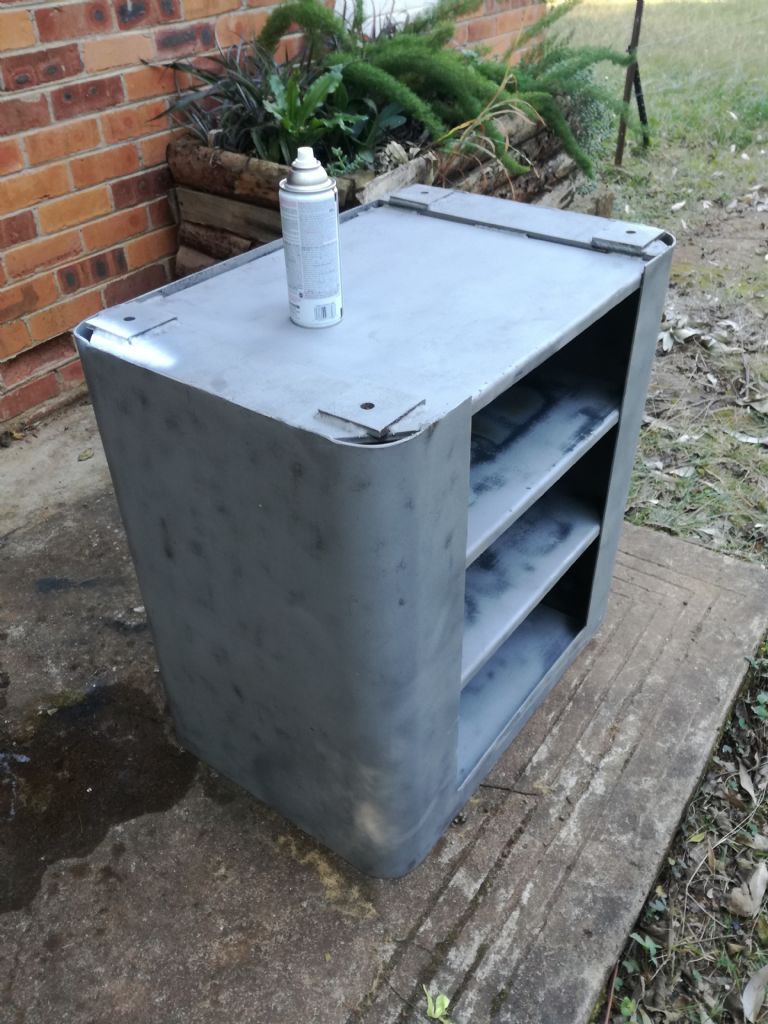

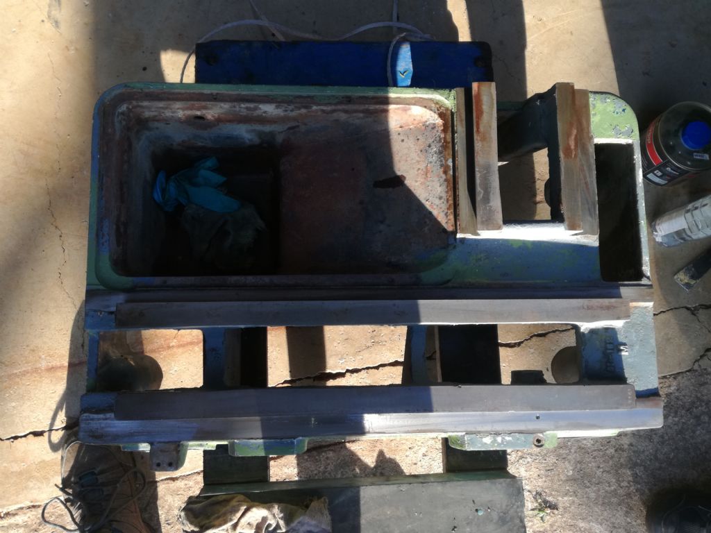

First order of business: Sand blasting and priming the cabinetimg_20200627_143239.jpg

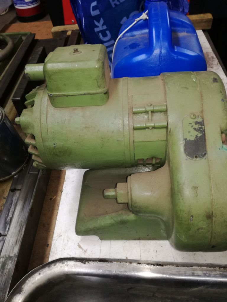

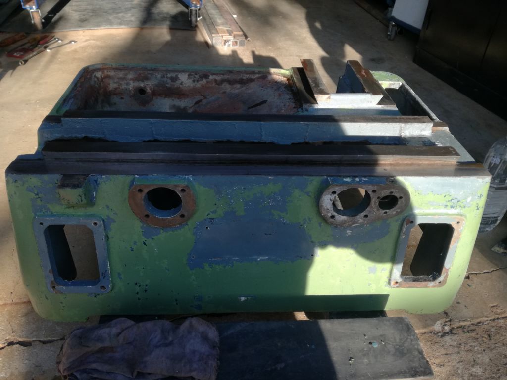

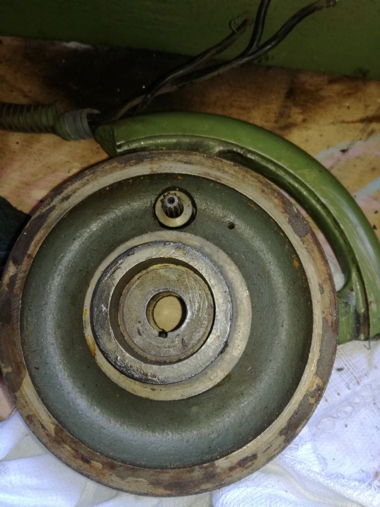

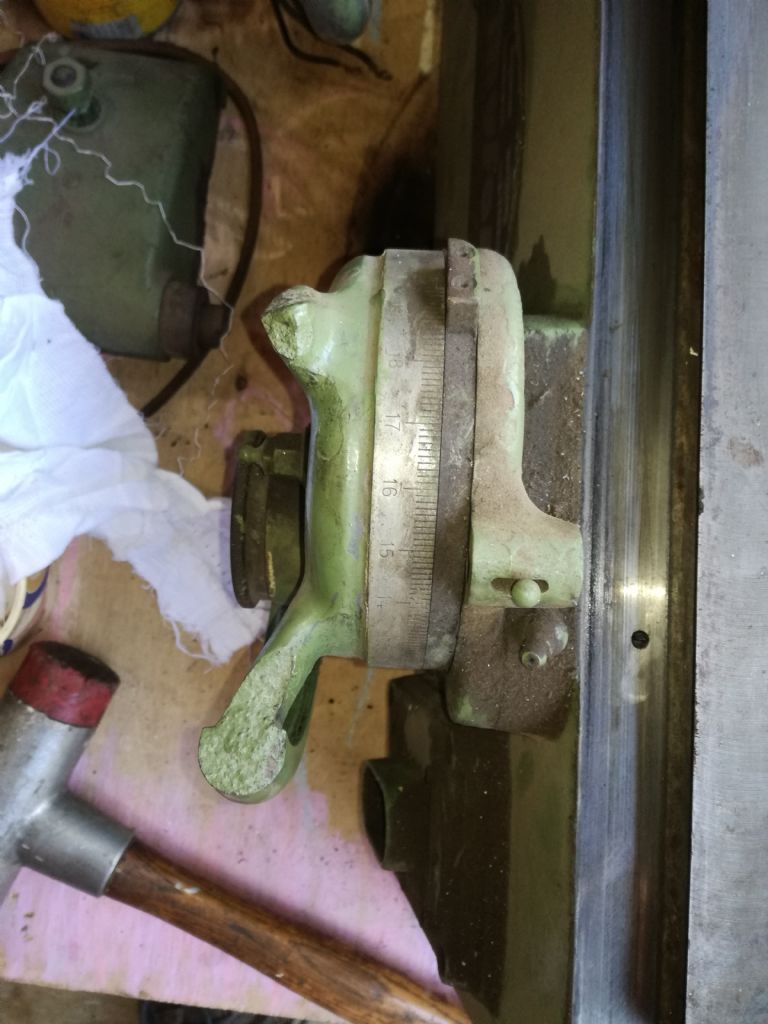

img_20200704_090102.jpgimg_20200704_090053.jpgimg_20200704_090041.jpgimg_20200704_090034.jpgimg_20200704_090028.jpgNext task, stripping parts off to clean, repair and paint.

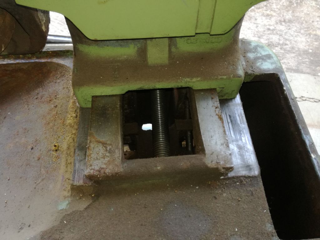

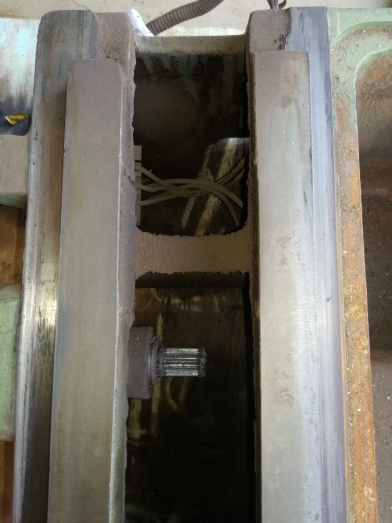

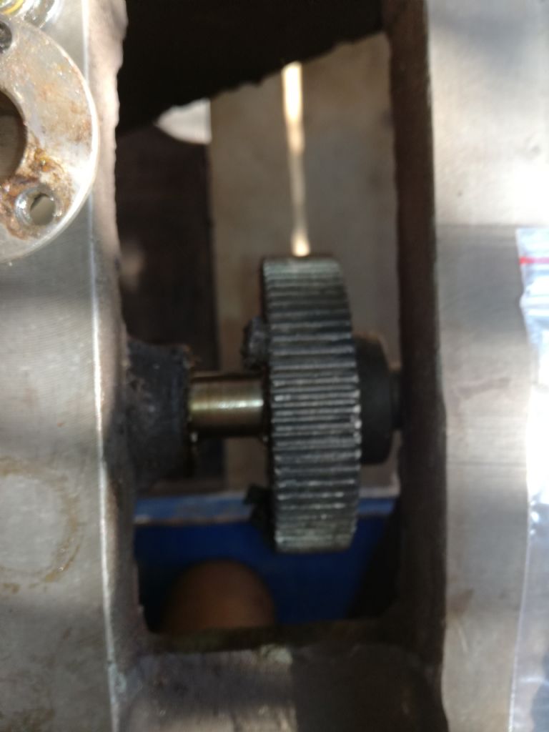

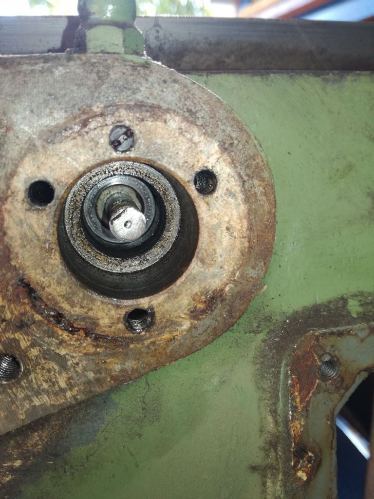

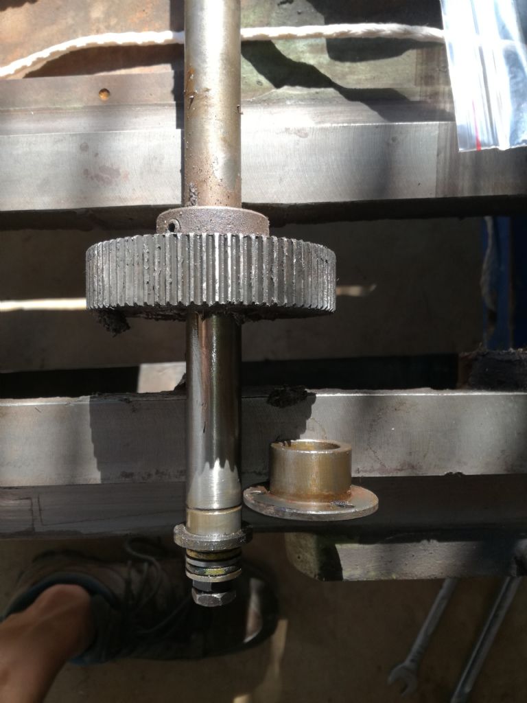

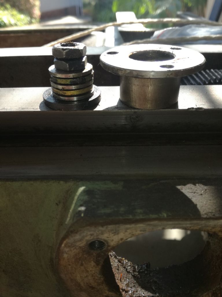

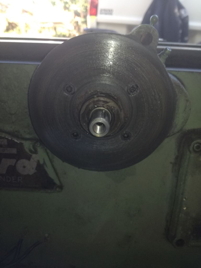

Getting the drive wheels and shafts out of the main body.
img_20200704_140351.jpgimg_20200704_140114.jpgimg_20200704_140107.jpgimg_20200704_140101.jpgimg_20200704_093239.jpgimg_20200704_093134.jpgimg_20200704_093129.jpg

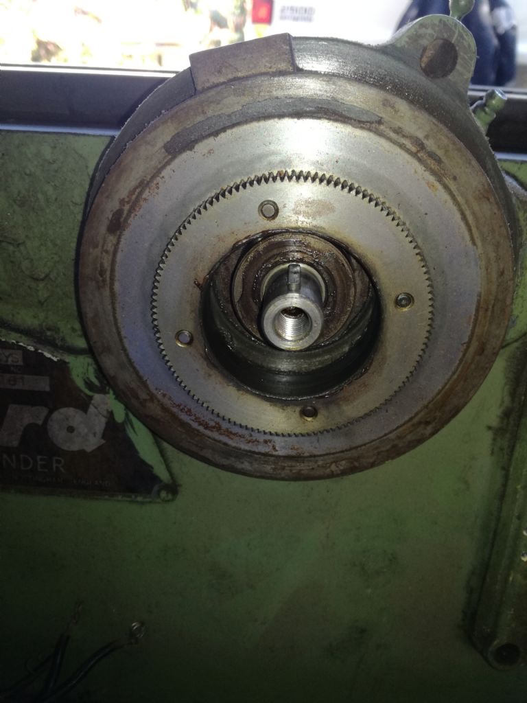

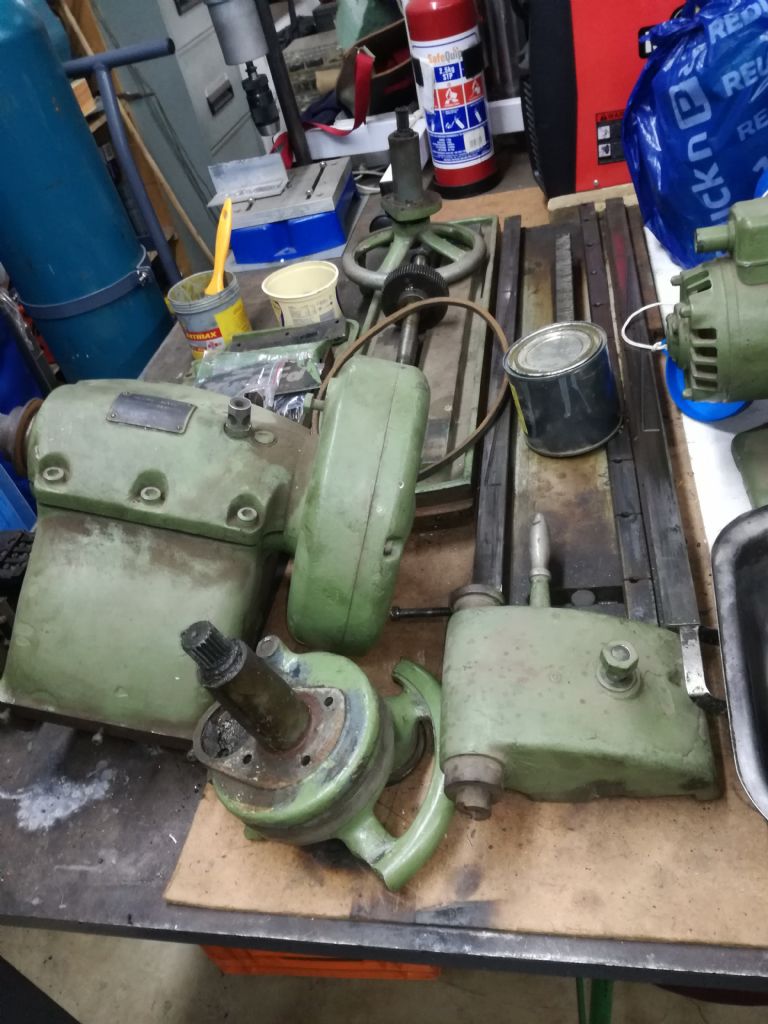

Most of the parts separated from the main body. Next job, to pull apart all of these assemblies.
img_20200704_155108.jpgimg_20200704_155102.jpgimg_20200704_153949.jpgimg_20200704_153943.jpg

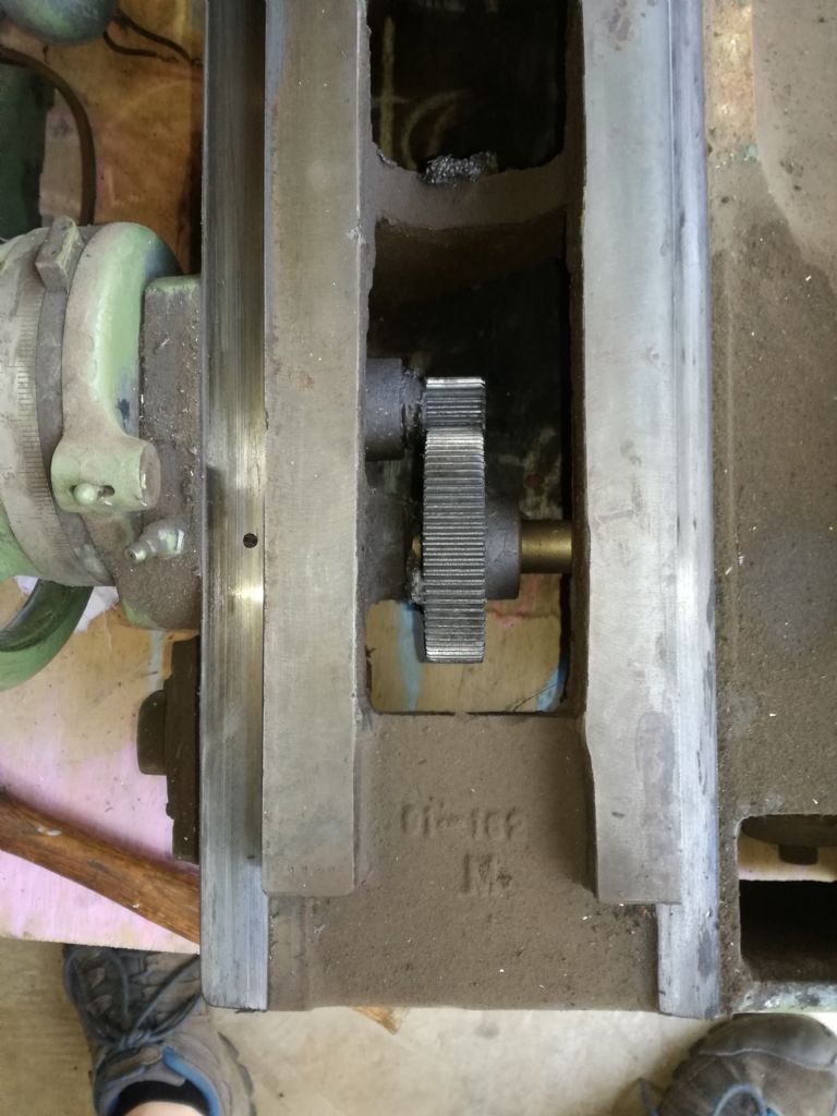

You will not regret owning a cylindrical grinder when your restoration is complete. In a moment of madness over twenty years ago I bought a J&S 1310 at a local auction. It's a beast to have in a home workshop, much underused and probably not really justifiable and its power frightens me but finishing to within a couple of 10ths is as easy as falling off a log.

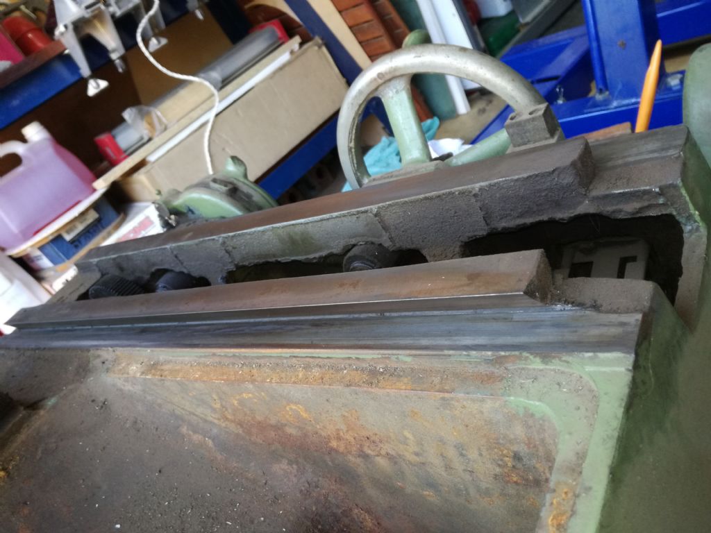

Pete Rimmer10/03/2023 20:46:17
1486 forum posts
105 photos
I have one of those too, they are not at all common.

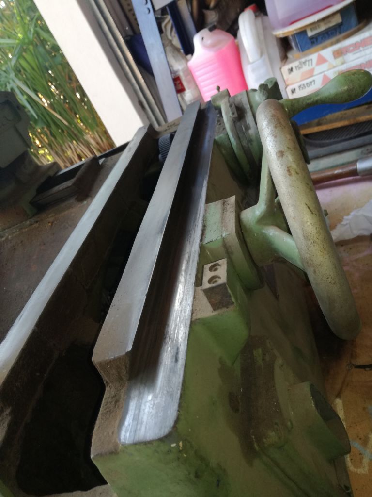

Looks like you have a bit of wear in the long ways and they would benefit from a light scrape. Luckily these machines were very evenly but looking at the smear marks on your ways just a go-over with a scraper will improve your oil retention and limit stick-slip in the table.
It;s a shame about the busted infeed handwheel but at least it's not the table traverse one. If you have the bits it should be a fairly easy repair.
Do you have any other bits apart from what's in the photos? Mine came with internal grinding head and a small steady rest.
