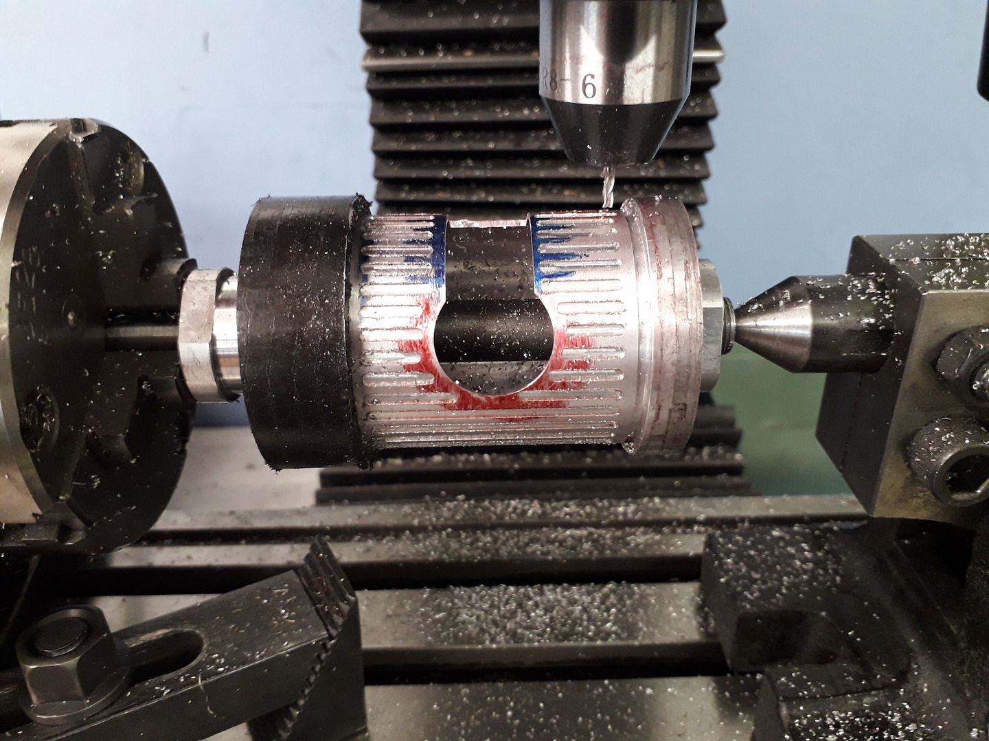

One item that I wanted to try and replicate on this engine was the metal cylinder cladding often seen on American engines that has a series of recessed "slots" in the surface. I started out by turning down some aluminium tube to the right diameters and then milling clearance for the valve block and exhaust boss.
I then made up a couple of plugs so it could be held in a 3-jaw chuck on the rotary table with tailstock support to mill the 2mm wide grooves.
As I have a 6mm Weldon shank holder for the SX2.7 I opted to use that as it made it easier to see the end of the small cutter, a bit of masking tape with some marks added made sure I stopped feeding at the right place as I don't have a DRO on this machine.
With the milling complete the tube was cut down the middle with my thinnest slitting saw so it could be fitted, a small loose piece also had to be made as it was not possible to slide the exhaust side straight into place.
