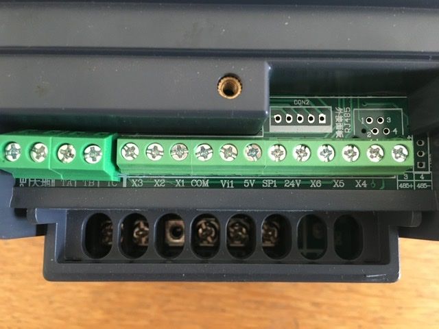

I have a couple of 2.2Kw XSY AT4 which I want to use to power a couple of 380V 3 phase star wired motors using 220v single phase supply.
I've bench run a 1/2hp motor successfully using the key panel for control but have run into a problem when trying to control speed using a 10K pot. For some reason I'm only able to obtain exactly half the max hz set in the vfd that I was able to achieve with the keyboard. I'm hoping someone will be able to advise why this might be the case and how I can get the full hz range using the Pot.
Unlike the other ATs in the series the AT4

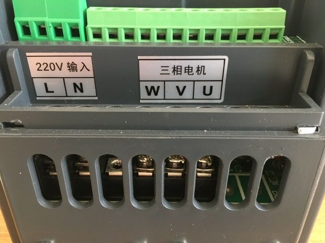

1: has no earth terminal . I was planning to earth the cooling fins but measured 85v ac between the fins and supply earth. Is this to be expected? Should I earth it?
2: has only 1 COM terminal on the control ports. The voltage between this COM and the 5v/10v terminal measures 5v Could this be causing the half max hz with the Pot?
The manual that came with the vfds is the same AT series manual that other people have posted for the AT1 Thanks in anticipation.

Thanks for response. I believe this vfd is supposed to be a “step up” vfd ie the output is 380v 3 phase at 50hz. I’ve used a true rms meter to confirm that this is in fact the case. The vfd is marketed as such too.
I guess I could increase the max operating hz parameter to say 140hz. Then using the pot would give me a max hz of 70 hz.
I wondered whether the two COM terminals on an AT1 are interconnected. The diagrams in the manual show the pot connected to one with all the other controls connected to the other one.
Do you have any thoughts on the lack of protection earth and the measured 85v ac between supply earth and the cooling fins?

Had a look at the Manual and it says the voltage is 5/10V. And then silence - very unhelpful! It implies to me the reference voltage can be either 5V or 10V, therefore I'd expect a physical switch or parameter setting allowing it to be changed. And it sort of follows that a pot connected to 5V when VC1 expects up to 10V will only be able to run the motor up to half speed.
Disaster : can't see a parameter setting in the manual, or any sign of a 5V / 10V switch on the VFD. Might be worth looking inside the case to see if there's a tiny slider switch on the board. Sorry if teaching granny to suck eggs but disconnect from the mains first and take extreme care not to touch anything metal inside because those big capacitors can store enough energy to deliver a hefty shock.
Should be possible to prove whether or not it's lack of 10V causing the problem by substituting a 9V battery for the 5V terminal. (Connect - to COM and + to top of pot.) Wind the motor up gently from 0V on VC1 : if it keeps speeding up when the pot goes past half way, it strongly suggests 10V is needed. If the motor doesn't go faster beyond the pot's half way setting, don't push on regardless up to 9V in case it damages the input electronics.

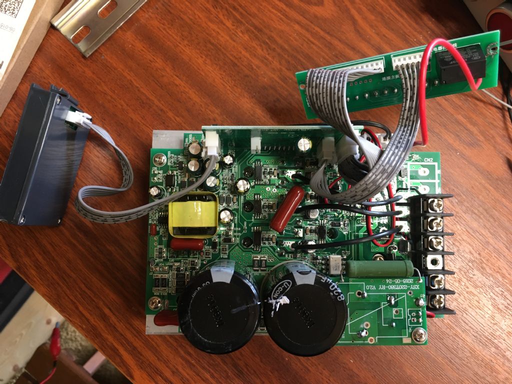

As I have two of these I’ll check inside the one that has not been powered up. I’m not an electronics engineer so whether I’ll be able to identify what various components do is debatable. I do have a healthy respect for electricity and thankfully the large capacitors are very obvious though I’m sure it’s not just them that I should be wary of.

There is no earth symbol on the vfd that I can see The manual links the AT1 with the AT4 and there is conflict between text and diagrams asto whether there is a GND, I’ve seen YouTube videos in which an AT1 does have a marked earthing terminal adjacent to the N supply terminal. This terminal exists on my AT4 but there isn’t a screw in it and it is not marked as such implying nothing should be connected to the terminal. One definitely doesn’t get what one hasn’t paid for!!

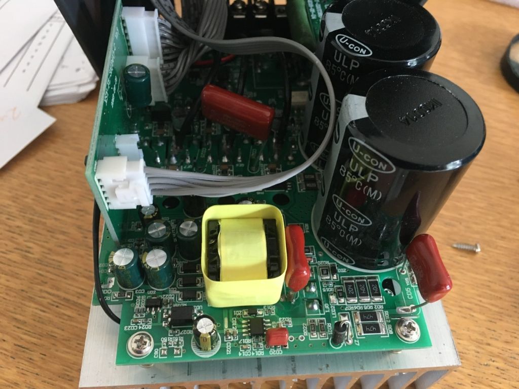

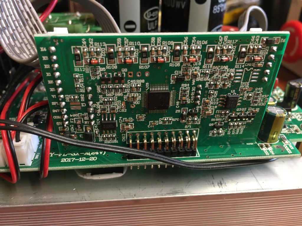

Can you post photos of the insides? If there's a switch or jumper should be visible, but it may be tiny. I don't understand the 5V/10V thing at all. I've read worse manuals, maybe some clot just left a paragraph out when it went to the printers!

I’ve tried adding in 9v to the pot circuit and it doesn’t seem to alter the hz indicated on Vfd.
I can’t see any obvious jumpers or small switches on the board
Andrew Firman23/05/2020 19:18:55
37 forum posts
18 photos
Dave, I was using a tarnished copper wire to do the 10v test so wasn’t getting more than 3v !!. Substituting an untarnished wire and Vfd indicated much higher hz and the motor ran at higher rpm than when using the 5v terminal on the Vfd. Problem now is how to change 5 to 10v.
Wondered whether Vfd is using current or voltage to alter hz?
If current then would a 5K pot instead of the10K pot I’ve been using solve the problem? Unfortunately I don’t have a 5K to use as a check.

Looked at the photos and can't see anything resembling a switch! Pity now you've confirmed 10V will fix the problem!
It seems perverse that the manual says wire the pot to a voltage source that can't allow full speed. Something is missing!
The control is more likely to be voltage than current, but it will need some current. I don't think changing the pot will make any difference because too high a resistance would cause trouble at the low speed end not the high. However the manual says 4.7kohms rather than 10k. No harm in trying it, and it may be necessary - see next!
I think the answer is to drop the 24v terminal down to 10v with a resistor to give the pot more range. I'll do the sum and draw a circuit in another post. Watch this space!

This should do the trick. A 6.8k ohm resistor between 24V and a 4.7k ohm potentiometer should put 9.8V onto the pot, close enough for government work.
Can't help thinking this shouldn't be necessary, but it should work until an AT4 expert explains!
I recommend going down to a 4k7 pot because it should avoid the current / voltage problem you mentioned.

On my AT4 version, after some head scratching, I found the earth was located on the outer left-most terminal of the of the left hand green block above the 220v power input on your picture above- it is marked PE in minute lettering obscured by the casing (WTF!....yeah I know! …. don't start.), but don't take my word for it, check to ensure there is connection to the cooling plate.

I didn't detect any voltage between device and mains earth when I set up

When you say no voltage difference between device and mains earth was that with the green PE terminal connected to mains earth?

On set up, I only checked to see if there was a voltage from the PE terminal ( you can actually just see it marked in your photo) to the mains earth and there was no potential, but then I wasn't expecting any - maybe I should check again because all may not be well if there is a voltage present.
