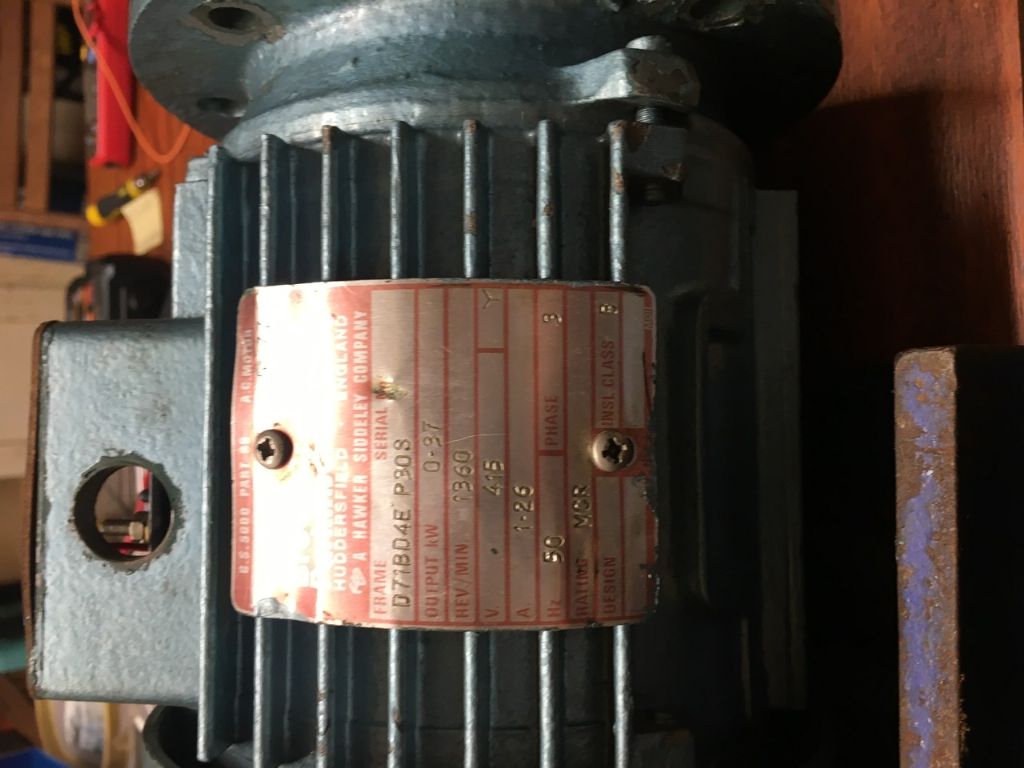

#1Vdf ( noisy one) has a panel indicated current of 2.122 amps and clamp meter measured 1.32, 1.43 and 1.11 amps for W, V and U
#2Vdf has a panel indicated current of 1.985 amps and clamp meter measured 1.44, 1.51 and 1.50 amps for W, V and U
All measured currents are above the motor plate 1.26 amps rating. Should I be concerned about this?
Would the significantly unbalanced outputs currents on #1Vfd be the cause of the vibration? I guess there is no way of balancing the output currents?

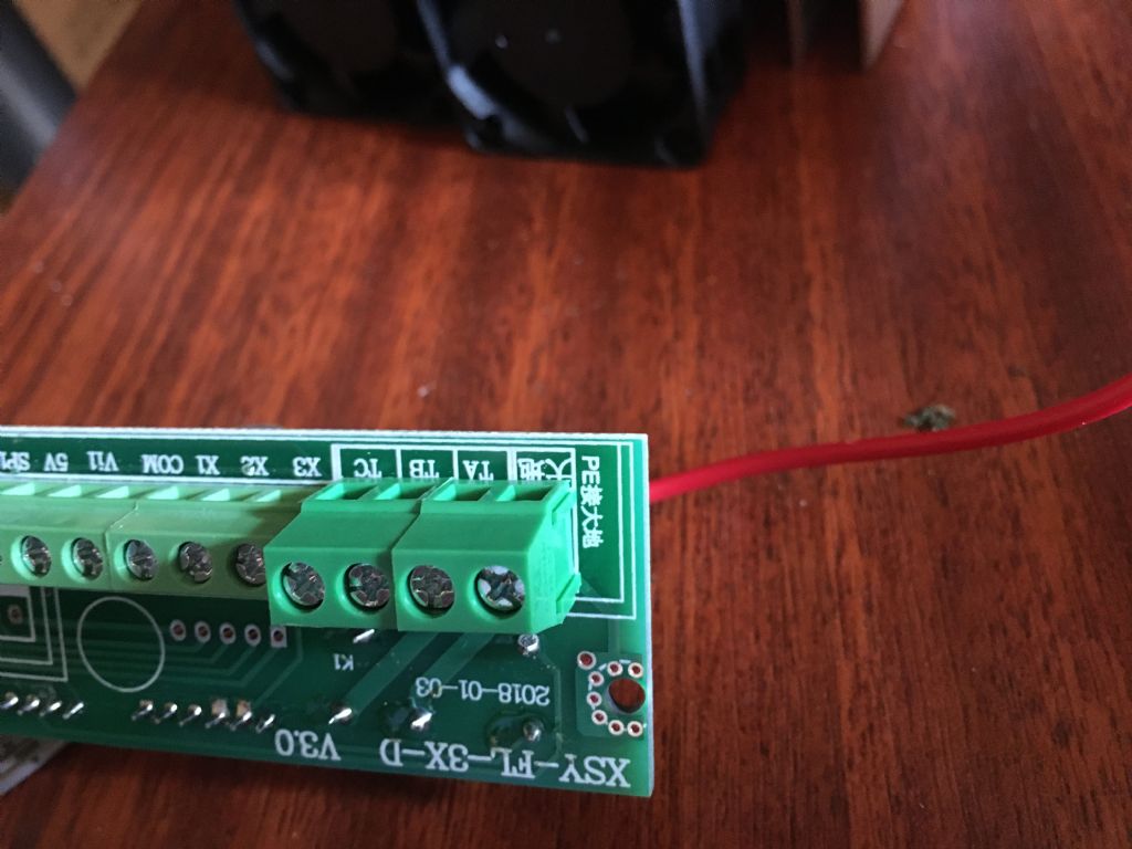

That’s interesting Dave because I get half max hz using a 10K pot.
My measured voltage across PE connected to mains earth is 3v. 10 times yours. I have an EMI filter on the mains input so will measure without it.

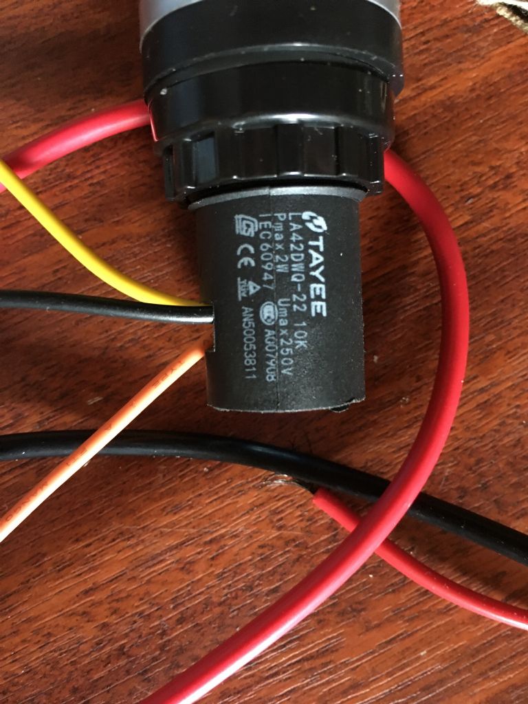

The pot I’m using.
24/05/2020 14:49:47
Many thanks Martin,

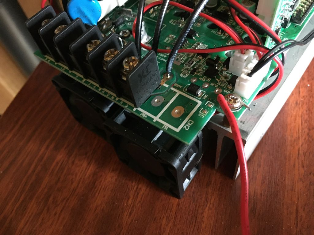

The PE terminal is quite easy to see when the board is removed from the case. There is a red wire that connects the terminal and the main board and then through the brass board supports to the fins
The pot is new with a measured resistance of 10.7K . It seems ok but I don’t have any others to swap it with - awaiting a couple from China. I have set P10 and P11 to 2.
I’ve checked the voltage between fins and a mains supply earth connected to the PE terminal and now get a reading of 3v ac down from 85v. Don’t know why it’s not zero but I guess one can live with 3v
I’ve gone through all the “as supplied” parameters (including those not listed on the manual) on one vdf and once I’ve done it for the second one I’ll post a list listing all parameter settings “as supplied” .
