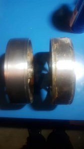

Dispite little interest, i'll continue my postings and hopefully as it progress it may be useful or of interest to someone else. I got myself a large metal bench the other day, and this has increased space to be able to work. So With the lump of box section, angle, and sheet that is my bench, I dragged it into position and laid all the parts out. Although this will be a long haul, I need to do some bits until I get my ML4 up and running how I want it. So trying to muster up some motivation, I set about with the wheels. clearing all the gunk off the rim with a mixture of files, emery cloth, and scotch brite to get rid of the rubber, metal set, and epoxy glue that the previous owner had applied.
Once its cleaned up ill get them in primer, so they don't corrode, then its onto making some tyres. I think its 1/16" less for every 1" circumference, for a tight fit, the rubber can then be profiled to a nice round corner shape, and hopefully will look like a vulcanised tyre, and also stay put when in use. The rears below will also have the same treatment.
The front axle is a bit of a no brainer, it wasn't set up between centres for machining so its a bit lopsided, also two flats where there should be a nice round profile is no good, so a new lump of steel acquired from the scrap bin at work, and ill be turning and milling a new axle happily soon, for free
Need to buy some ME taps and dies for the boiler, then also mill the stays parallel with the boiler. I also need to get round to finish assembly of my ML4, so I can actually turn something.
Set about the rear wheels, removing the timing belts that had been used as tyres. These had been stuck on with what looks like some kind of epoxy glue. However it's brittle in places, so I suspect that it would have fallen off on first use, anyhow I didn't like the exposed threads of the belts, so stripped them back.
After a lot of hard work, the glue was gone leaving just the surface of the rim.
Two wheels free from their timing belts.
Next job is to strip the paint off the rear wheels. Then get them in primer and make some new tyres for them all.
