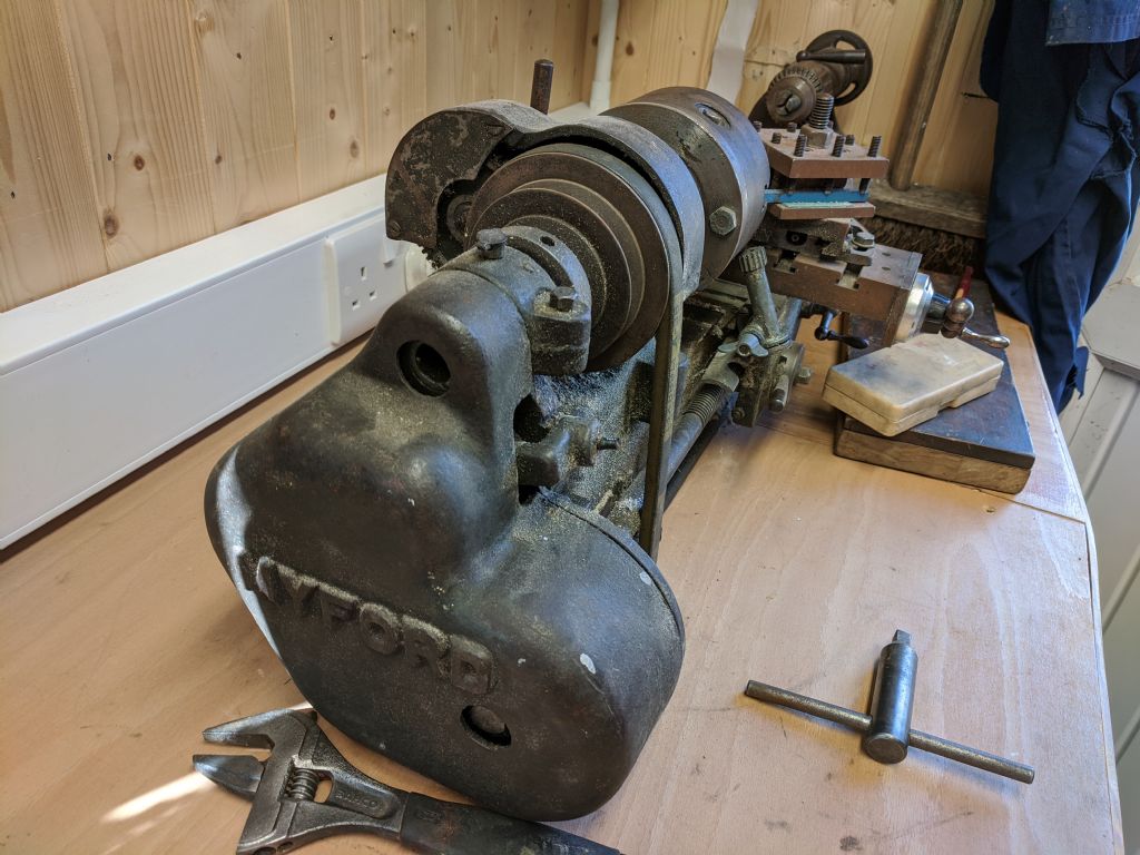

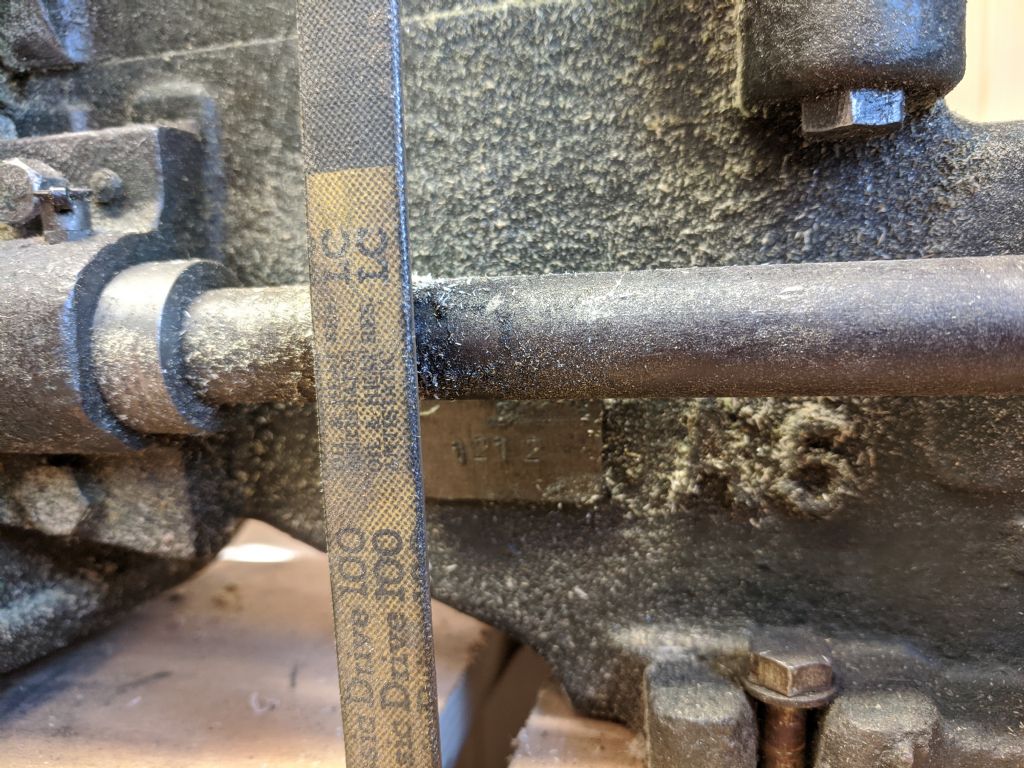

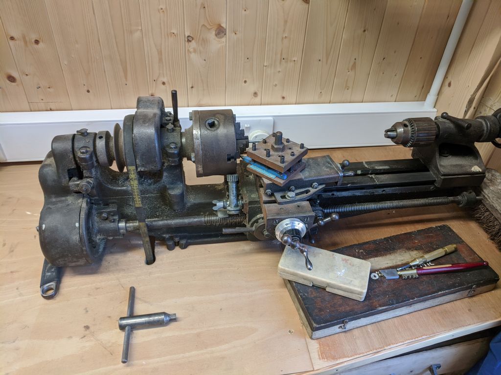

Devon Goldstone13/06/2020 17:17:00
2 forum posts
3 photos
Hi, my Myford (believe it is an ML2) of uncertain heritage has a serial number. I was about to start stripping and rebuilding when I noticed. Looks like serial number 1212
Howard Lewis14/06/2020 07:58:11
7227 forum posts
21 photos
It looks to be an interesting machine.
If it is a ML2, it will be 3.125" centre height. A ML4 would be 3.5"
The mandrel thread may give a clue as to its vintage, although with a machine of this age, after more than one owner, you can never be sure that it conforms to the original build list..
It looks to have have improvements over the early machines. The four way toolpost looks to be a later addition, as is probably the dial for the Cross Slide..
The covers for the gears are new to me, and unlike either of the two types shown on Lathes UK site.
Howard

Devon Goldstone14/06/2020 18:56:51
2 forum posts
3 photos
Centre height is 3.125".. its in bits at the moment though.... Trying to figure out how to fully strip
