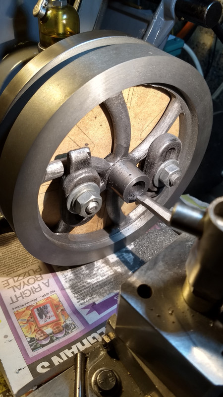

Pressing on with my set of castings for Centaur.
Today saw machining start on the flywheel, cuts well but as with some of the others I have machined they could have been a bit more generous with the material!
[url=https://postimg.cc/0b298PZp][img]https://i.postimg.cc/0b298PZp/Flywheel-inner-face-and-bore.jpg[/img][/url]
All finished one side and reamed the bore so need to remount to complete the other side.
I have made a slight change to the original design by increasing main and big end running diameters to 5/8 which looks a lot 'meatier'

Edit- sorry, photo didn't happen!

Looks good so far. I have just finish mine and have had it running on propane and petrol. I found that the carb spring needed to be a little stronger than the write up suggested!

Pete, nowhere near the carb build but thanks for the heads up!
Enjoying the journey so far - yours run ok?
Alan

Yes mine runs well and starts easy, I'm using coil ignition. Just a tip fit a non return valve in the fuel line (just a simple ball returning by gravity). I'm having a problem up loading photos but hope to in future.
