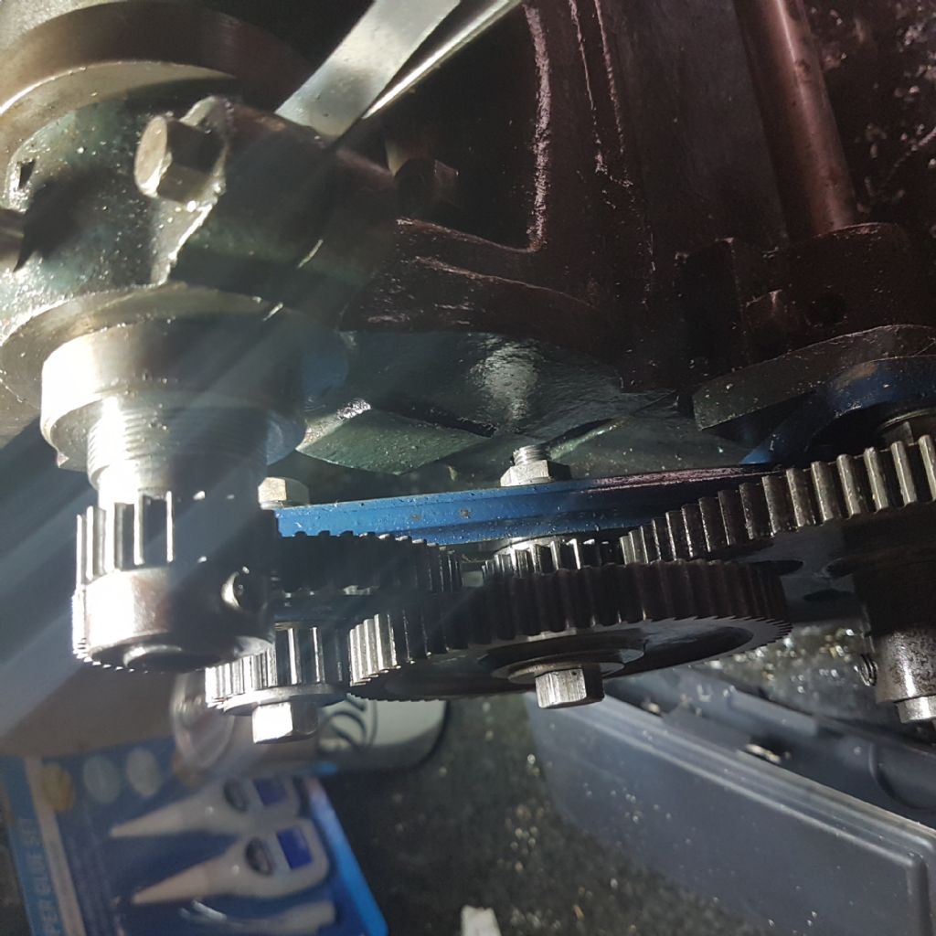

Can anyone tell me how the quill clamp works as mines not clamping?
Also the back gears won't stay engaged?
Any help would be greatly appreciated

The quill clamp should just turn towards you to lock up, clockwise.
To set the back gears up start at the leadscrew, and work to the spindle. Use some printing paper between the gears to set the spacing correctly while you lock them tight. Then bring the change gear arm to position using the adjuster nut next to the leadscrew. Again use some printing paper to set the clearance. No more or no less, makes for a quiet gear train with just that clearance. It sounds as though something isn't engaged properly or tightened enough. Just thought are the clamps tight at the back of the change gear studs?

Thanks Jon but i meant the gears in frount of the pulleys. The ones that make any gear setip go really slow. The lever is really stiff when in disengaged mode but ultra loose when engaged and the gears just get thrown appart.
The quill clamp rotates and handle tightens but does nothing to the quill.

It may be locked tight with grease or rust from a former owner. Remove the two screws by the handle which lock the retaining plates. Remember which went which side. Remove the handle.and the quill and inspect the lever see if it moves, it may need some leverage to free it but be careful as you don't want to damage the bore or the camlock.
The gears you refer to are the back gears. When someone says to put it in back gear now you know. The back gears don't simply engage. You need to do a few steps.
1. Unscrew the Allen grub screw in the pulley assembly
2. Screw the Allen key grub screw into the back gear, so it locates onto the flat of the spindle. (A light shining down the hole will spot this)
3. Undo the retaining nut that holds the cam shaft.
4. Engage back gears.
5. Tighten nut up to lock into position
Hopefully this helps with your situation.

To address Martyn's two problems; first the back gear. The lever operating that is fitted on a short eccentric shaft so that the gear cluster can be swung into and out of engagement. From memory I think it fits through a split hole in the headstock which allows a nip bolt to adjust the degree of clamping to prevent the problem you describe. Strip it out and clean it up, there could be a paint dribble affecting the fit on the eccentric and spoiling the operation.
Clamping the tailstock quill is done by the short handled lever on the front end of the tailstock which I think squeezes a pair of shaped plugs together that fit over the outside of the tailstock quill. Wear on one or both of the tapered faces allows the plugs to bottom out on each other and the clamping effect is lost. Extract them, turn or file down the plain faces next to the tapers to restore the clearance and refit.

Martyn very sorry about the confusion I've caused.
On your back gears!!! A 1/8" Allen grub screw and a 3/16 Whitworth spanner is all you need.
Undo the Allen bolt in the pulley.
Tighten the Allen bolt into this hole on the bull gear
Then undo the 3/16" Whitworth bolt on the cam lever
Bring into mesh and tighten bolt again, (note position of cam in below photo).
This is your change gears as I seem to be causing confusion I'll clear it up. Though my point on your photo is still valid, you need to change that 18Tooth gear on the tumble reverse for a 20tooth gear, so your tumble reverse does not effect the gear ratio.
Now your tailstock, as far as I am aware, (never had to investigate as mine worked). The tailstock is clamped into position  against the oppsite side of the bore, the handle on top operates another cam which then comes out from the side of the bore to push it against the side of the bore.
If needed I can strip mine down and take photos of its operation if you need me to.
