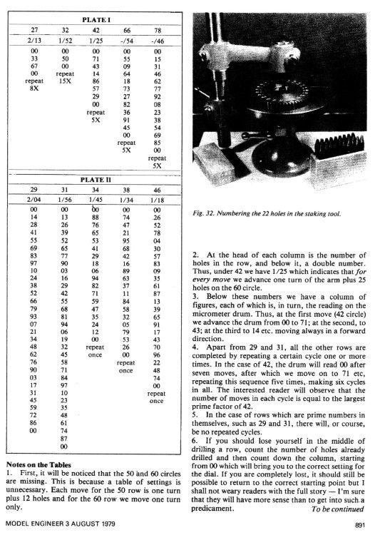

Robbo28/08/2017 21:53:26
1504 forum posts
142 photos
"Most, if not all, of the content appeared in ME first and it will be worth looking to see whether this area was correctly printed in the magazine" - ega
Here it is: neither 0 nor 9 but a dash.

Hopper29/08/2017 06:34:12
avatar
7881 forum posts
397 photos
Robbo, that chart you posted is correct. Thanks for posting that for future readers to refer to.
