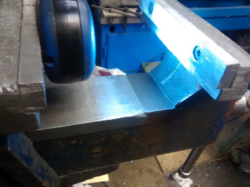

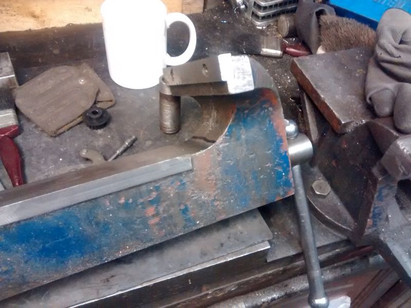

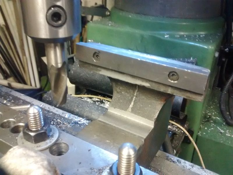

This pattern of vise is something I have known as a drilling vise all my working life, milling vises are more robust and the price reflects it. A very popular and cheap version was "The Nippy"
If the radius is a problem then fit a new fixed jaw with a small radius on the back but larger than the radius on the body.
It's not only machine vises that have this problem, a lot of bench vises have the same problem but on the moving jaw and not many realise.
You open the vise and put in two or three pieces of material all accurately lined up and tighten the vise only to have the front one ride up on the radius and put the job out of line.
The felt tip line is where the vertical is. In my case as this bench vise is never used for heavy work and usually has either ground smooth jaws fitted or smooth brass jaws, I just cannot get on with slip jaws and keep picking them up every fats end, I decided to mill a section out and inlay a piece of gauge plate to increase the parallel part.
Nice tight fit and a dab of superglue and jobs a good in. In my case it hasn't weakened the vise as it's always used well under limits. I have presses for fitting tight bushes and vises with heavy grip jaws on the welding bench for heavy crude work.
