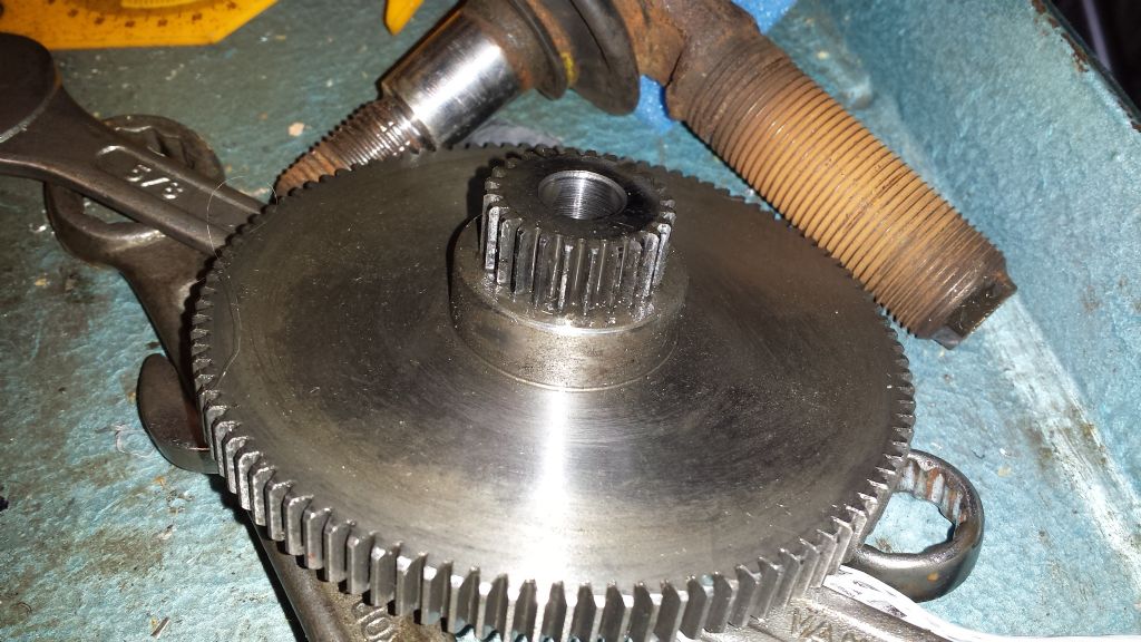

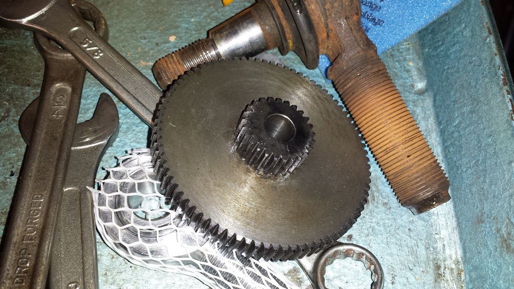

On the lower stud(2nd stud?) is another compound gear with MOD1-80 written on it.

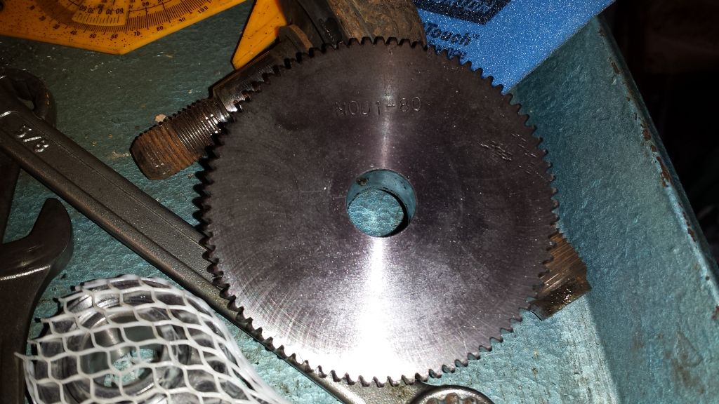

And on the leadscrew is a single gear with MOD1-80 written on it.

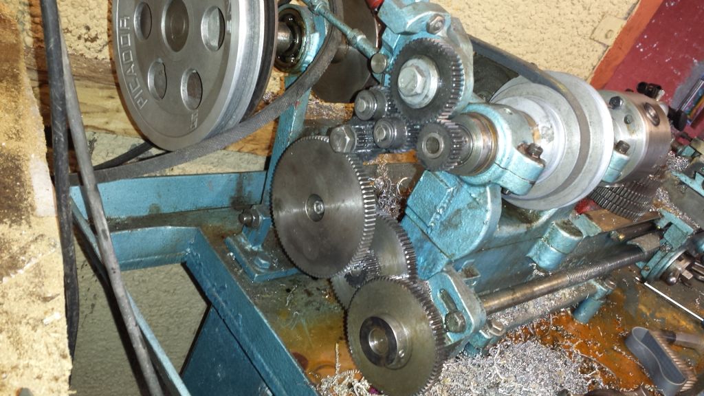

This is how they are arranged,
Also the diameter of te 1st and 2nd studs are much smaller than the holes in my change gears is there supposed to be some sort of bush I should have?

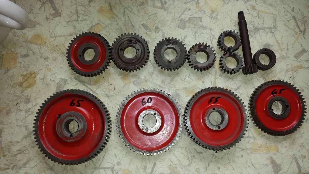

Here are my change gears.
If somebody could help me understand what gears I need and where/how to fit them I would be very grateful as I have been brought to an abrupt stop with my little project

The 'MOD' gears you have are NOT the same a the rest of the gears. The holes and pins for locking them together should be a clue. They should clearly have different teeth sizes and don't try to run them together.
ML 2 is NOT the same as ML7. The early Myfords used the same 14DP gears a the Drummond. Only for later models were the smaller 20 DP gears introduced.
DP is Diametric Pitch (which google seems to want to call Diametral Pitch). It is a standard measuring system for gears used in imperial units. Mod is short for Modular which is the standard for metric gears. Look them up.

Myford used 20 DP cast iron gears, with steel as the material in 20T and 25T gears, being a lot stronger. As others have said, they are linked by pins in the lower part of the gear. The gear bore was always 5/8 inches [0.625]
Ideally you need two working gears in the chain, a 20T as the mandrel gear [the one sharing the reversing gear cluster] through two idlers [size immaterial] to a 50T wheel on the leadscrew. That will give you the right gearing for a 20 tpi pitch thread. It would pay you to get a 50T wheel from Myford, or find the one you the missing one, you will need it frequently and make your own pin drilling in the wheel boss. It will come with a keyway, but that won't matter.
Certainly, Myford did not use module gears, the pressure angles don't match and the nearest size to 20 DP is 1.25 mod. Even that would won't mesh well so your 1 mod wheels won't mesh at all with the Myford wheels you do have. I would sell those on ebay, they are effectively useless for this lathe.

OK I'm a little concerned now add more than one person has said that the MOD1 gears won't mesh with the standard gears for my lathe. However they were fitted when I collected the lathe and I've been using it like that ever since. Does that mean the tumbler reverse gears are also MOD1 type and will also need removing?
Martin Kyte25/05/2016 12:24:50
avatar
3445 forum posts
62 photos
Sounds like you do need to go through and find out exactly what each gear you have is.
Any Module 1 gears will mesh with any other module 1 gear and any 20DP will mesh with any other 20DP.
The operative word is mesh. I assume that your first gear is just going on the tumbler gear shaft and doesn't mesh with the tumbler gears. In that case it does not matter what is in the change wheel train so long as they are all the same pitch.
Think screw threads if you like. you cannot put a 1/4" BSF bolt into a 1/4" BSW nut. The BSF is 26 Threads Per Inch and the BSW is 20 per TPI so they dont mesh and lock up part way in. Gears are exactly the same. The previous owner of the lathe may well have machined up some gears with tooth numbers he didn't have for a job and only had a Module 1 cutter to hand. So long as you mesh same with same that is fine just a little confusing when you receive a box of bits with a lathe you have just bought.
Module 1 is 25.4 DP so will not mesh with 20DP or if they do they will not mesh correctly.

Don't ger rid of your Mod 1 gears! They look very useful. It is entirely possible, and indeed was not unusual practice in the days before the cornucopia of cheap internet tools were upon us, to use gears of two or more modules or DPs to construct a gear train.
It looks like the Mod1 gears you have are set up to provide a nice fine feed for turning, finer than the standard Myfrod gears would provide. It looks like the Mod1 compound gears with the 100T and 80 tooth and 20tooth gears coupled together mesh with a Mod1 gear that has been attached outboard of the original 20DP output gear on the reversing quadrant.
So keep your big and little MOD1 gears and use them meshed as shown in your pic for nice fine turning feed.
For screwcutting, use the original 20dp gears but set up to mesh with the inboard gear on the reversing mechanism's output shaft. Plenty of Myford 20dp change wheels come up on Ebay UK every week. So you should be able to buy one for a few pounds. Or keep using the compound gearing app you have already discovered.
And if you get Martin Cleeve's excellent little book "Screw Cutting in the Lathe" (workshop Practice series, Tee publishing) he has a chart in there of how to cut metric threads using your standard change gears on an 8tpi leadscrew lathe. No need for fancy 127T gears or the likes. Just the magic of compound gearing.
YOu may even be able to use your MOD1 gears for screwcutting in combination with the 20dp by using compound gearing. You have to be able to put a MOD1 gear and a 20dp gear on one stud as a compound combination, then the rest of the train is made up of MOD1 gears that mate up with one of the compound gears, then the rest of the train is made up of DP gears that mate with the other gear on the compound pair.

Out of curiosity I dug out the change gears and the quadrant etc to take a closer look. I was surprised when I cleaned off all the dirt that the big gear which normally fitted on the lead screw is a bit odd. I had measured it some years ago before storing everything away. It has what looks like a makers name cast into the side, seems to be PK and the other side has the number 112, presumably the number of teeth. But on looking more closely it actually has 90T and they are not 20DP. After faffing around a bit they seem to be either 16DP or 17DP depending where on the teeth you assume the pitch circle is. My assumption is it is a 16DP as odd number were considered an "oddity". I wonder if the previous owner used a 112T and machined the teeth off to cut new ones? There isn't a lot of metal left on the rim and that suggests that is what they did. The gear does have a key way but someone had fitted a sleeve to adapt to the 5/8-inch lead screw stub shaft.
The other smaller gears are definitely 20DP, same as the Super 7 ones and they are interchangeable. I have a fixed compound gear set that goes between the quadrant gears and the large 112/90T lead screw gear. Never noticed they were different! The age of the lathe predates Mod gears I think?

Also, can you post a few more pics of that reversing tumbler set up? It looks different from other ML2 ones I have seen and might be something the old engineer set up himself. So you might want to check that the gears on the mandrel and the reversing tumbler are all 20dp and not something different again that he set up from whatever was in his scrap box! Or as John has suggested above, maybe that's the way they were copied from Grayson with varying DPs to suit whatever needs they had in manufacturing.
