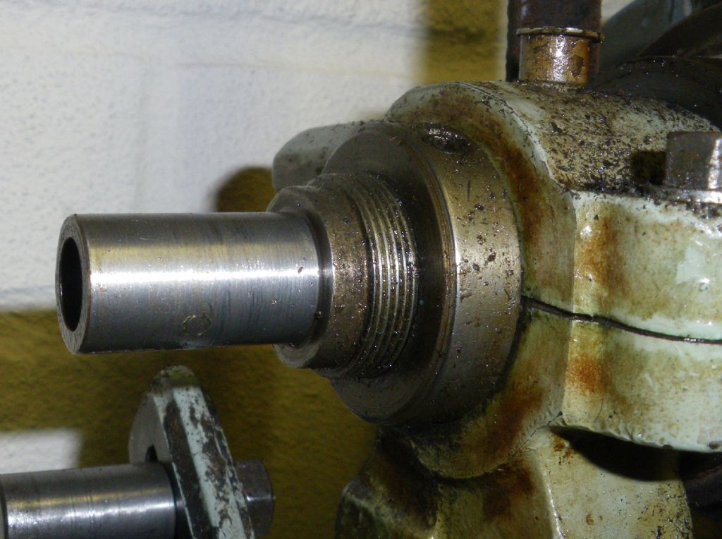

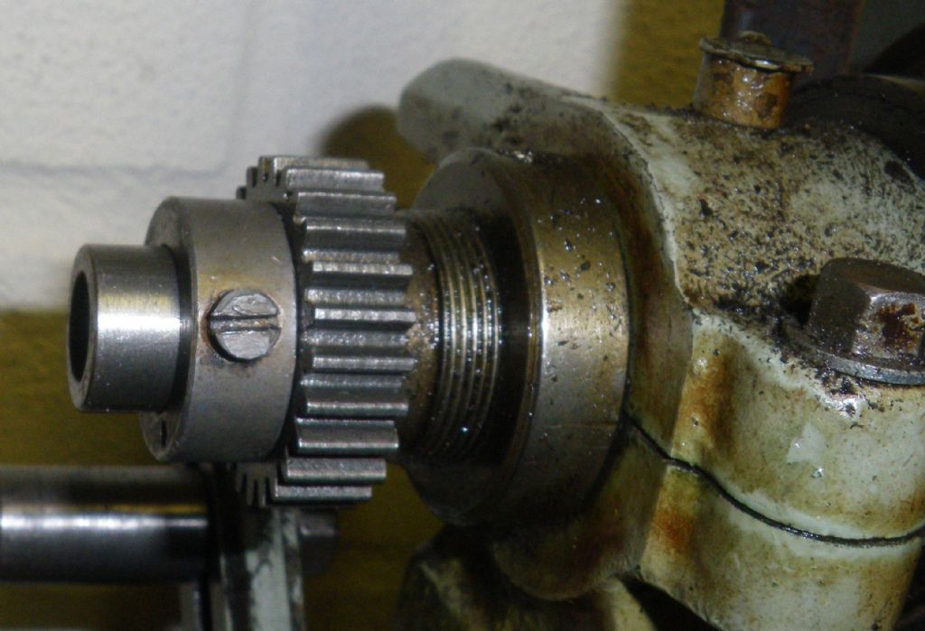

I presume from your mention of tumbler reverse that you have the later ML4. On this the 25T mandrel gear (a name I just made up) is internally threaded. It is screwed onto a fine thread at the end of the mandrel:
ML4 mandrel gear 2
It is then held in place by a grub screw threaded axially into the joint between the gear and the mandrel:
ML4 mandrel gear 1
This works well until you need to dismantle the headstock, as it is a real fiddle to get it aligned again. The gears occasionally appear on a well-known auction site, but you could wait a while to see one, and of course you would need to drill and thread anew for the grub screw (2BA at a guess). There's no technical reason why you shouldn't bore out and thread a standard 25T wheel, except that without the mandrel gear your present lathe can't be used for cutting the thread.
Incidentally, the earlier ML4 without tumbler reverse had a smaller diameter mandrel, and the mandrel gear was any suitable changewheel slid on and pinned to a drive collar in the ordinary way.
As far as your taper bearing is concerned, it sounds as though somebody has fitted (or attempted to fit) a mandrel from a ML7-R or Super 7. I have no idea how the mandrel gear from those is fitted, so it may be different from the original ML4 arrangement I have described. Perhaps the knowledgeable ones could chip in at this point? Using a 7-series mandrel would certainly give you the 1 1/4" diameter register behind the nose thread, which wasn't present on the ML4.
The extra quarter-inch overhang will reduce the rigidity of your lathe (which in any case is not great in the ML4) but I don't know how significantly.
Do keep us informed about how you solve the gear problem.

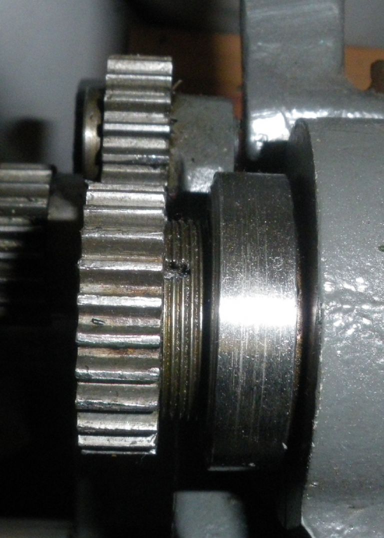

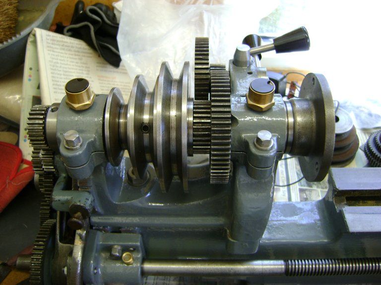

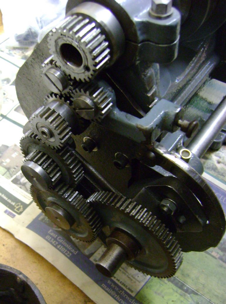

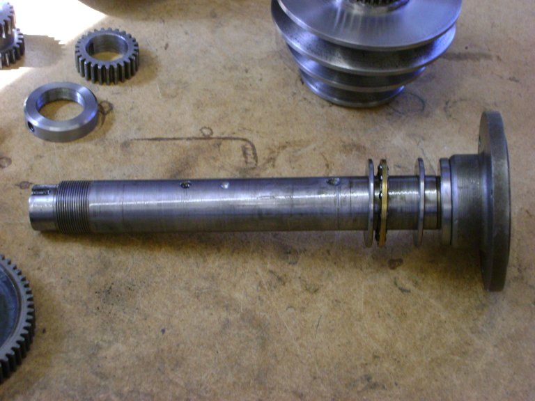

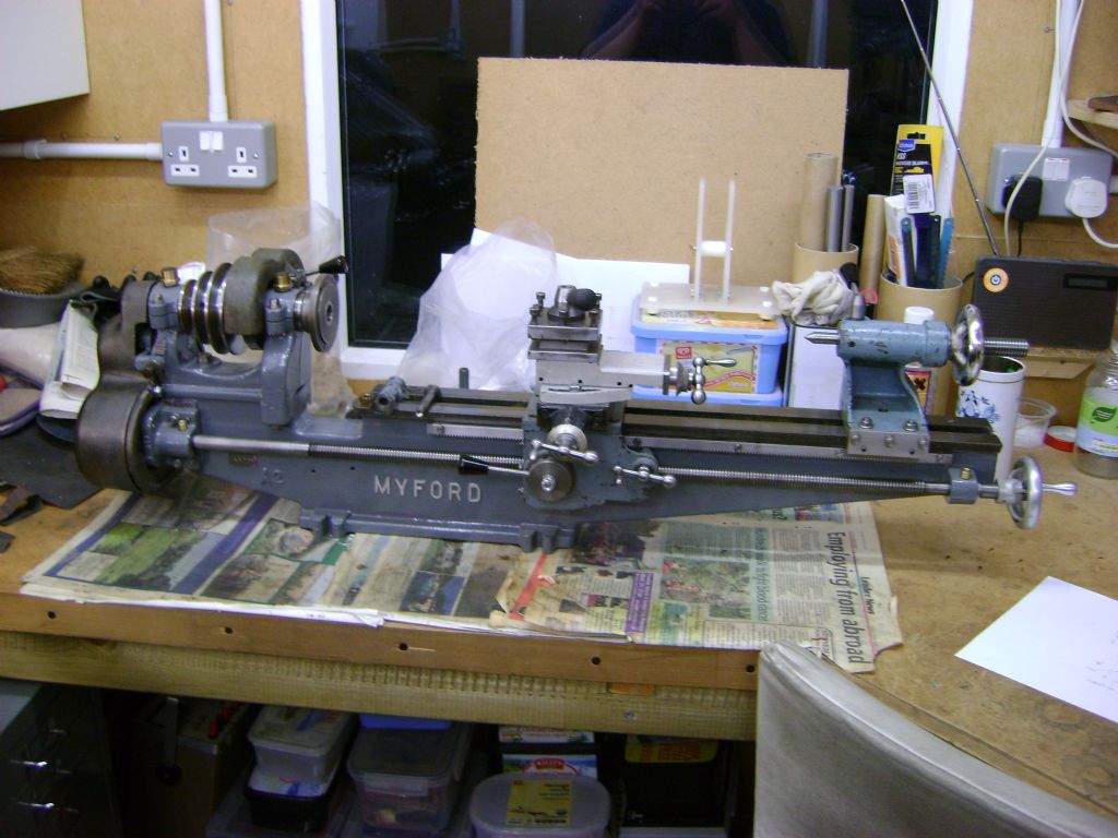

I have an old ML4 which I am refurbing.
On mine the first gear in the chain on the spindle is *not* threaded. It's just a plain push fit. The grubscrew is all that holds it in place.Slightly further along the spindle, is a threaded section with a nut. This nut provides preload for the thrust race immediately behind the nose for faceplate and chuck mounting at the other end. Even though the gear has threads in the near vicinity for the preload nut, there is a smaller plain section with a shoulder against which the back of the first 25 tooth gear rests.
It must have been like this from the factory because the gear is marked with a stamped number across the divide between the gear and the spindle. If someone modified it to remove the threaded portion after the factory they couldn't have made the hole in the gear smaller, nor is it likely they would have stamped it with a number and erased the original. I can only think that they were all different, and this is not the first time I have come to this conclusion about the ML4.
I've modified many things on mine but this is not one of them. Someone else may have modified this after the factory, but I am certain that almost every one of these machines is a little diffferent anyhow. The difference between the ML2-ML4 is subtle and certainly not a precise science. Some things were clear differences, but other not so clear.
I've attached some pictures, in case it helps;

thanks and nice looking lathe mate , im now confused is my mandrel thread stripped or is it just rough on the end of shaft ? where its been messed with ,I think mine should look like that push on and a grub screw in the end because theres signs of threaded slot ? the same kind of end gear is available for the ml7 series but the bore is bigger ,now my brains ticking over ,if I cant get a ml4 gear could I attempt to clean the mandrel end up then cut a keyway in it with a dremel then make a slotted bush to fit the ml7 gear ? maybe to much and not enough meat on the mandrel .?

I'm afraid I can't get any more pictures until Thursday. I am away from home and the machine is at the other end of the country. I'd be happy to dismantle the headstock and take some pictures then, so that you can get a better idea of what you are doing. My machine is only loosely assembled because I've not finished the refurb yet. That makes it easy to dismantle.
The only really important thing with the ML4 headstock is the main bearing adjusting screws.
* Don't over-tighten them.
The headstock has split plain bronze bearings and they are pressed into the iron headstock casting which is also split. I guess they thought that they would wear and might need adjustment. The trouble is when you tighten the bolts across the split. It's way too easy to over tighten them and then the casting breaks. You often see these machines on e-bay where the headstock has been modified (ugly) to fix this problem. If you get a chance make shims with holes for the bolts and put them in the slots. That way you can prevent over tightening. The shims could even just be washers if you can find the correct thickness.
To dismantle the headstock;
Remove the grubscrew (2BA) on the end of the spindle and then remove that 25T gear.
You can then undo the grubscrew in the screwed preload ring behind the gear; then unwind the ring and remove it.
Loosen the main bearing adjustment bolts.
The pulley and bullgear are both attached to the spindle with grubscrews. Both need to be unwound by a few turns. The ends of the grubscrews are pointed and conical seats will have been machined into the spindle. The point of the grubscrew needs to be withdrawn to clear the conical seat completely. If the point is sticking out it will feel loose but will raise a burr on the spindle when you withdraw it. The burr will in turn damage the bronze bearings when you finally withdraw the spindle. If you can just remove the screws completely it is much better.
The screw for the pulley is usually in the middle position for the belt. The screw for the bullgear goes in at a diagonal to the spindle. The screw is on the spindle nose side of the gear. If you line it up with the notch in the back of the front bearing, you'll get a screwdriver to it better.
Remove the backgear cover, so that you can support the bullgear when you withdraw the spindle.
Initially, just support the pulley with one hand wilst withdrawing the spindle with your other. When the pulley clears, remove it, then support the bullgear. Usually when the bullgear clears the spindle will be more or less free to remove anyway.
Don't loose the bits!!

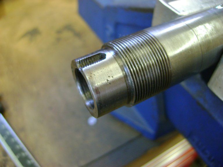

Back to the mandrel gear: Andy, your serial number looks like 871, which makes it newer than mine which is 619. It looks likely that they changed the design between them, shortening the threaded section and sliding the gear onto a plain section. It would certainly make alignment easier when replacing the gear on the shaft. Wayne, is there a serial number on yours?
For completeness, here is the arrangement on an early (pre serial number) ML4 with no tumbler reverse and the very narrow bore mandrel with 7/8" nose thread. It has the same threaded collar arrangement for bearing adjustment, and a plain turned section outboard of that (in two diameters).
The changewheel - any changewheel - simply slides on and is pinned to a drive collar with the usual 3/32" silver steel pin. The drive collar is secured with a 1/4" BSF grubscrew. I have never had any problem with it slipping:
This is not a Myford mandrel, so the extra length to the left of the drive collar may not be to the original design.
Incidentally, the exploded view of the ML7 headstock on Myford's website shows a plain section outboard of the threaded section on the mandrel, so it seems likely they carried that arrangement over from the ML4 as both simple and satisfactory.
George

Andy Ash02/05/2016 11:01:25
159 forum posts
36 photos
Hi George,
You're quite right. It is a problem, it's a long time since I had to go through what you dscribe.
I've had the machine since I was eleven, and I'm now in my mid forties! Granted it spent a long time as parts in a box, but it seems to have stood the test of time. I learned to turn on that machine, I got ten years use out of it.
I'd forgotten that I had to drift the spindle out with a hardwood block and a 'mer. The bearings are original, and it is still fine, so I guess I was careful enough.
I think this stirred a braincell or two actually.
So, when you remove the spindle, it comes out through the bed end of the headstock. Also it is worth looking out for burrs raised by the grubscrew on the preload ring behind the 25T gear. Obviously that grub screw bears directly on the screw thread, and that's a little nasty. If a burr has been rised on the thread there, then it will be good if you can take the burr away with a stone, or a diamond file. The benefit is that you don't then drag the burr through the bronzes.
The same philosophy is true of the pulley grub screw that would need removing to engage the back-gear. Obviously you need to remove that to extract the spindle, but if it has not been properly withdrawn when the backgear was used, it will make a mess of the spindle, which can then damage the bronzes. I doubt you will be able to get at the damage unless you remove the spindle, but if you get the spindle out, you should certainly tidy it up with a stone.
I'm really not sure about the wisdom of the tumbler reverse anyhow. The machine should cut a right hand thread well enough, but the thrust race only copes with forces into the headstock. Any operation which requires resistance to a cutting force away from the headstock is not adequately managed by the design of the lathe. This includes turning operations away from the chuck and cutting left hand threads.
The preload ring does rest against a shoulder on the bronze headstock bearing, but there is no way it is as good as the thrust race on the nose end of the spindle. I guess it's woth being mindful of that, especially if you are a user of a vertical slide, and you use the side of a milling cutter often.
These old lathes are often quite limited, by comparison with newer machines, but you can still produce excellent work if you understand their limitations.
P.S. Mine has matching numbers on the bed, under the saddle and on the tailstock. It also has a small aluminium plate which I think indicates that it was owned by the Air Ministry. There is a number, and a small crown. There are letters around the crown, "P P" either side above, "A M" either side below the crown. I always wonder if mine actually shot down an ME109!

So I posted some more pictures to my album that might help you.
The ones below are examples;
The spindle is 1" in diameter, and as best I can tell the thread on the end for the pre-load nut is 1" x 24TPI more than likely Whitworth form. The shoulder on which the gear sits is 7/8" in diameter and 1/2" deep.
The distance from the shoulder at the back of the spindle, to the collar which rests against the thrust race is 6 15/16". That is the full length of the 1" diameter part, including the part of the 1" diameter which is threaded.
The actual nose is the same thread as my Super7 but the register on the Super7 is slightly larger. I think the thread is something like 1 1/8" x 8TPI. All I know is that I can put chucks from the 7 onto the 4 but not the other way around.
I've not provided dimensions for the bronzes because I'd have to push them out to measure them. I don't want to do that.
In the end you're going to do what you will, but I wouldn't recommend making new bronzes yourself if you only have the one lathe. The bronzes need to be made with their bores under-size. Then you fit them, and line bore them to size with a "between centres" boring bar. You mount the headstock to re-manufacture on the vertical slide. This way ensures concentricity of the two bearings.
If the bearing you are to eliminate is the thrust race in the pictures I have shown, then I'd suggest that you want to keep that one. In any case if the thrust race is pitted or otherwise damaged, a decent bearing supplier will be able to get you a replacement.
If anything, the desirable change, is to machine into the back of the rear bearing mount. Obviously you would reduce the length of the rear journal, but if you make it the same as the front one, and put a thrust race in there, you can turn right and left hand threads without any problems.
I might be able to do this on my Super7 with my boring head, the same as the line boring, but I just don't feel tempted. Too little gain vs. too much risk of error. You might be able to find someone else that could do this for you. Many of these things are possible on smaller machines, but they become reliable and procedural "small jobs" on bigger machines, like a Bridgeport or a K&T.
Edited By Andy Ash on 05/05/2016 13:36:25
