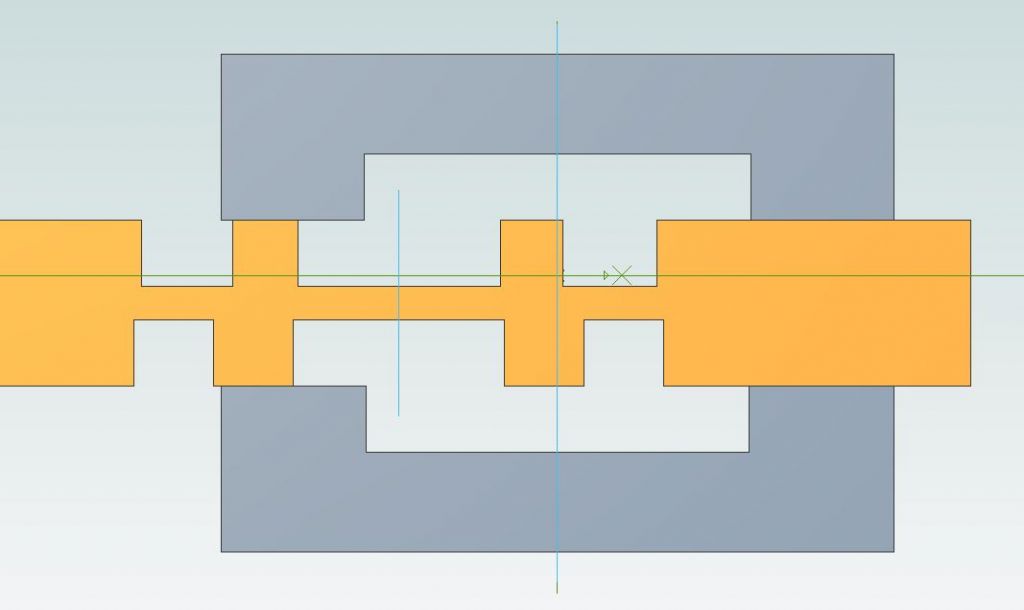

Right here we go.
First sketch is what you currently have on the top and the book sizes at the bottom with valve at the mid point.
And now at full valve travel. With the large amount of lap and the overall width of the ports not being that different you will get fairly similar running. I would be inclined to leave as is for now.
If you do find it won't run well then it is not too hard to change the valve at a later stage, this has the top valve reduced in overall length an the cavity reduced, at mid point
Part way along the inlet now opens at the same time as the drawing version
And at full eccentric throw
If you do decide to alter it then the overall needs to be 19.78mm and the cavity 10.34mm, you could solder in some metal to reduce the cavity of just make up a new valve from scratch.

I'm really surprised that it would still work with the valve not fully covering the exhaust when in mid point, but that's why I'm not an expert but I do need to learn how it all works.
I will leave alone for now then and see how we go, are you saying that the cylinder block will be fine and the only thing we would need to change is the valve itself? which of course would be a lucky escape for me.
many thanks again for taking time to look into this for me.
derek blake31/01/2019 08:45:34
586 forum posts
151 photos
what I have found is the valve casting cavity is actually oversized compared to the drawing anyway, and that was without me even touching it.
I guess the casting just wasn't very good.
JasonB31/01/2019 08:49:31
avatar
25215 forum posts
3105 photos
1 articles
Yes the cylinder can be left as it is. You may loose a bit of economy and power but the little Allchin is not the type of engine that is going to be rallied every weekend and expected to do road runs.

Just one last question, if you wanted to use the valve casting I have but reduce the steam cavity how would YOU go about it?
Thank you in advance
JasonB31/01/2019 09:31:25
avatar
25215 forum posts
3105 photos
1 articles
You could silver solder a piece of similar metal into the cavity.
Probably even be OK to use something like JB Weld to build up the edge and then that is easy to trim back to size, should take the temperature OK.
Another option would be to file off the lower half and then make a new piece with a suitable hole in it and then silver solder that back onto the top half. I've made a few valves that way.

Right ok I'm with you, the steam cavity itself has an angled curve within is that critical and must match drawing? sorry for all the questions but trying to learn.
JasonB31/01/2019 09:43:43
avatar
25215 forum posts
3105 photos
1 articles
Does not have to be shaped

Posted by derek blake on 31/01/2019 09:33:57:
......the steam cavity itself has an angled curve within is that critical and must match drawing?
I wouldn't think so. The cavity only controls the exhaust, steam inlet is controlled by the outside edges of the valve. In theory you might want a small radius on the internal corners of the cavity to reduce turbulence. But in models where efficiency is unimportant it's not necessary.
