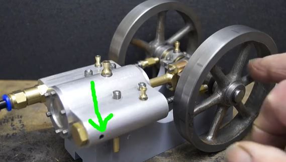

The Muncaster wheels arrived, amazed at how clean the castings are..excellent.
JasonB03/04/2020 16:17:40
avatar
25215 forum posts
3105 photos
1 articles
Is that hole open?
Also make sure the brass fittings don't have too long a thread which could be blocking the hole from cylinder to valve chambers.
Edited By JasonB on 03/04/2020 16:20:16
Ron Laden03/04/2020 16:42:13
avatar
2320 forum posts
452 photos
No Jason it has a M4 grub screw locked in there and I will fill over the top on finishing. Also the fitting threads are short of the cylinder hole.
