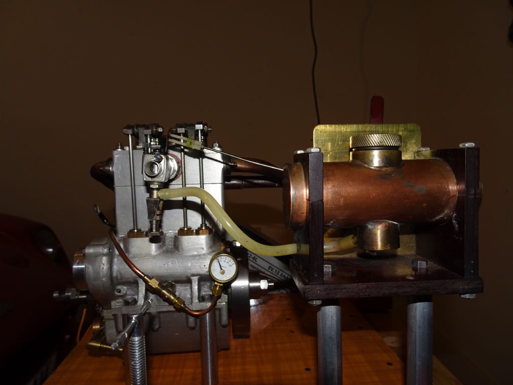

Andy Cameron06/10/2022 10:01:56
53 forum posts
2 photos
The attached photo shows the bottom of the tank is just below the carb intake.
Roger B06/10/2022 10:36:48
avatar
244 forum posts
105 photos
That looks to be a reasonable set up as long as the tank is less than half full.
The system will prime if you choke the air inlet but does not seem to get enough fuel to run. Could there be an air leak between the carb and the cylinder head? Have you checked that the needle moves in and out of the jet and that there are no obstructions.
Andy Cameron06/10/2022 10:44:35
53 forum posts
2 photos
Yes if i open the throttle fully and block the ventura it primes well, so i assumed no leak. I did notice when i tried with the tank connected and very small amount of fuel i.e. the tank level will have been below the carb inlet. That when it fired i watched an air bubble in the fuel line which didnt move i.e. no fuel flow to carb. I do remember on RC aircraft glow engine setups that the fuel tank was pressurised off the exhaust. Is it possible that under running there just isnt enough vacuum to syphon fuel up from the tank.
Roger B06/10/2022 11:17:57
avatar
244 forum posts
105 photos
There should be sufficient vacuum unless the throttle is open too far. This is a similar carb and tank set up on my 12cc twin. It needed an initial prime with the air intake blocked. After that the fuel pipe would stay full for a couple of days.

JasonB06/10/2022 12:51:42
avatar
25215 forum posts
3105 photos
1 articles
Is the breather hole in the tank clear?
Looks like it has just been fitted with a model RC engine carb that may be better suited to higher volume of air through it rather than what a slow reving 4-stroke will pull.
Also be wary of running what looks like silicon fuel line with petrol a sit will swell the tube and also soften it. Over time a sticky sludge can build up as the silicon is dissolved. Change to the yellow "Tygon" fuel line

Andy Cameron06/10/2022 13:18:47
53 forum posts
2 photos
Tank breather is clear, you could be onto something with the carb as i know from some notes that came with it that starting is best at needle at 1.5 turns out and throttle at half then once running set needle to 1.25. I was thinking of filling the tank to just above the carb inlet, prime the carb. Then pinch off the fuel line, get it running then un-pinch the fuel line to see what happens.
Andy Cameron06/10/2022 14:44:07
53 forum posts
2 photos
Ok ureka she runs and even throttles up. All i did was fill tank and start after priming and away she went, the throttle setting is critical to start, very smoky but it was probably running very rich as needle was 1.5 out.
