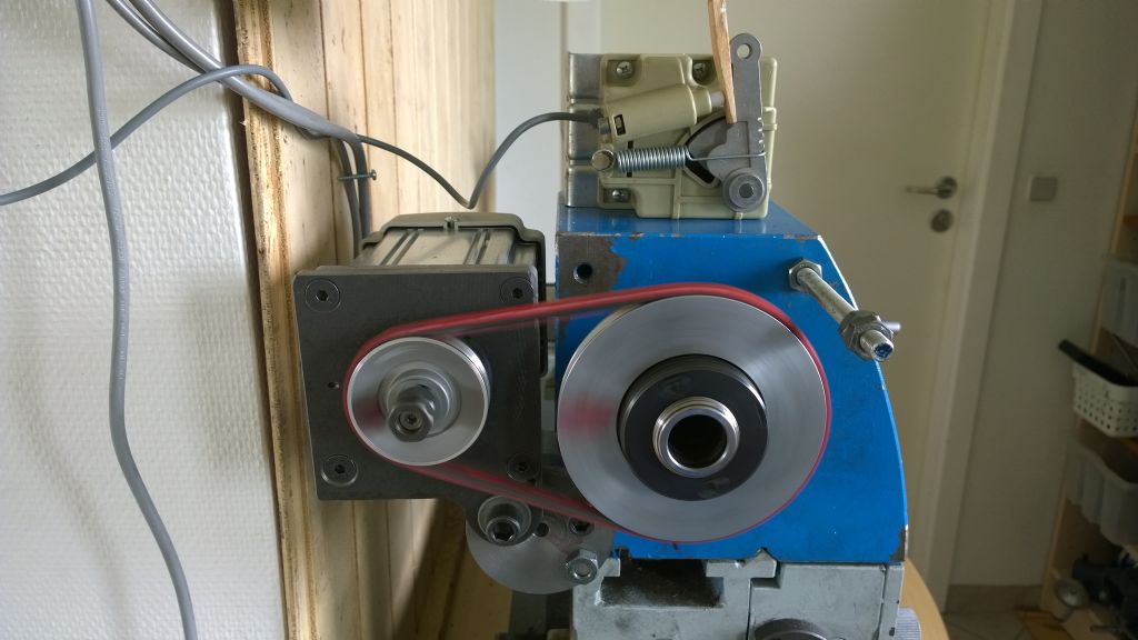

Niels Abildgaard19/06/2022 18:21:22
470 forum posts
177 photos
Posted by Niels Abildgaard on 08/03/2022 20:06:52:
Posted by Clock polisher on 08/03/2022 17:12:46:
Good evening,
I have uploaded the four page manual for the motor to my album.
regards,
David
Thank You.It is same leaflet as for both my 600W and 1500 W version.
I have really tried to change ramp up and down speed and have not been succesfull.
When some reader here succeds please make a Youtube.
I seem to remember that programing a HuanYang was difficult as well
The order of adjustments was not unimportant.
Maybe same procedure here.
Do not fool around index P4 step and we will not destroy anything.
Edited By Niels Abildgaard on 08/03/2022 20:12:00
Heureka
Program step 08 has to be set at 0 and motor coasts to stop.
Much nicer than before where it happened instantaneously.
The Hall sensor thing is interesting  and I cannot se how it can be dangerous unless the three lead cable is penetrated by a sharp metal edge.
I plan to maneuvre it with a hand-twist gearchange from a moutain bike with quick release.
When belt is really thigth I cannot stop the spindle 125mm flange doing 50 rpm with leather gloves on
Edited By Niels Abildgaard on 19/06/2022 18:25:39

Niels Abildgaard08/05/2023 19:59:42
470 forum posts
177 photos
Quite some tests of how to instal and use the sewing machine Hall sensor has been made before I found a solution I am satisfied with.
A high resolution picture here:
Sewing motor control
Only problem is that the link below picture offers something much better and cheaper.
