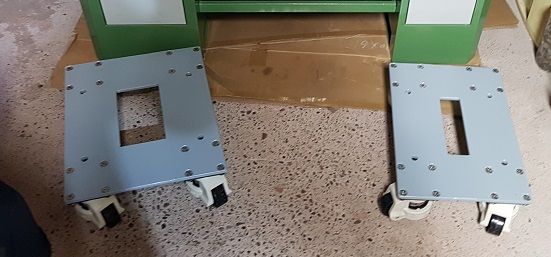

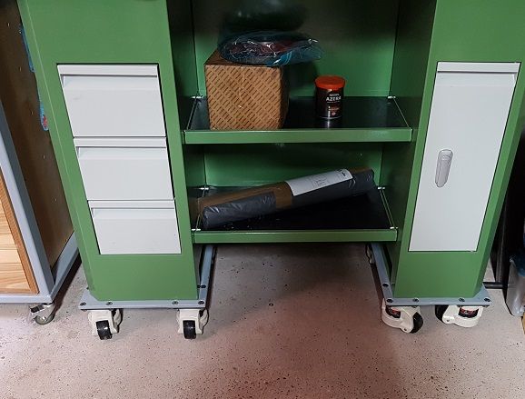

They are off Ebay. I think they are a clone of the originals.
I do not know if I can post links on here, but a search for Heavy Duty Machine Levelling Castors will find them.
I made a bandsaw stand earlier in the year to see how good they are, and they worked well. It is a pain to wind the feet up and down so they are not a solution for anything you expect to move regularly, but for a machine that you may have to move occasionally I think they are ideal.

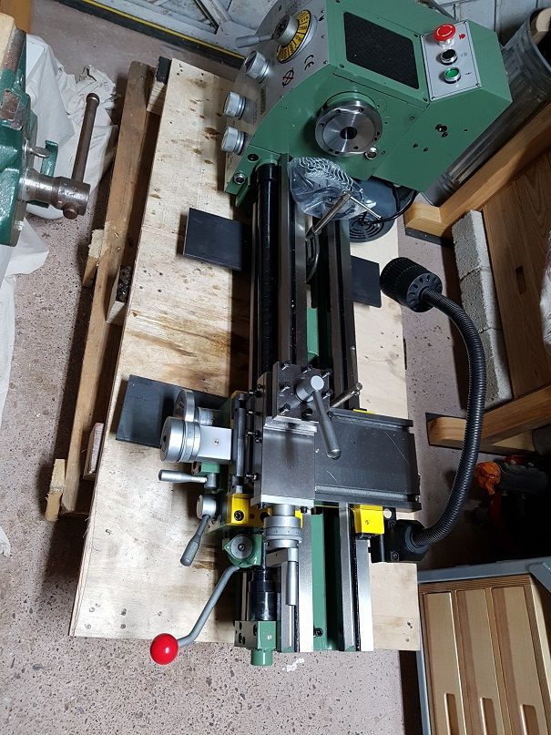

I have had a good week...

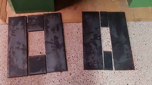

Steel for bases arrived:steel1.jpg
The bases were made and bolted to the cabinet.
Covers and guards were removed and steel was clamped under the lathe for lifting handles.
With help, the lathe was then lifted onto the cabinet:
It is good to see it on there.

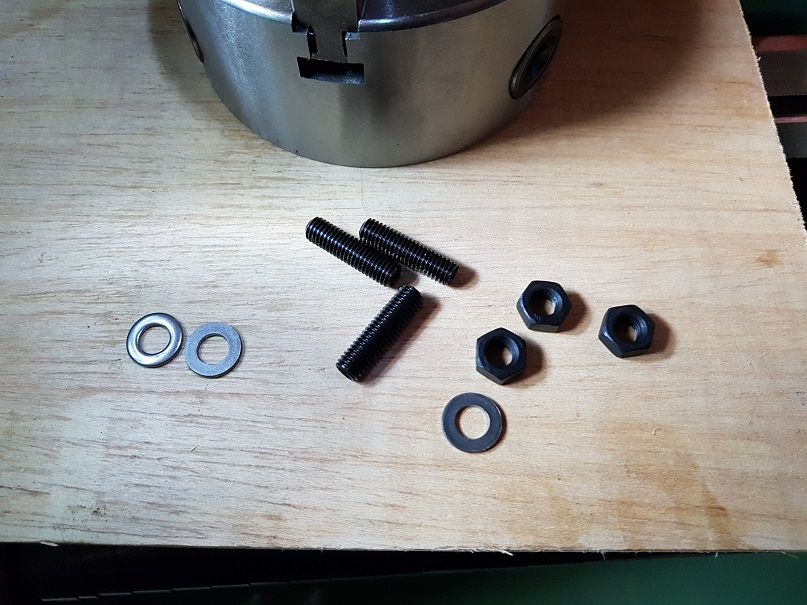

I also purchased some grub screws and nuts to replace the bolts that hold the chucks on. Now there is no guessing which hole to use and fiddling with allen keys. Much easier.

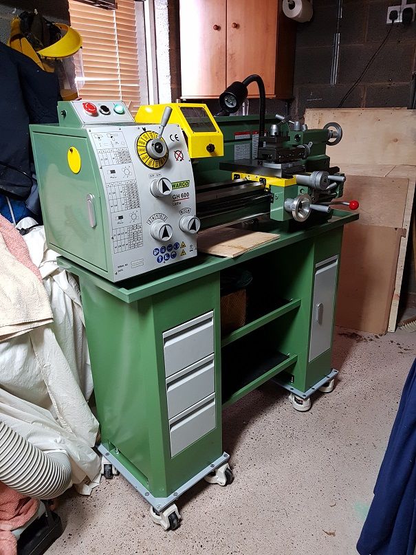

A bit of an update in the casters: The lathe is now in the final position with feet wound down.
I have adjusted the feet to remove twist using a cheap Engineer's level.
If I push the lathe backward, there is a very slight wobble on the rubber feet - probably to be expected.
It is very little movement, and the lathe appears to return to no twist when I stop pushing.
I will evaluate over the coming weeks if this has a noticeable effect in use.

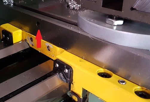

While you are counting your ball oilers, can you find the cross-slide lock?
Is it at the bottom of that hole on the left hand side of the cross slide?
I tried poking in one of the supplied allen keys and it didn't reach the bottom.
If it isn't there, where is it?

There's a cross-slide lock??? I found the compound lock, but I didn't realise there might be one for the cross-slide (stop laughing, it's my first lathe). If there is, the combination of a lock and power feed spells trouble...

I would hope there is a lock.
I think there are loads of opportunity for disaster. Wouldn't this be a similar risk to the lock on the carriage?
My guess: this is it, but it could be a backlash adjustment:
I would have expected it to be on the other side though.
I will investigate tomorrow, unless someone knows?

Just done some measuring . The blind hole shown is JUST above the level of the top of the dovetail so even if it went through and was tapped it would not lock anything. It would however act as a drain for any cutting fluid going into the left hand T slot since it opens out into it before going deeper in .

If I am not teaching Granny to suck eggs, the two tappings in the yellow paint of the front of the Saddle, are to take the travelling steady. On my BH600 lookalike, they are plugged with short M8 capscrews to stop swarf getting in, and causing problems when the steady is needed.

The arrow in Ian's picture refers to the hole in the Cross Slide not the two steady fastenings . Having had a good look at the set up this evening. Tthere is no provision for a cross slide lock.. It would need to be on the right hand side and exert pressure on the gibb strip. Easy enough to fit . although its would need to be only just proud of the surface if it was not to interfere with the allen key used to lock the carriage as is the case with the gibb adjusting screws on the WMV 280. The two T slots fixing the compound slide allow it to the positioned further to the rear allowing the cutting of tapers on the end of anything held in the chuck .

I will see how I do without a lock before I start drilling holes in my new toy.
As I am not anticipating any milling using the lathe, I expect I will be okay without a lock.
I need to get a couple of grub screws to plug those 2 holes.
You can see in my picture above that there is some swarf.
