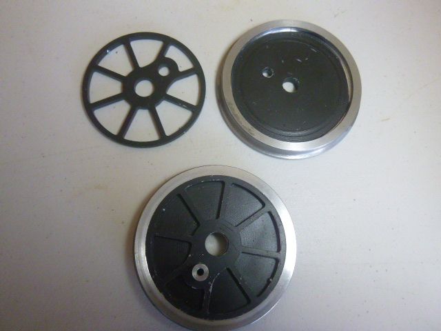

i am a member of the northern districts model engineering group in perth. myself and three other members are building ballaarats 3x 5 inch and 1x 71/4 inch . an article on this loco was in our local saturday west australain newspaper it does mention a south african who has built a ballaarat
we dont have the facilities to cast wheels with cast iron so we are going to try another way. we are going to get some discs of 125 round bar to the width of the wheel then machine a recess in them. then have some sheet metal laser cut to the shape of the spokes and silver solder them in to the recess

tom hardy14/02/2022 12:33:11
30 forum posts
1 photos
hi luker
news from the builders in west australia photo of wheels constructed by clive chapman. discs where cut from 1045 steel and recessed .spokes were cut from 4mm steel sheet by a laser cutter. the spokes are a neat fit and held in place with small grub screws . loctite would probably be ok

Luker14/02/2022 14:56:20
avatar
230 forum posts
172 photos
Hi Tom,
Those wheels look very good! Small grub screws will work perfectly; just don’t push the spider out when pressing the axels home. Some of the guys here build their wheels from laser like you have; then silver solder the lot up. Clive has forgotten the counter balance, it doesn’t add that much weight but is very period specific for these ‘ribbed-disk’ wheels. If you drill one or two blind holes and pour a little lead in there you’ll end up with better balanced wheels than mine.
