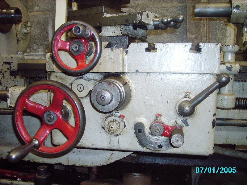

Phil Whitley13/09/2014 16:57:55
avatar
1533 forum posts
147 photos
Hi Chris, Cut a long story short I think the Covmac is emminently stripable! here are two pics showing inside the column and the legs
The red one is the headstock column, there are two studs and nuts but you will note 4 holes, the other two have not been drilled or tapped It is the same at the other end, (bit of a bad pic) but you can see two studs and nuts again, and two apparently unused holes.
If you remove all the belt covers and gear covers, motor, motor plate, then the banjo with the gears on it, you will see these two bolt heads
If you remove these two, and these two under the spindle
Then fit a chuck or faceplate and place a sling round and behind the chuck, and round and behind the vee belt pulley, and as far as I can see, the gearbox lifts off. You will need to make careful note of the number and position of any shims that may be in there (there may be none) If you then remove the nuts from the studs holding the legs on and remove the studs (they will probably come out with the nuts) you could lift the bed assembly with a fork truck, remove the legs, and lower the bed to the floor. As I said before if you remove the saddle you will first have to remove the lead screw and the feed shaft And without knowing how they disconnect from the feed/screwcutting gearbox, this process could be simple, or complex, I simply don't know! If you do remove them, you could then remove the saddle and apron, and the feed/screwcutting box as well, leaving you with some still very heavy, but much more manageable pieces to transport.
The top two levers, left hand one is the four speedchange lever, right hand is the back gear, or high/ low change giving eight speeds, four in low/backgear, and four in high. Sounds complex, but it isnt.
Tumbler reverse lever, this reverses the direction of the feed/screwcutting gearbox, and thus reverses the direction of the leadscrew for cutting left hand threads, and any other process needing the opposite rotation.At least, that is my take on this lever, some also have a neutral position so you can operate the lathe without the external gear train and the feed box turning, which make for a MUCH quieter lathe!!
saddle/apron controls, from the top. Small "ball" handle operates the top slide (AKA compound slide, which can be adjusted around an engraved protractor scale to turn tapers and for screwcutting. Small red handwheel operates the cross slide, which moves the compound slide and the toolpost across the bed. Large red handwheel moves the whole saddle along the bed. Round knurled knob in the centre of the apron switches the feeds between "sliding" (up and down the length of the bed) and "surfacing" which powers the cross slide backwards and forwards across the bed. Below that is an oil nipple (not grease!) The little red three position lever to the right selects the feed direction with a central neutral position, and the ball handle just above that opens and closes the half nuts for screw cutting. Bolted to the end of the apron on the extreme right next to the two T slots is the leadscrew indicator, sometimes called the screwcutting dial, which reads out the position of the saddle in relation to the threads on the lead screw. Once again, sounds more complex that it is in reality. The golden rule with all levers is do not change gear with the lathe chuck revolving!
The motor plate, solid cast iron one inch thick, and I can barely lift it!
The motor, and yes, that is a 12" rule! I can just about drag it across the floor, I would guess about 2 1/2 to 3 cwt.

Right, it has just lost the end of that post, as the cut command did not work so I will try to type it up again
Hope all this helps. I would strip it completely, it will make the move much simpler and safer, but you would still need help and a fork truck or engine crane, and if you are going to refurbish it, why not I would not go beyond giving the headstock and feed box a good wash out, as if you remove the spindle you will have to reset the bearings and that is a tricky job, but not impossible by any means. You will have to check the alignment when you refit the gearbox, but that should always be done after a machine is moved anyway. If I can give any more help let me know.
