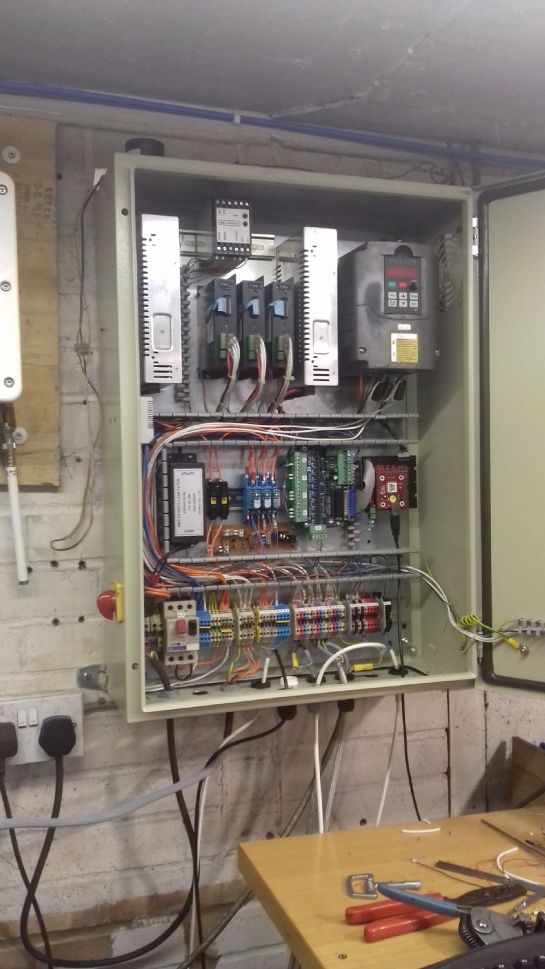

Andrew Binning18/06/2020 22:01:44
avatar
39 forum posts
9 photos
I know this is a very old thread but I have nearly finished the control system rebuild that I was planning when I wrote my original post on this topic. The Mill is still performing well and subsequent support from CNC4You.co.uk has been invaluable. Helpful advice given and a faulty part on the Drive Inverter was replaced for the cost of the postage!
The control system was built in an off the peg wall mounted housing which although it cost just over £100 ( sourced from RS components) 20200618_211339lr.jpg was worth the expense and time saved in making a cabinet.
Although the mill was originally bought as a hobby project, a commercial job came up which required the milling of a small cube of aluminium with bored holes on three faces to close tolerances. I have subsequently produced nearly 600 of these parts and the individual machining time was about 15 minutes each. This job alone paid for the original mill investment !
