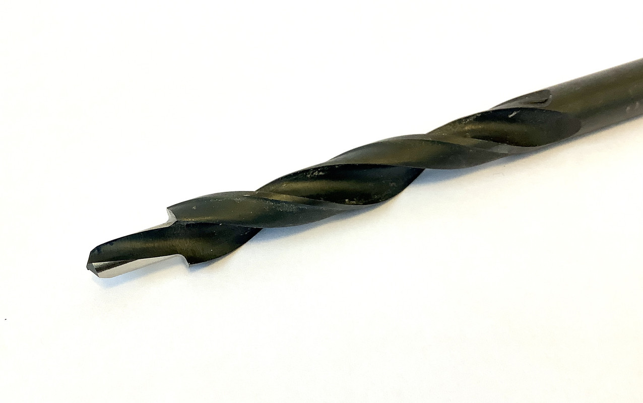

Vic25/02/2023 12:20:41
3453 forum posts
23 photos
I realised I hadn’t posted a picture. The job has been done and the drill bit works fine. This is my second attempt as I overshot the pilot at my first attempt. Luckily I had bought two spare bits - £1.10 each. I made a collar for the bit as a depth stop then drilled a hole in a piece of wood to act as a guide using my bench grinder. It didn’t take too long until I got near the target diameter for the pilot. I’d prefer something more exact but it’s done the job.
