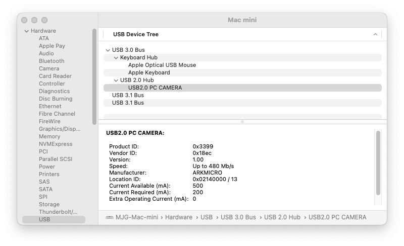

In easy stages:
The Mac mini has two ‘Thunderbolt’ ports [of no relevance to this discussion] and two ‘Type-A USB’ ports, which operate according to what is connected to them.
My keyboard and mouse are in one port and, for the following examples, the other port is used directly [i.e. without any external hub]
Here are the relevant panes when a common little UVC webcam is connected:
Chapter 2 to follow
