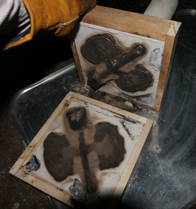

Here is another attempt at the brass plaques.
I may have used Naval Bronze for this one.
I was under the false impression that the sprue and riser had to extend up above the top of the cope, and have since learned that this is not necessary.
My runner/gate system was becoming more refined.
And I discovered commercial foundry sand named OK85, which is a fine dry sand.
I also discovered sodium silicate as a binder, and so the entire mold is bound with sodium silicate.
Results: The results of this attempt were fair, but not great.
I did not use a degasser, and these brass castings tended to have a lot of small gas bubbles in them.
Brass and bronze turned out to be far more difficult than I imagined, and I consider casting good brass/bronze parts much more difficult than casting gray iron.

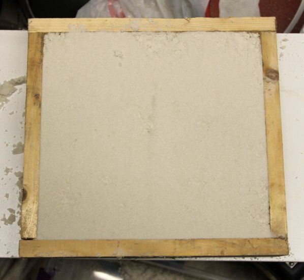

Using my standard "bull-in-a-china-shop" approach to learning metal casting, I continued onwards and upwards (downwards?).
I was introduced to resin-bound sand by the art-iron folks, and it looked very versatile, and worked well with iron, so I decided to try that.
I was not familiar with how to lay out patterns in flasks, and so I made one giant flask, with a very long runner.
This was yet another of many blunders.
I was able to use a few parts from this flask layout, but generally in every attempt, the metal froze before it went very far down the long runner.

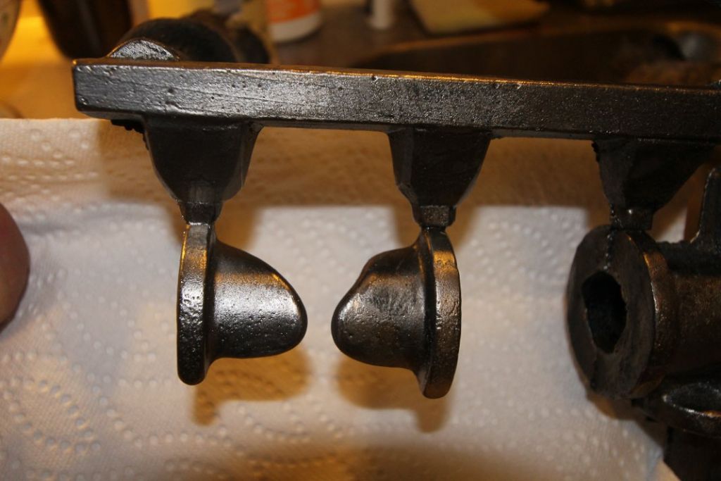

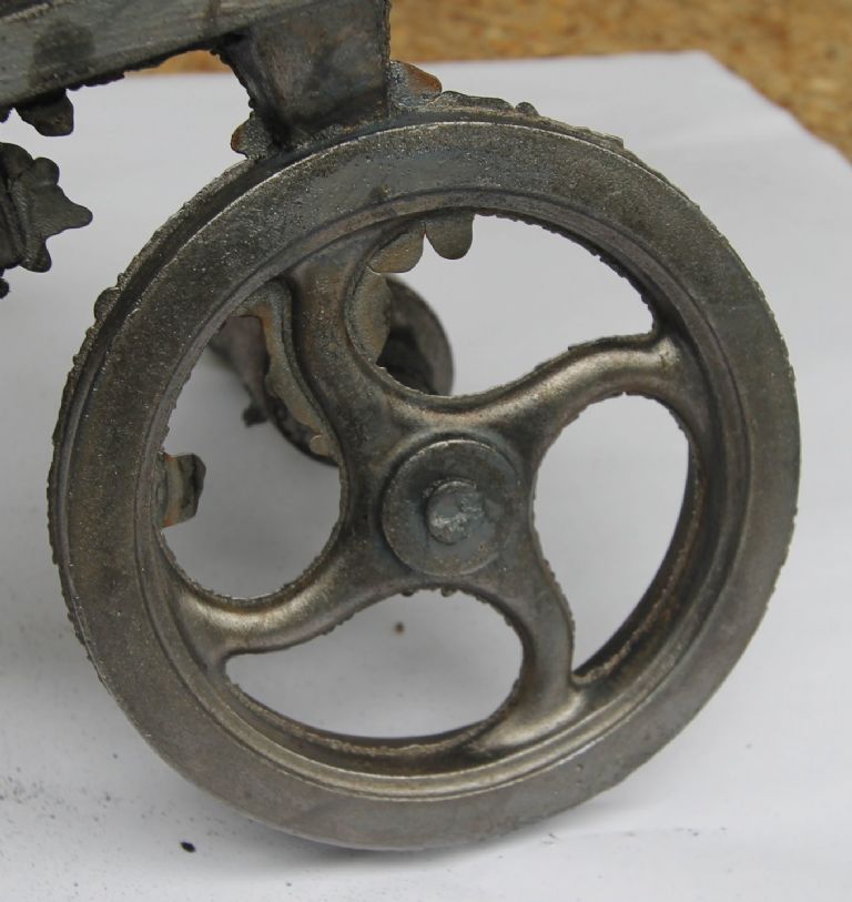

Here are the casting results from the above iron pour.
The flywheel casting turned out perfectly, but the remainder of the castings were dreadful, and unusable.
I discovered the alloy "nocutium", which is slang for thin gray iron without ferrosilicon added, that cannot be cut even with a carbide bit. It is basically gray iron that solidifies like tool steel before the graphite has time to disperse in the casting.
I took off all the teeth on a new Portaband saw blade trying to cut the chilled iron, and that was definitely a "what-the-flock" moment.
Any of these castings that were over about 3/4" thick did not need ferrosilicon for machinability, and any parts thinner than about 3/4" thick were un-machinable.

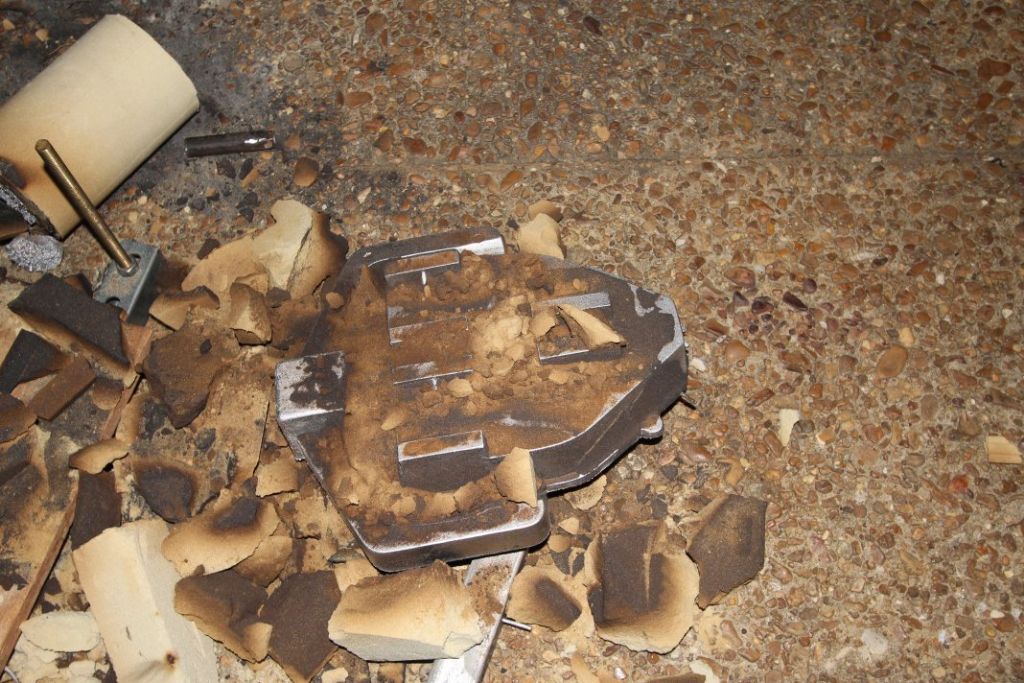

Here is round #2 with the same mold.
Resin molds will keep for perhaps 30 days or more if you keep them dry.
Result:
I dropped back to using aluminum, and the result was a very decent aluminum base casting.
There is a bit of flash on the nose of the casting, which was a result of the bound sand chipping off at that location when I pulled the pattern. This type of flash defect is not a problem, since you can just grind it off.
I used two runners, and two gates that were somewhat wide and thin.
This arrangement worked well.
The mold is down-filled, which is against one of John Campbell's 10 rules (no waterfall fills).
I think I used an upwards fill for later castings of this piece.
I used small holes in the high points of the cope mold, to vent off air that gets trapped in the mold.
Many will tell you vent holes are not necessary since the sand will absorb any air, but resin molds need vents since they really don't pass the air, and you will get a large trapped air bubble defect if you don't vent the high spots of the mold.

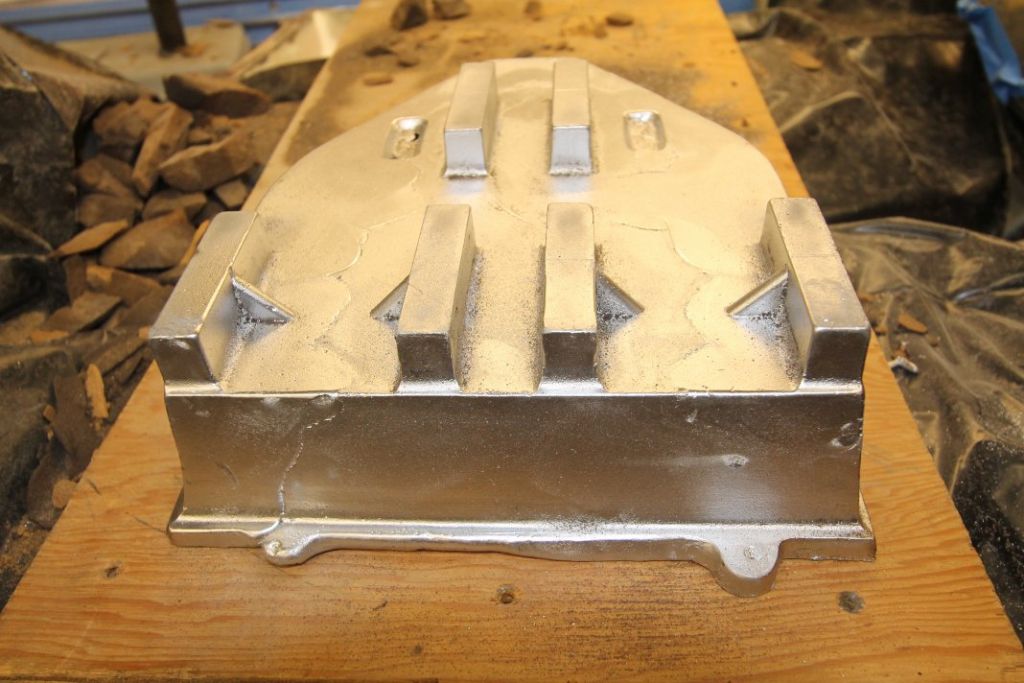

Another aluminum 356 green twin base casting.
Result:
Success but with a few air bubble defects caused by failing to vent the high points of the mold.

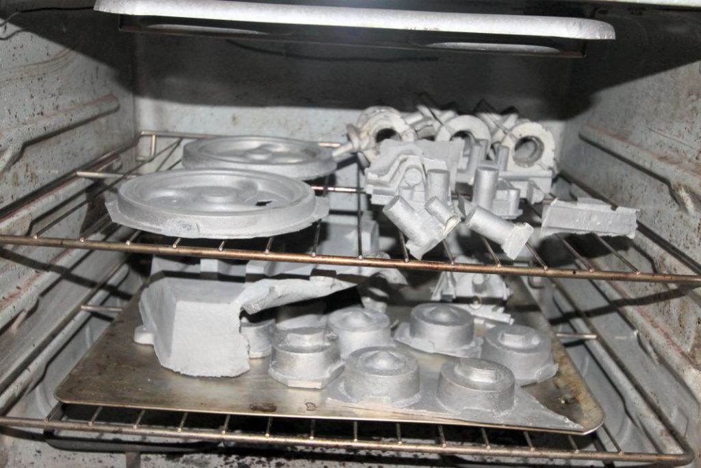

I got the wise idea I would temper the aluminum bases to an approximate T6 level, and so I bought a pottery kiln that did not have an automatic regulator on it.
I cracked the lid to maintain the internal temperature while the aluminum parts were being tempered, and the radiant heat from the elements melted the sides of my two green twin bases.
The remainder of the parts did survive the tempering process (which is close to the melting point of aluminum), and they were noticeably less gummy than untempered aluminum 356 castings.
Sort of a story of three steps forward, and two back, but I was learning with every mistake.
A T6 temper is a two-step process, with a higher temperature step, water quench, and then a lower temperature step.
Results:
I was pleased with the approximate T6 temper on aluminum 356.

I had quite a lot of salvaged Naval Bronze boat shaft, and so I decided to try and cast a pair of cylinders in this material.
Results:
Fail. I forgot to weight the top of the mold, and I thought the thin cement joint on the sides of the mold halves would hold things together. The mold split open, and the cope drained out.
I later found out that the stiction with this metal is so high that it would have had to have been sleeved or something.
I was beginning to wonder exactly how many different ways I would discover to make a failed casting.
I had gotten too far into this engine build to turn back now, so it was just a matter of weathering the storms, and hope for better luck as I learned the process.
I must admit things were looking a bit grim at this point.
