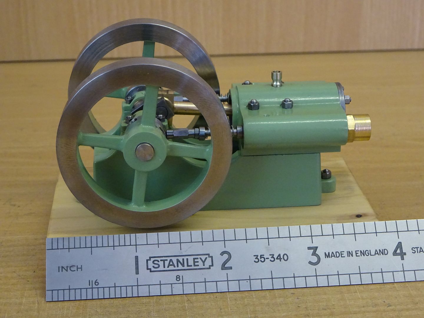

Well the old Advert said it was enamelled in red and green so I did not have much colour choice, I also opted for a black bed as per Michael's photo.
I'm quite pleased with how it turned out and considering the small flywheel and short conrod runs reasonably slowly. Also allowed my to do my first double acting piston valve as I had only done single acting before and first time with rod cross head guides.
A video of it running, the table it is sitting on makes it sound a bit loud but soon quietens when I pick it up, it stopped because I put my finger over one of the exhausts. Also looks like a bit too much endplay in the crankshaft so will move the flywheel along a bit.

Excellent, always amazes me how you find these subjects and more the point how you come up with a design and a set of working parts from just external views.
I thought that it came down to a reasonably low speed considering such a small flywheel.
Looks very nice also.

The problem is I keep dfinding designs quicker than I can make themblush For instance I really should make the Bassett-Lowke equivalent to keep this one companywink

Morning Jason, I see from the ad that the Bassett engine is quite small at 7/16" bore and only 3.5" to the top of the cylinder. If you do make it would you go with those sizes or scale it up, I think it would be quite impressive at such a small size.

Well assuming they are not including the handle on the steam valve then it's only 1/4" shorter than the Gamages which was quite small and fiddly. For example the drilled steam passages to either end of the cylinder were only 1.2mm dia.
I'll see haw it scales and maybe go for 12mm bore rather than 7/16" which would just make it a touch larger.

I watched the video again and realised how small the Gamages is when you picked it up. Out of interest is it the smallest stationary engine you have built or have you built anything smaller.?

I suppose it depend on what you are measuring, the Muncaster No 1 is a smaller bore at 12mm but the overall engine is a bit larger. The half size version of the Jowitt is also 12mm but looks bigger than the Gamage's engine as it's a chunkier shape.
