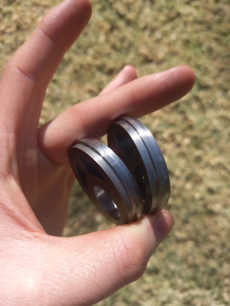

The valve glands on the steam chest as well as the piston side cylinder cover has some interesting detail...

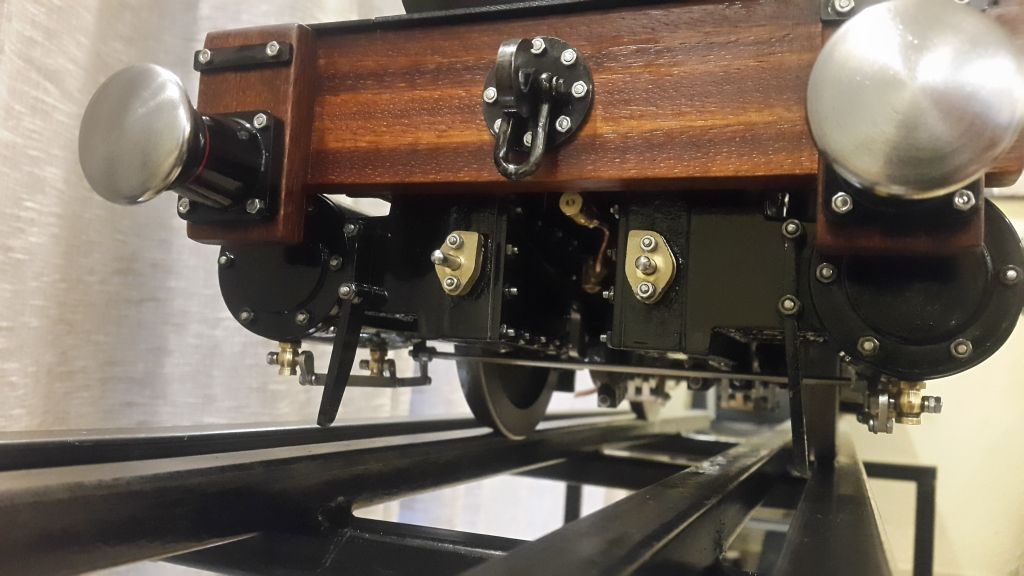

For everyone following the Ballaarat construction series here's a nice video showing the frames and linkage in motion.
