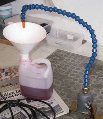

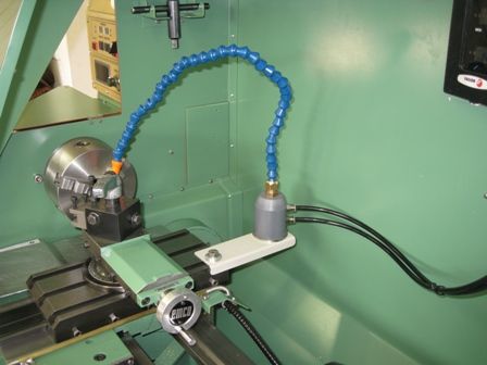

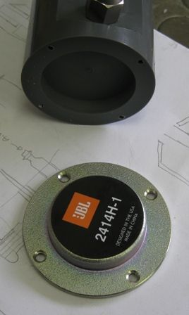

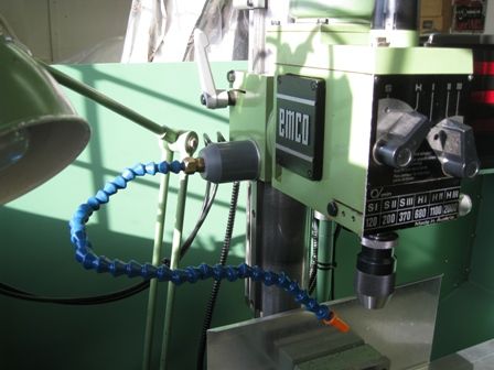

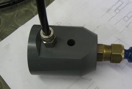

My flexi-nozzle uses the same interlocking flexi-tube as most the flood cooling systems do - The air supply flows inside that, and also within is a 4mm OD FESTO plastic tube that carries the oil to the nozzle. The base has two entries - one air and one coolant, from the mixer contraption. The base has a magnet undet and can be parked anywhere convenient..
Magnet under base - from a small loudspeaker...the groove around the circular magnet below is where the voice coil used to be..
Coolant inlet pipe fitted - 2nd hole is air inlet.
Joe

In the winter would this not be to invite condensation in our cold workshops and all that goes with it ? When using old speaker magnets I fill the gap where the voice coil was with resin to stop metal particles or swarf getting in. Very smart job ! Best wishes, Noel.
