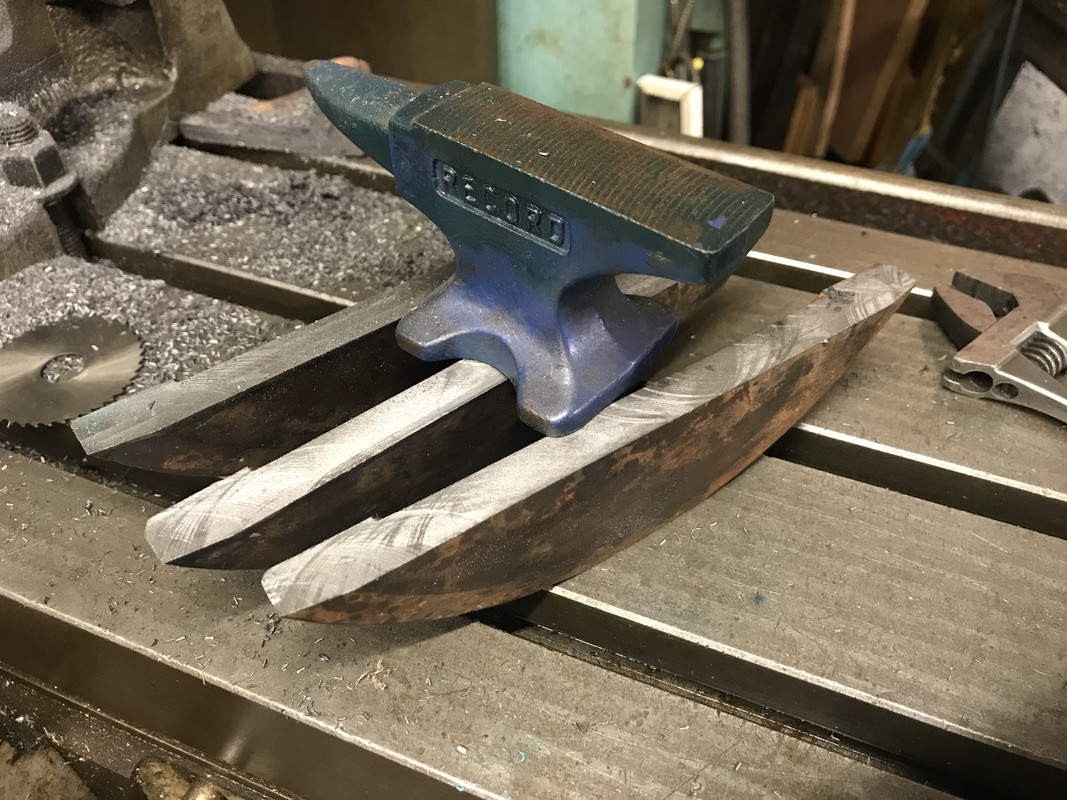

I also don't have a master square, so I thought I could make one using 3 import squares - matching each one to another in round robin.
To do that all I needed was a flat flat. Seems like a grinder would be a way to make one of those...
I have assorted scrap waiting to be turned into new things.
In the pile is an old clutch pressure plate - a reasonable lump of old cast iron.
I hacked it into 3 pieces:
Then used my mill to make them 'mostly' straight:
(anvil for scale )
I also made them roughly the same height, and cut a small flat on the curved edge.

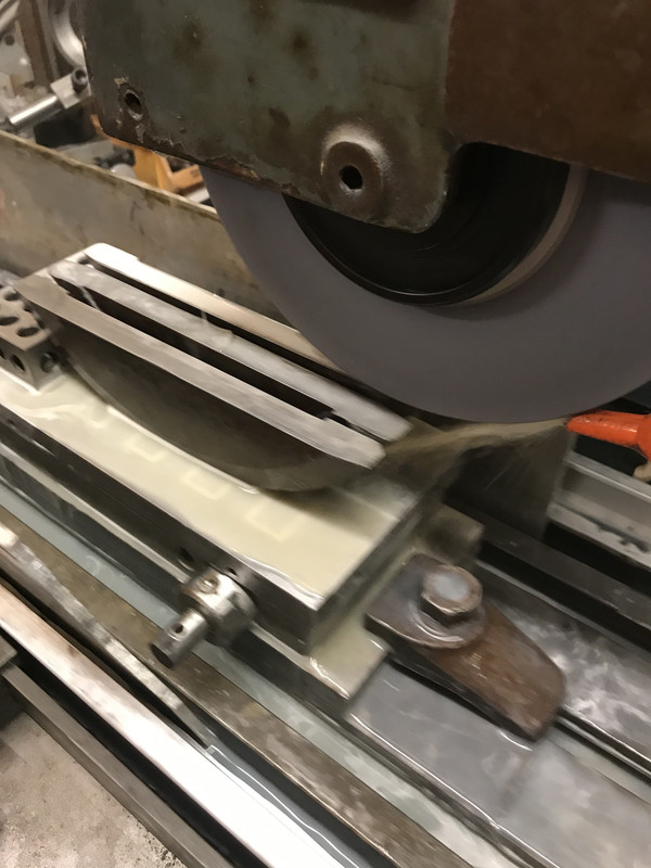

Then bunged them onto the grinder:
Taking care not to add heat I proceeded at around 3 thou DOC / 150 thou stepover. 46 K SG wheel.
Turned out nice:
And blackout flat:
All 3 match with no light, and blue against each other really evenly.
Think that shows my grinder doesn't have significant wear.
