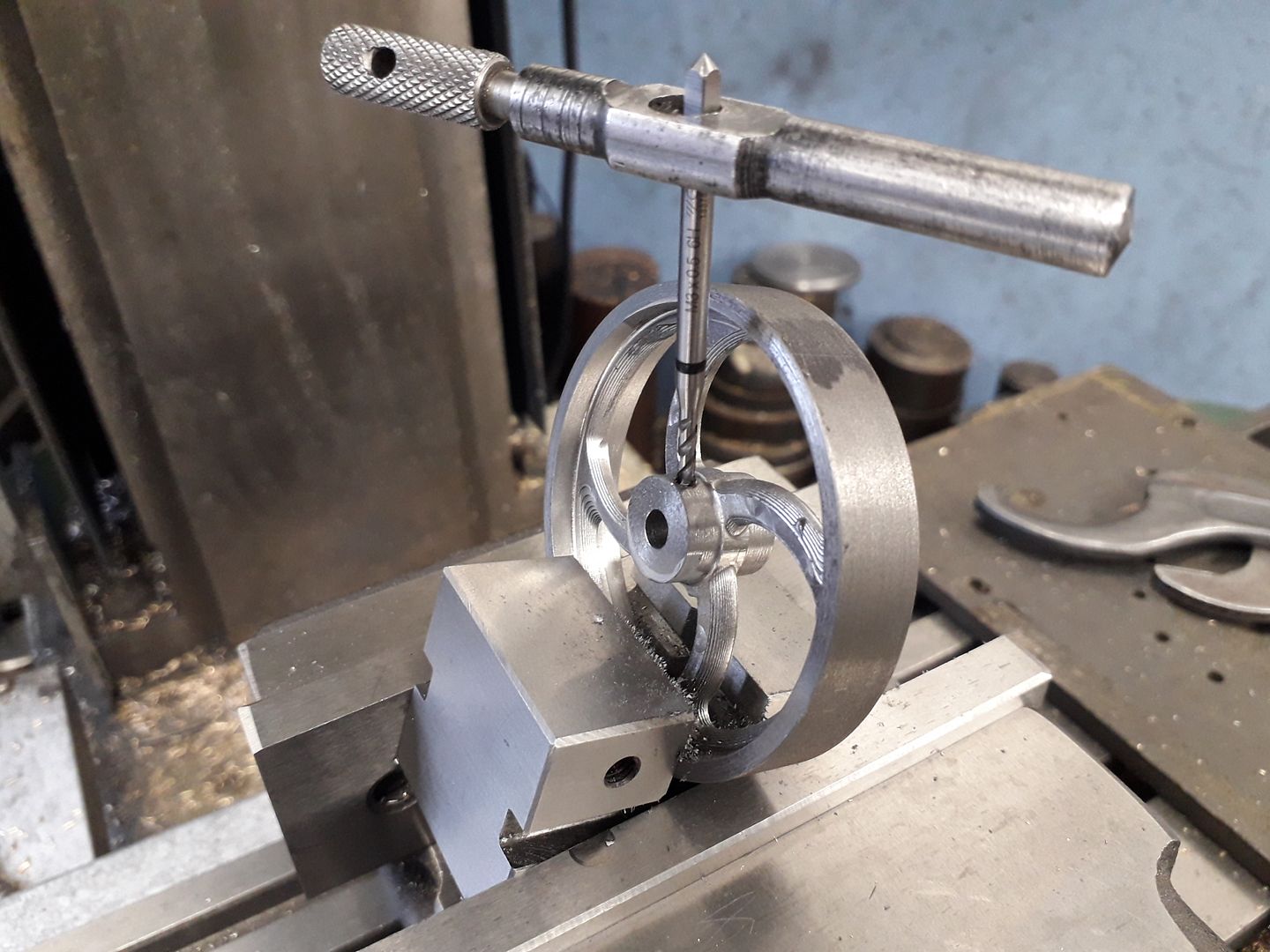

Flywheel
The final part needed is the flywheel, I decided to have a go at making mine on the CNC so turned a "blank from cast iron bar.
The contour lines left bar the cutter are more pronounced than they should have been, I thought I had ordered a 4mm dia cutter with 1mm radius corner but I had actually clicked on one with a 0.2mm radius which is almost just a flat ended cutter and did not look at it before using :-[ Just needed a bit more work with the Dremel to get it ready for paint.
https://www.youtube.com/watch?v=-yAOLGpnjCg
Once the milling was done the flywheel can be held at an angle to drill and tapped for an M3 grub screw.
I expect most won't be able to CNC a matching flywheel so have listed the Stuart Progress and Reeves Nicholas flywheels as suitable alternatives for those wanting a cast flywheel, or one could simply be turned from a slice of 62.5mm bar with a recess cut into each face and say 6 equally spaced holes drilled in the resulting web.
