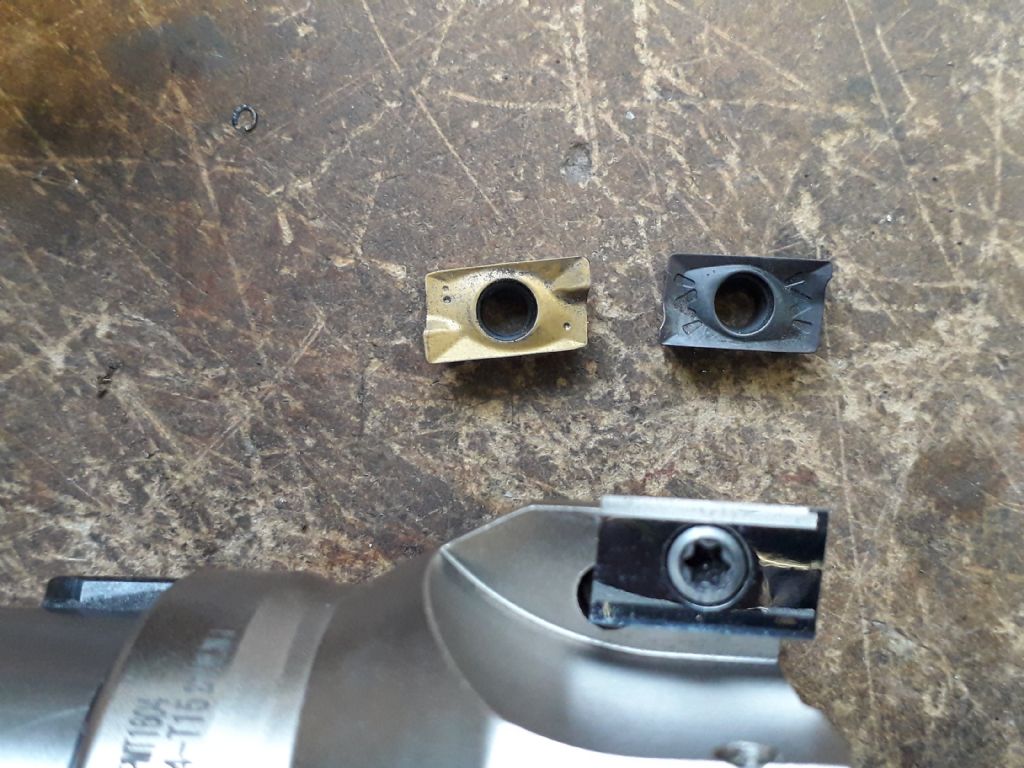

Funny enough having seen your earlier post this morning I tried some inserts by both YG-1 and Korloy via Cutwell and they fitted OK, possibly taking a little more pressure on the screw to seat then down into the pocket but no visible sign of any gaps. I've only got 4 of each type so not easy to try in the 63 and 80mm heads but could try three in the 80mm to see if they cut OK.
Those 4 letters may describe shape of insert for a particular metal (angles, chipbreaker etc), the bright Aluminium one in the head from YG-1 is PDFR as are the ones from ARC. The grey Korloy is PDTR and a different shaped cutting edge to the ARC PDER

I have just compared the PDER and PDFR inserts I have with the 25mm end mill (both from ARC) and the front face (cutting edge) to rear face (seat) dimension is greater by 0.52mm on the PDER. The sides and ends of the inserts taper inwards down to the rear face where they must be the same dimensionally as they both fit the pocket perfectly. With the inserts having a different thickness and the same tapered sides the length and width dimensions at the front face differ, the PDER being thicker having the larger dimensions.
Well thats how I see it.

Well spotted that man, there are also other differences such as the length of the lower cutting face as arrowed and the Korloy ones certainly come with different angles too

Ha ha, you are not the only one Andrew. I was put off buying for two to three years!... It has been difficult to find a reliable and consistent source... especially for the inserts. Add to this, every manufacturer of shell mill wants you to buy inserts only from them for their holders... as explained before. I have gone through this several times, even with Sumitomo. To get a shell mill from them costs a small fortune... although it is high end CNC production stuff.
On our website, the dimensions given for the APMT and APKT inserts relate to the cutting edges, not the back of the insert (or pocket size).
Any variation in the geometry of the insert, i.e. relief angles, chip-breakers etc., as you would expect from inserts designed to cut different materials, would result in different dimensions. Still, all classed as ISO generic.
PDER – PDFR (ISO codes):
P = 90°
D = 15°
E = Rounded
F = Sharp
R = Right hand feed direction
The thickness can and will be different as you can see in this picture:

Ron... agreed.... and that difference in thickness is also shown on our site, and it is as provided by the manufacturer we use. thank you. Hope it also comes across in the pictures shown above.

I'm not worried about variations in thickness, but inconsistencies in length/width do worry me. It's good to know that the inserts fit anyway. Looking at professional tool suppliers the insert side angle seems to be 11°, although I don't think that's set in stone.
I looked up the coding for inserts. The PDER and PDFR decode as follows, basically in accordance with what has been previously posted::
P - cutting edges are at 90°
D - Wiper relief angle is 15°
E/F - Cutting edge condition, E is rounded, F is sharp
R - Cutting direction, right
Man, this stuff is complicated. I'm concerned because I got done on the 80mm face mill I've previously alluded to. It was very expensive but the range is now obsolete, as are the inserts. I've been buying up inserts on Ebay. I've got about 50 now, and with 4 edges per insert that should see me out.
The Arc part number misses out the corner radius, although that's not an issue as they only supply one value.
