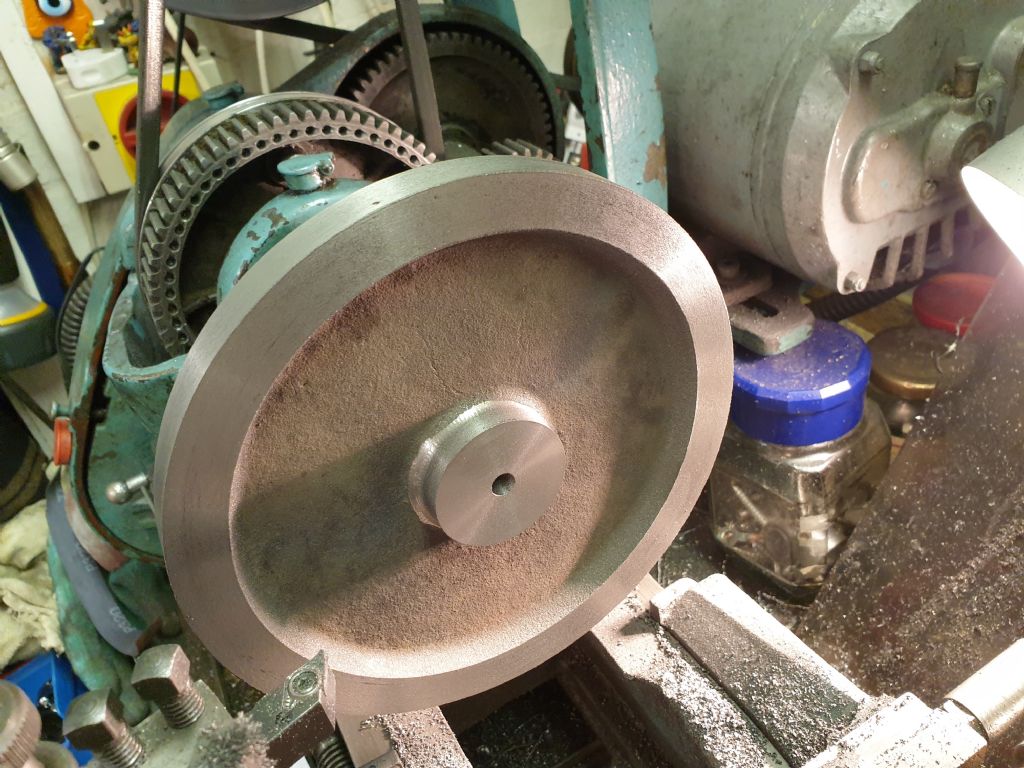

Martin Rock-Evans27/08/2020 15:06:58
28 forum posts
17 photos
Stephen, I'm not sure if this will help now as it's been best part of a month, but when I made the gears, I pretty much just followed the drawings. There's plenty of space for the large boss (you can just about make it out in the photos below).
The only thing I remember not being quite right on the drawings was that the dimension for the shoulder on the small gear didn't match up with the bore of the large gear, so I just ensured that they matched so that when the larger gear was bolted to the smaller one, it would fit on the shoulder and ensure that the gears are concentric.
