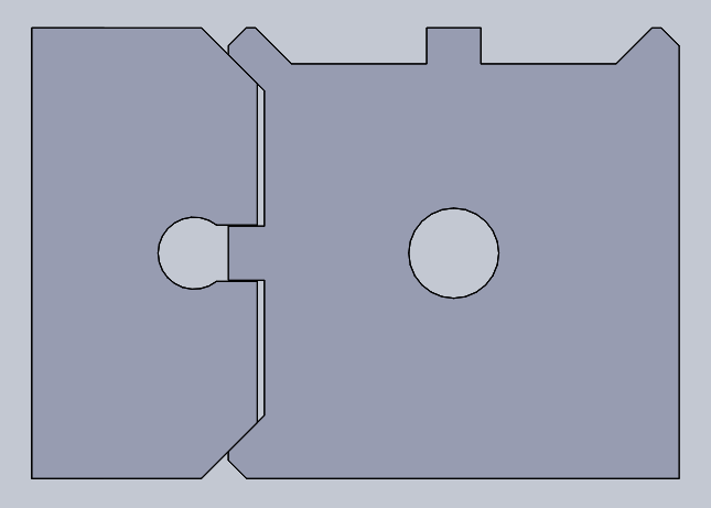

Sorry, nope! End up with a narrow guide system which is less rigid. Harder to machine too as its a Vee - flat system like a conventional lathe bed. Vee - flat system constraints are horrible if you want secure, accurate interchangeably. Four precision constraints on each part, all struck off a master plane. There is a reason why lathe beds and saddles have, historically, always been scraped to fit as pairs. SouthBend, past masters of inexpensive precision knew exactly what they were doing in using twin Vees on their beds.
If you want a single Vee then the other side needs to be flat against a part spherical curve. Not nice in that sort of job for many reasons.
The whole point of the Dickson system is that, in principle, it requires only that the Vees be parallel and the overall layout geometrically sensible.
Clive.
How does removing one of the four surfaces make it harder to machine or less likely to align?
The Dickson system doesn't just require the vees to be parallel (reasonably easy) but exactly the same depth and exactly the same distance apart (rather more challenging).

Also here is how I am leaning in terms of geometry
The tool holders, of which way more are made compared to tool posts are just 1 drilling and 3 milling ops. 1 milling op if I used gang tooling. I'm stealing Harold Halls tool post design for the clamp.
Any recommendations on tool steel for the retaining piston, cam and maybe the toolpost?
Probably the tool post will end up as mild steel, HH used EN1A for all parts I think, but I am curious as to what a more industrial grade post would use. I could for see a hardened cam and piston might be worthwhile even in a hobby environment though.

Your geometry will be good being effectively that of a Webster Whitcombe lathe bed. Need to work hard to keep everything parallel and the angles right for decently wide contact areas. Best to make all the holders you will ever need at one setting as the geometry is a lot less tolerant than a Dickson. Nice job for horizontal milling machine if you can get cutters with matched angles.
EN1A is a leaded free machining steel. Lovely finish but a bit weak and a bit soft for tooling. Our American friends would probably go for SAE 4140 pre hard which, I understand is pretty decent stuff and still machines well. Gawd knows what you'd get over here if you wanted some. EN19 / 709M40 / 708M40 are supposed to be close equivalents to plain 4140 and EN16 / 605M36 is similar. Have around 150 mm ruling section in R range hardness which should be adequate. Trouble is finding good material in small quantities. I've had some right dross which was very difficult to machine. Rather than harden I'd try and find EN19, EN16 or equivalent in T range. Rulling section about 65 mm which should be more than adequate. I don't trust EN24, 817M40, SAE 4340 even though it can be found in V range at useful sizes.
