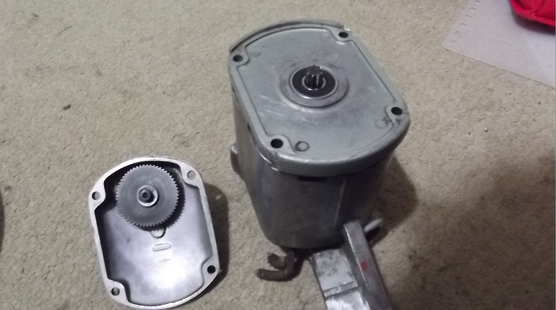

So in past news I got the bearing in a vice, heard a crack and a second later the outer race and ball bearings went ping and are now in a distant land. Some dremel cutting disks are on order.

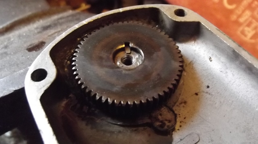

Currently I'm trying to get the big gear off so I can get to a and replace the frontmost bearing. Trying to lever it off with a screwdriver has failed despite soaking in penetrative oil and blasting the gear with heat (though not enough to draw the temper). Not sure how to proceed now.

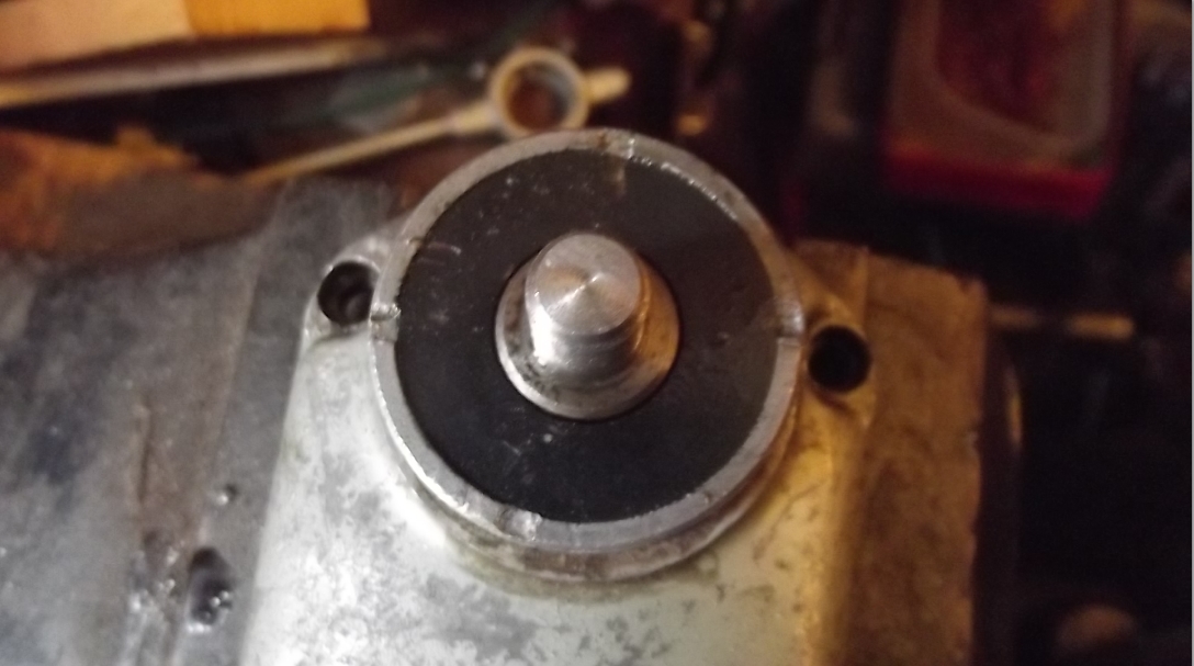

Did you get the chuck off? If so, can we have a photo of the big gear's shaft where the chuck was, and the bearing behind it? If the bearing is exposed I would make a support collar to stand the front drill assy on with big gear upward. I would then push the shaft through the gear, through the front bearing and then out, with an arbour press or hydraulic press.
Bear in mind I have not disassembled your particular drill, so I don't know if there are troubles with this approach like hidden pressed in cross-pins, or two front bearings (or bronze bushings), the inner one bigger than the outer one, etc. Take a very close look at the bearing sizes inside vs outside if it looks like there are two bearings in the housing. I have used the press approach on the bull gear shafts of many types of old US made drills though, without wrecking anything. If there are two bearings, and the outer one is larger than the inner one next to the gear, be sure to support the drill housing outside the OD, as well as at the shaft, otherwise you could break out part of the housing as you press out shaft and maybe front bearings go with it.
Go easy and look at everything in good light before trying the rough stuff. A works diagram would be ideal of one exists. Look on the web - there's a shocking amount of literature about for even very old tools.
Good luck, JD

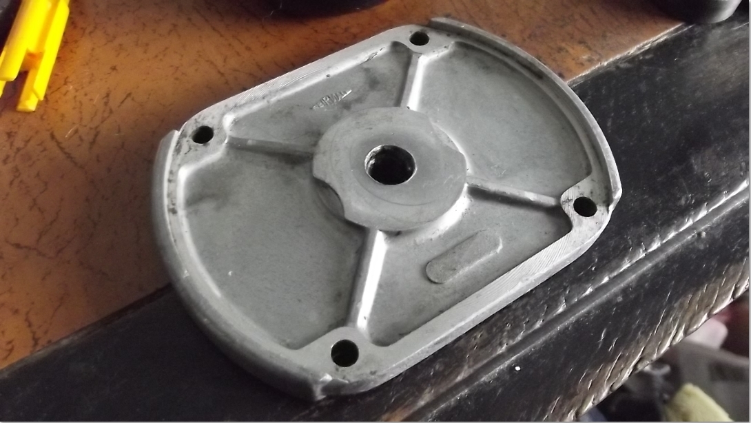

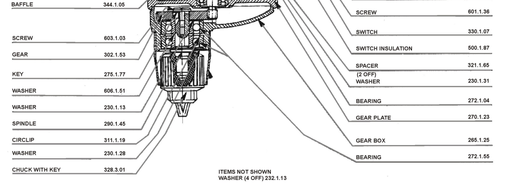

Ok heres the diagram. Two bearings with a circlip inbetween them. The gear appears to be pressed on with a key so atleast there isn't anything suprising there. Maybe instead of all this faff I should go and buy a new one from Ralliwold for £35?
Also piccies of the real thing

Are the front bearings feeling gritty or binding, of do they have a lot of play? If not, I'd consider leaving them alone. If they do have these problems, see below.
Looks to me if you remove the black washer (that would be under the chuck normally) you should be able to see the bearing. If you support the bearing on the outer race or both races in a press, and push on the gear end of the shaft, it should push through the bearing and leave the key and gear behind.
Don't be tempted to hammer the shaft, gentle press force with a pushrod with dia close to the shaft diameter is the way to go on this sort of thing.
Do be sure the bearing is supported underneath, again with a close fitting spacer ring or socket to support the outer race or both races.
After the shaft is out you could try a motorcycle clutch puller to get either the inner or outer bearing out of the aluminum housing, but I'd try warming the assy to 160 - 200 deg C first and see if the bearings will fall out or can be gently hand pushed/pulled out each side. Then you can either leave the circlip and washer between bearings in place or remove them if you need to. Good luck JD

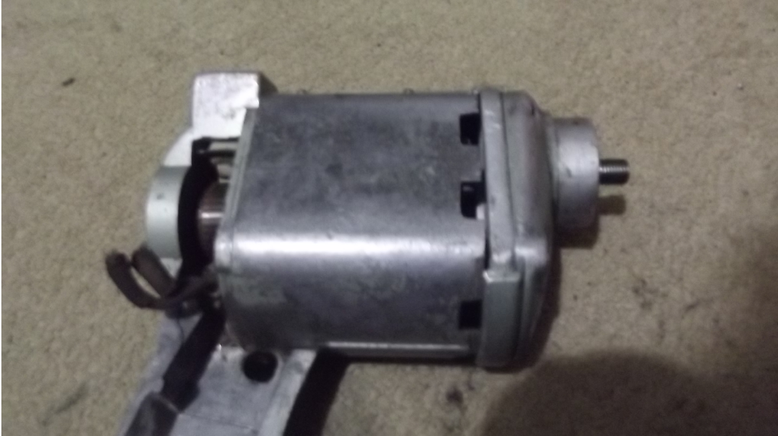

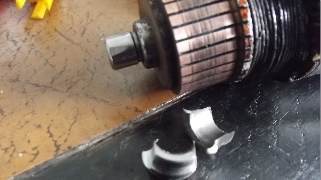

If you can't pull the bearing off then I'd cut through the outer race as Neil suggests then very carefully grind 2 flats on opposite sides of the inner race, As it gets near the shaft the very thin bit will start to blue from the heat, you then go even more carefully, eventually the inner race will come off. Two very small flats (and they will be small if you've been careful) will not matter. As someone above mentioned protect the rest of the shaft from grinding dust, I usually use duct tape wrapped on.

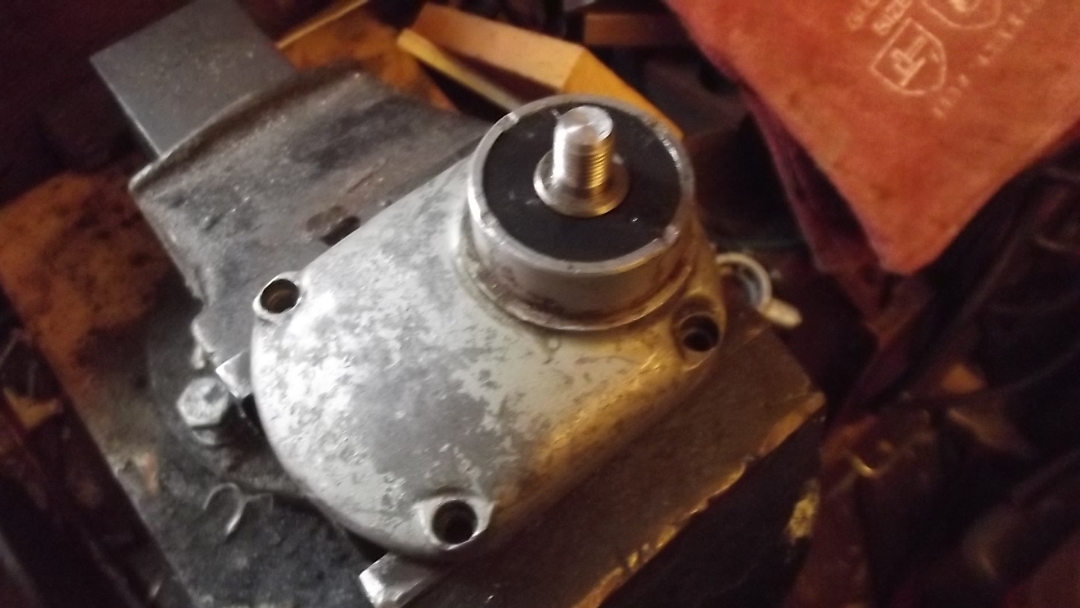

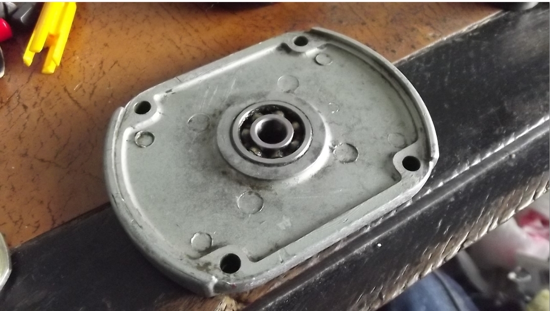

Re: Motor bearing
Used bench grinder to cut flats into the bearing (as duncan mentioned). I felt it was a much better idea to do it this way instead of a thin dremel disk as I was going to, much less chance of nicking the commutator ring. First time I got a bit of a flat on the spindle, second time it went a lot better. Didn't cut all the way thorugh the bearing axially incase I hit the commutator but I gripped the weakend bearing loosely in the vice and twisted it out.
Which leaves only one mechanical component to replace.
Not immediately sure how to push this one out. Bearing is proper knackered so I can't screw it up any further though. I can sort of wiggle a screwdriver through the backhole so could use that to strike it out. Whether or not the inner would seperate from the outer is unknown.
Bearing currently soaking in penetrative oil, if no one has a better idea I'm gonna gently heat the aluminium housing to expand it then try and punch the bearing out (only worry I have is shooting the inner race out and leaving the outer body stuck).

Project was shelved for a bit due to other more important work but got back to it this afternoon. FAG 608-2RS bearings fitted without issue.

I'd try warming the alloy housing up to say 200 deg C with a heat gun, before pounding on anything. The bearing may drop out on its' own or may need a very light push after heating the alloy. The expansion of the alloy will be much greater than that of the steel bearing.

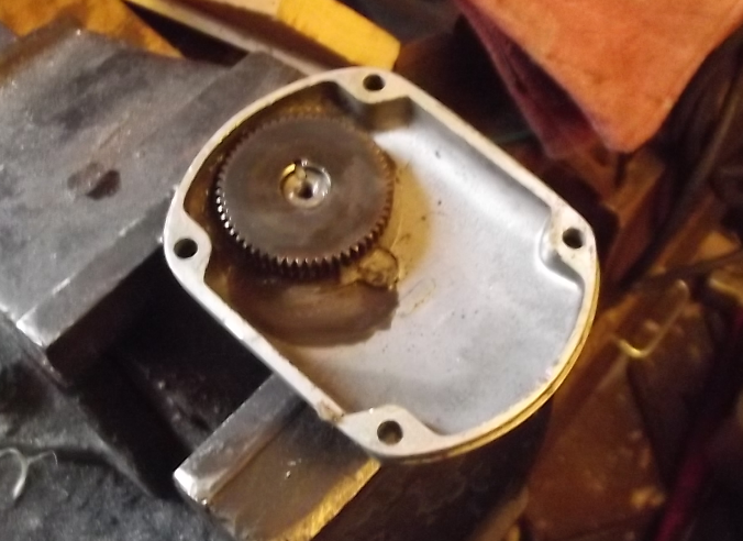

Oh yeah bearing went great. Didn't have a heat gun so gently hit it with a propane blwotorch. Only needed a poke to make it come out. Putting the new one in went pretty easily too. Heated it again and used a plank to get it the last bit in. I meant about greasing the gears though, two spur gears in an aluminium housing (I can see how you could mix the messages, woops :P).
As far as I can tell the best think for gears is oil but while the two shafts are now sealed the casing is just two casting held together by screws so I don't imagine thats a great seal.

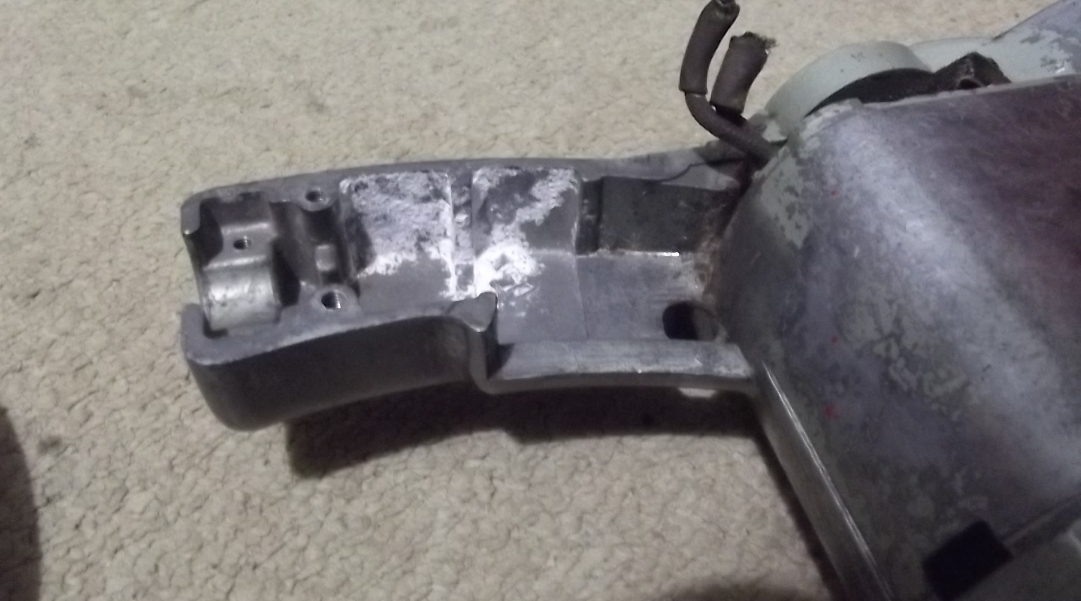

Also last thing, anyone recognise tihs white weirdness? Its kind off like a hard powder stuck to the casing. It was next to the switch. Hope the switch didn't blow up.

Looks like heat conducting paste that has dried out. Does the switch have any electronics in it?

There was this grey card between the switch and outer casing, probably to stop the contacts touching the aluminium body. As far as I can tell the switch is all mechanical. Maybe its some sort of perished glue.
Nicholas Farr26/06/2016 15:58:57
avatar
3988 forum posts
1799 photos
Hi Rainbows, your white weirdness is most likely caused by moisture trapped between the card and the casting, it's not unusual on die cast.

Assuming the casing is a tin/zinc alloy pressure casting not aluminium (which is likely) en.wikipedia.org/wiki/Wet_storage_stain
Rainbows27/06/2016 11:42:54
658 forum posts
236 photos
White rust sounds right. I got a Moore & Wright bearing scraper at a carboot yesterday which was pretty useful for picking out the white stuff. There isn't any sort of pitting underneath so its all good.
