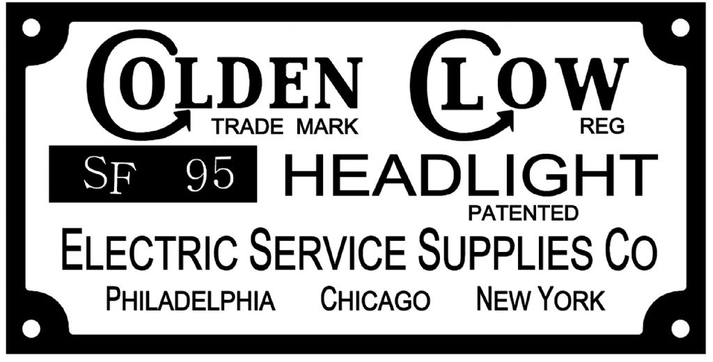

This is an image created from the CAD model, the lamp plates are roughly 14 x 7mm. The black parts are raised with respect to the white parts. The model number was stamped on the prototype.
headlamp plate

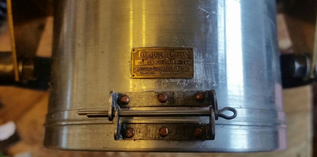

Aforementioned Lamp ID plates finally fixed to the lamp bodies. The rivets are 0.5mm AF hex on a 0.3mm shank.

OldMetaller27/01/2017 07:06:27
avatar
208 forum posts
25 photos
That is amazing work Steve, well done!
