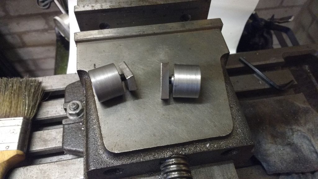

As a Post Script, here are the table stops I made. Decided to add a short spigot to engage with the outside of the dovetail slot to keep them central...

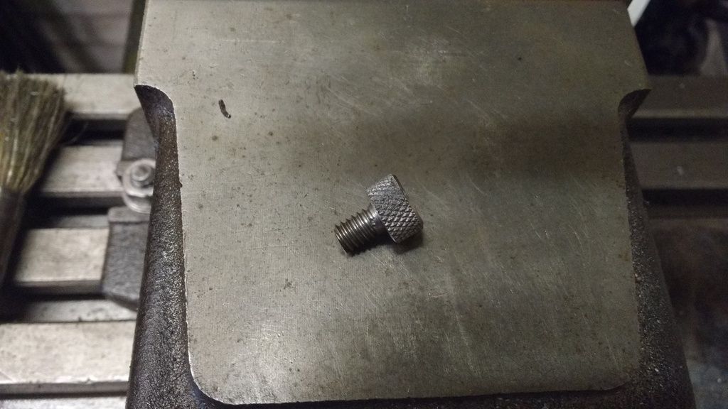

I also needed a replacement thumb-screw for the Y-axis scale...
So far my cheapy v-belts seem just fine but the size in the manual is wrong and the shorter one does appear to need to be an A30 rather than A31. Many thanks to Simon for his help with the belts and the stops.

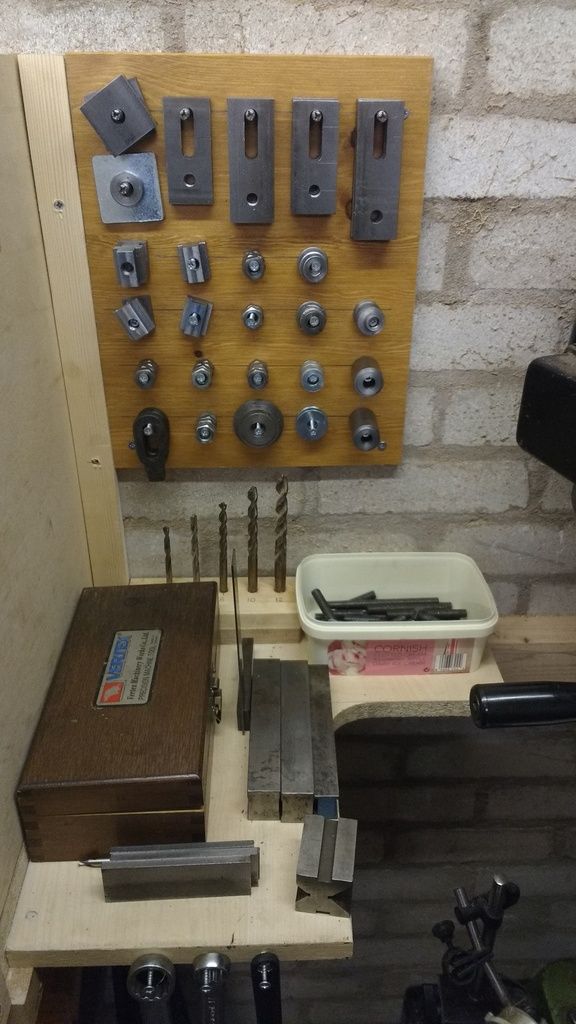

As a primer I bought Harold Hall's Workshop Practice books on milling and made myself a set of clamps along with a rack...
I suspect it won't stay that tidy for long wink

Nice looking parts you've made there Jon. I've got a similar box of bits containing a few shop bought components amongst my home made bits. None of the commercial tee nuts I've collected fit as well as the ones I've made but they come in handy as packing sometimes!
Jon Gibbs15/02/2016 11:19:37
750 forum posts
Vic,
Thanks
I must admit that one motive for making, over buying, was that the commercial clamp sets for the T-nut size I have on the table (i.e 14mm) take M12 studding which seems a bit OTT to me and also meant that the M10 studding I inherited with the mill was scrap. So my bits are all sized for M10.
