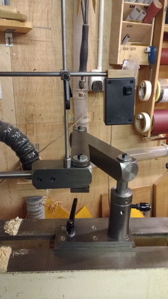

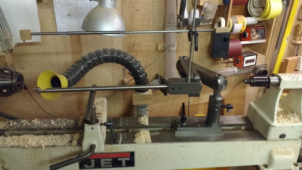

Jon Gibbs18/08/2015 19:53:02
750 forum posts
Well, here's the postscript. Finally managed to finish assembling the hollowing rig and here it is...
...and here's a close-up of the articulated section with the taper roller bearings....
I haven't had time to test it on some real hollowing yet which'll have to wait until I get back from a business trip but I'm pretty chuffed how it turned out.
Thanks for the guidance to get the boring done properly!
(Apologies for the clutter in the background).
Jon
